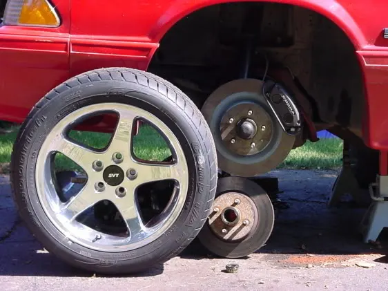

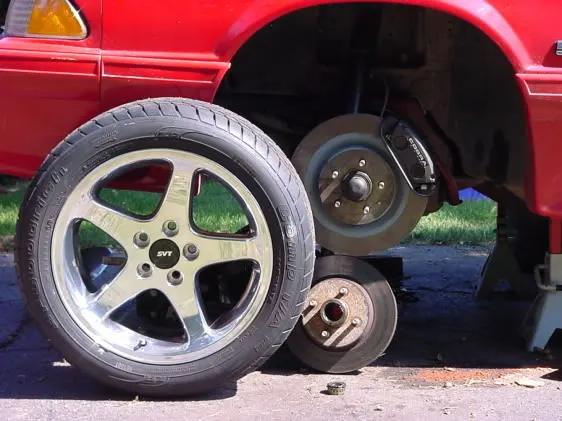

FINALLY got my 5-lug conversion finished... now that it's all said and done I can clearly see that first thing next spring I'll be installing some lowering springs (yikes).
Heres some pics:

how hard is it to change the rear to 5 lug?
The rear is a piece of cake. All you have to do is remove the brake drums, open up the differential, remove one bolt and 2 C-Clips, then the axles slide right out... Slide the new ones in and reverse the process, fill with fluid, and you're done. Could easily be done in under an hour.
91ghp5.0 said:
seriously...what calipers and rotors? those suckers are CLEAN!
The rotors are 11" Ford Racing, and the calipers are just stock 94/95 66mm single piston dealys... They were really rusty beforehand but I put a lot of elbow grease into them and followed it up with a shot of some high-temp paints. Sad thing is one of the calipers already needs a bit of a touch up since some brake fluid spilled onto it when bleeding and now the paint is bubbling a bit. Thanks for the comment tho! Look a lot nicer than they really are. lol
