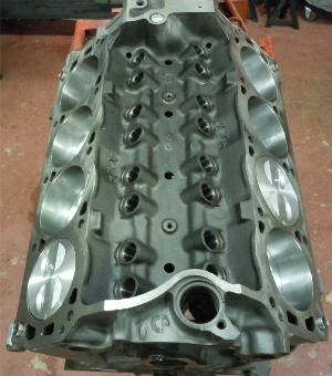

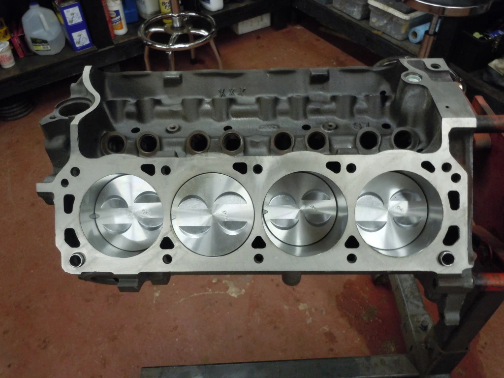

Here are some photos

94gt5.o said:
Oh and do our cars use pedestal mount or stud mount roller rockers may be a stupid question lol
Shortblock looks sweet...

lol Im pretty sure its acully a 308 bored 40 over and ya its a killer deal for what you get. I painted the block to day and i got sum pics
