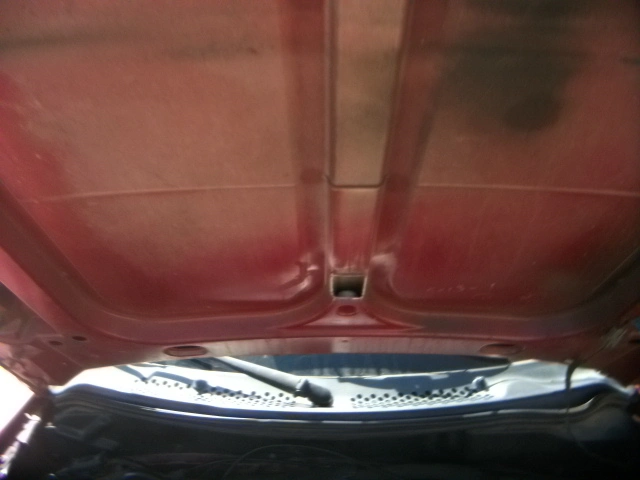

Any chance you could shoot some pics of the notching you had to do? Seriously considering the Kenne Bell install, but would be a lot more inclined to do so if I don't have to add a new hood to the parts list.
Thanks!
I'll try to get a picture tommorow....not even sure it was neccesary, might have been for the flowzilla manifold (mine is standard). Just a little notch out of the center rib, 2 minutes with a dremel and a cutoff wheel.....and the underhood liner is gone also...... I'll look at the KB install instructions as well, and quote it for you....
Husky..here you go...little notch, no big deal. Hood liner is gone to, don't remember if that was KB related or I just got rid of it
