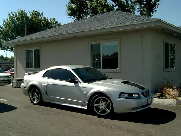

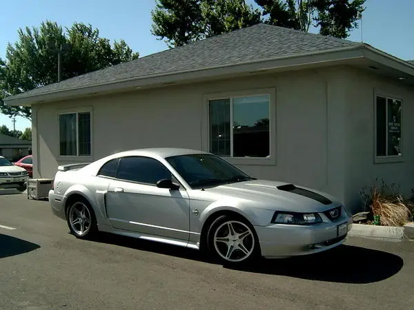

I threw some pics up at work on my photobucket site. You can see them here.
