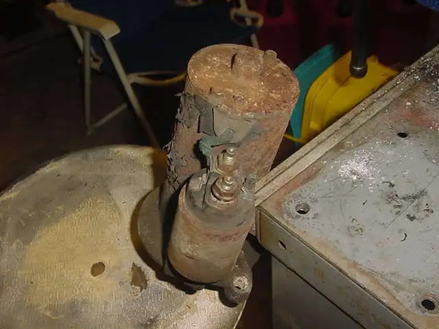

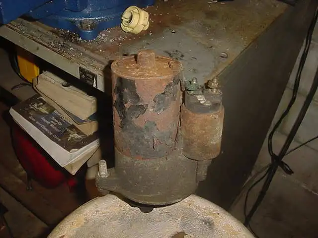

New sn95 style on the left, Fox on the right:
New sn95 style hookup on an FRPP mini starter:
Fox starter:
SN95 style starter:

Just so there is no confusion. The mini starter still needs the fender mounted solenoid. That is the starter drive you're seeing on the side of the starter. The older style starters had the starter drive in that bump on the side of the starter.
The FRPP and SN-95 starter is a totally different starter and is wired up differently.

Here's the 92/93 starter...
Okay, I hate not knowing so I went and looked it up. Either starter is correct starting in 1991. I was wrong. My starter is the "SN-95" style starter which, as it turns out, is a late Fox style starter since it first appeared on them starting in 1991.
