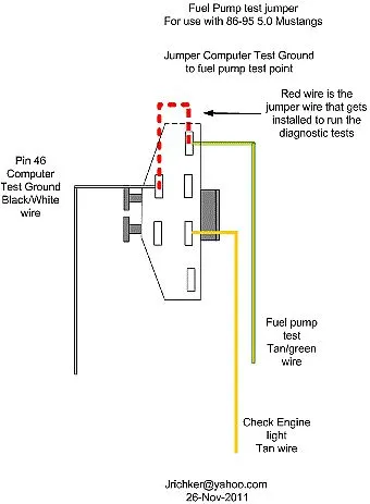

Clue – listen for the fuel pump to prime when you first turn the ignition switch on. It should run for 2-4 seconds and shut off. To trick the fuel pump into running, find the EEC test connector and jump the connector in the Upper RH corner to ground. The EEC connector is near the wiper motor and LH hood hinge.

As shown above, you can jump a wire out to test the pump and run it continuous. Other reason for continuous fuel pump running is ECU issues. It's possible to damage the ECU if you put voltage on pin 46 of a manual trans ECU. Turn key to on and check for voltage from pin 46 to ground. Shoyld be 0 volts
