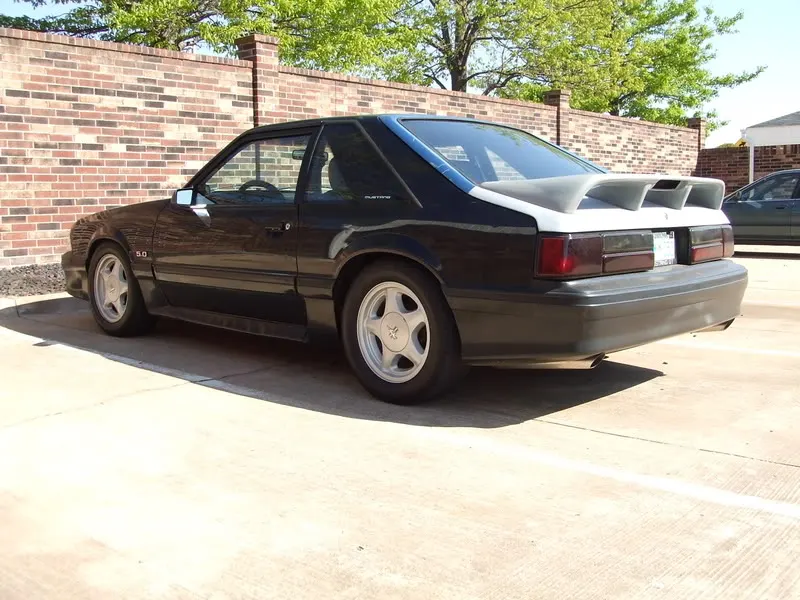

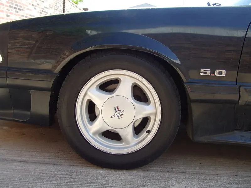

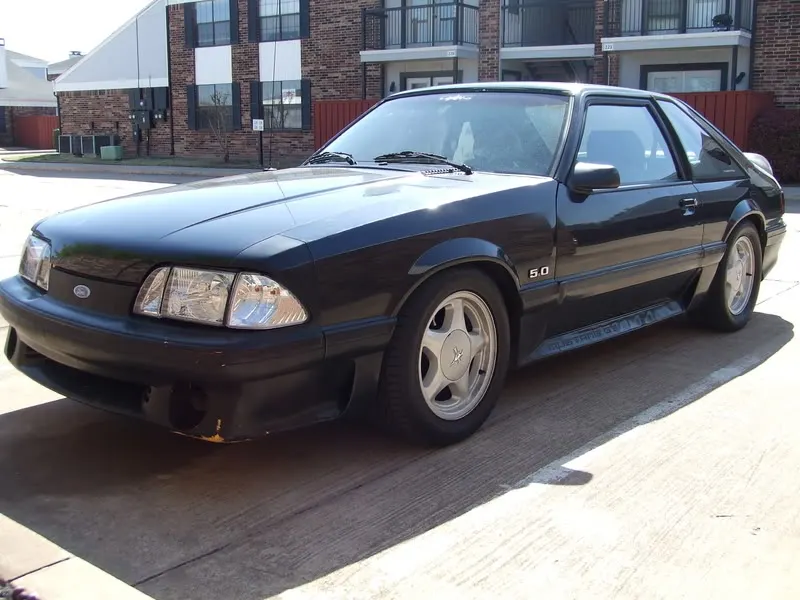

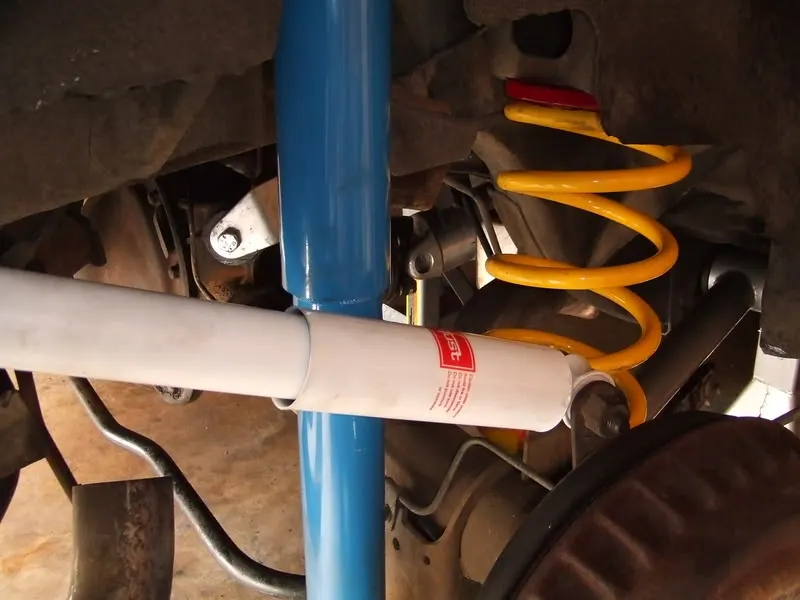

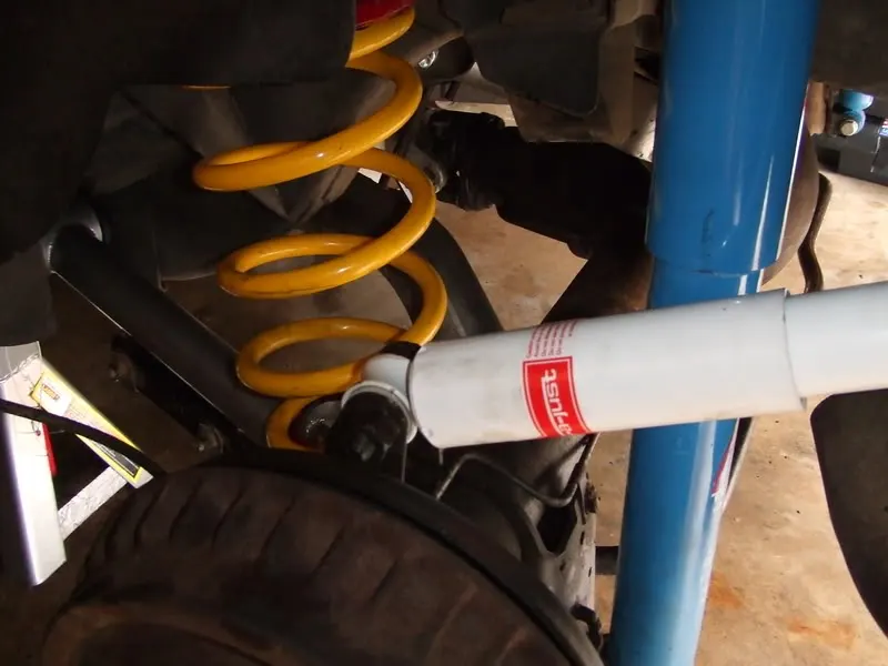

i did it all a few weeks back, i'm just now being able to post it though. i installed UPR upper and lower control arms with urethane bushings, tokico HP shocks and struts, kyb quad shocks, and maxspeed springs. i also threw on some energy suspension sway bar bushings and endlinks. along with the full length sfc's i had welded on a month or so back, the ride is a lot better (coming from what seems to be original factory stuff), but is a little harsh on bumpy roads. it definitely plants a lot harder and more solid, i need better tires though. lol. here are some pics:

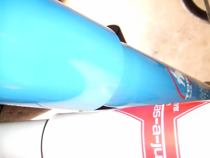

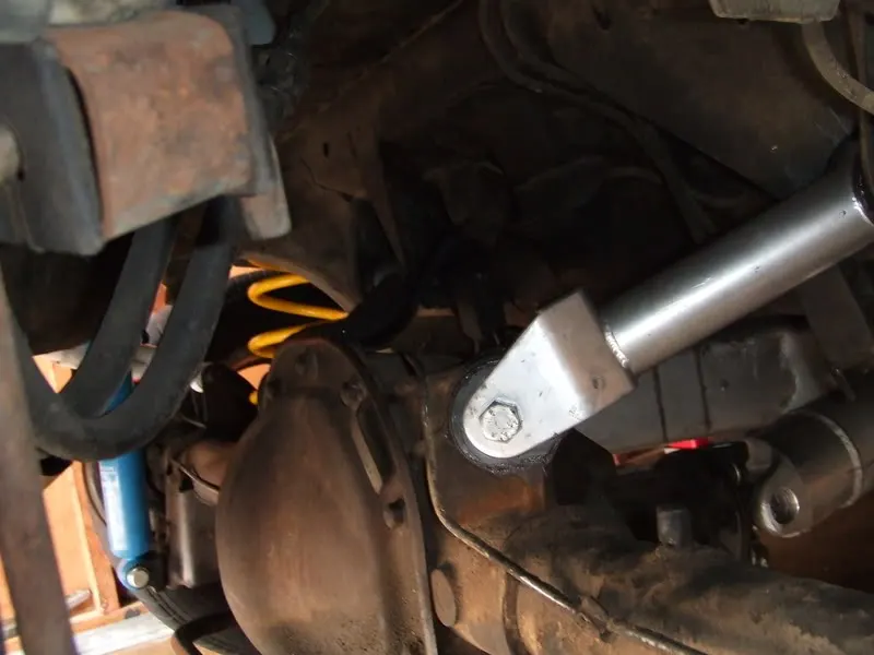

my shocks are rubbing, i need to flip the quads

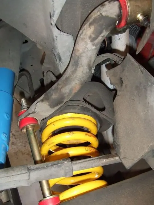

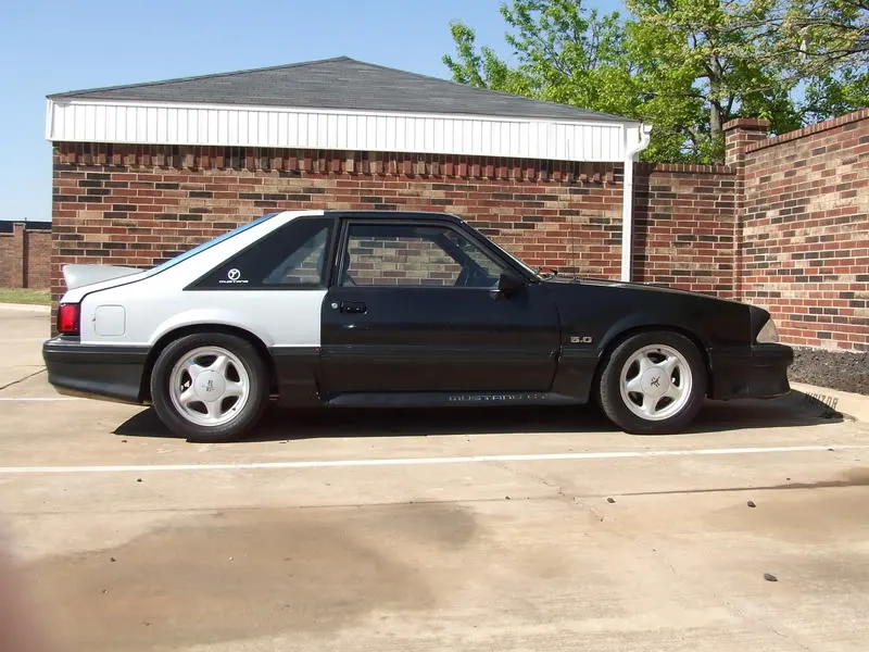

here's one of the front

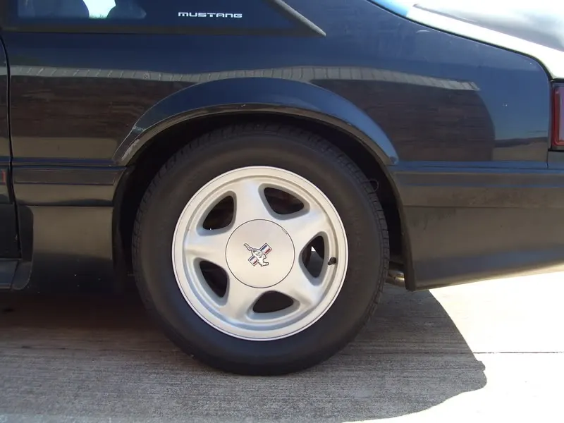

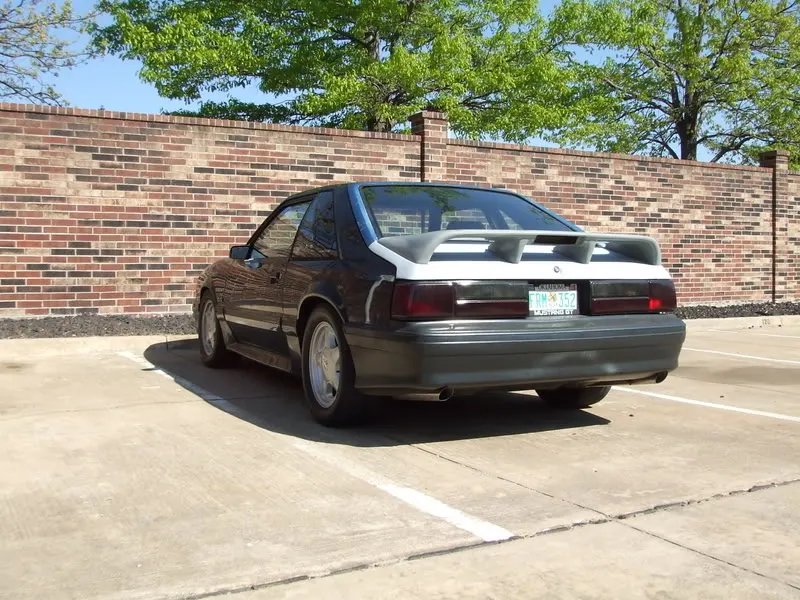

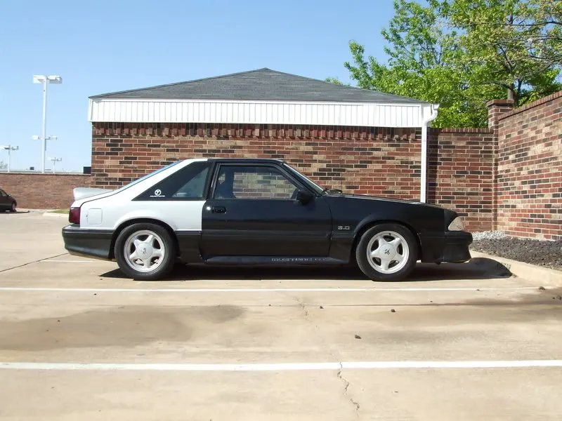

here's some shots of the new ride height. i like it, front raised up maybe an 1/8 of an inch but the back lowered an easy 1/2 to 3/4 of an inch, evening it up a bit. first, heres a before shot:

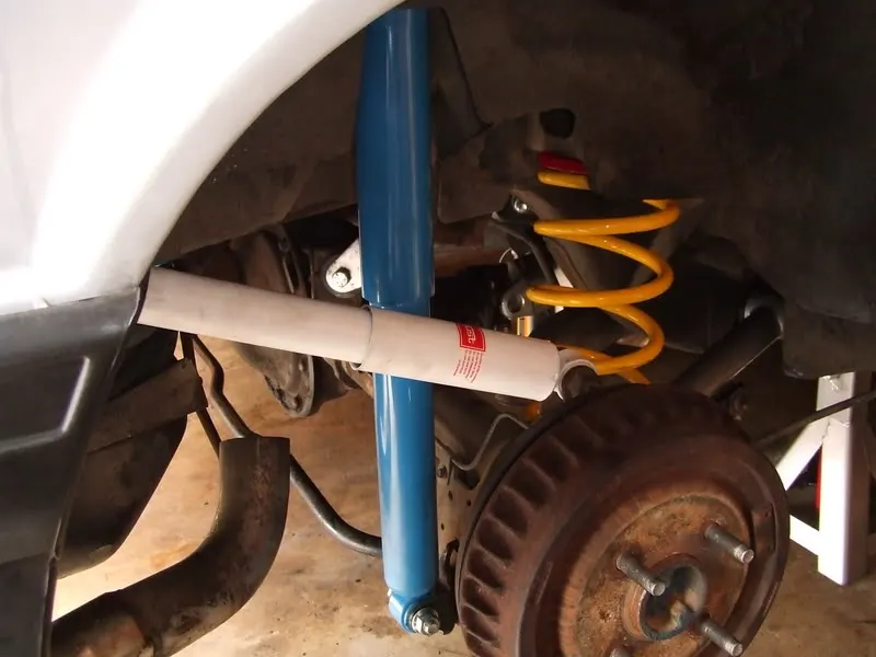

after:
it's settled a tad bit more since these pics were taken. i know she needs paint BAD, but i'm still working on that quarter panel. thats the next thing up so soon enough hopefully. thanks for lookin! comments and whatnot are welcome!
