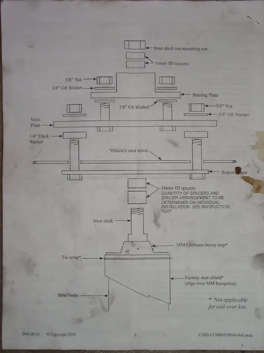

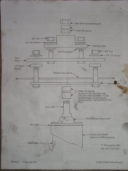

SeventyMach1, i think you wanted to know about the spacers for the MM CC plates. All i did was use however many the directions said to use. heres a pic of the sheet...

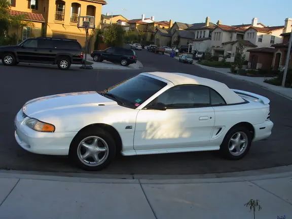

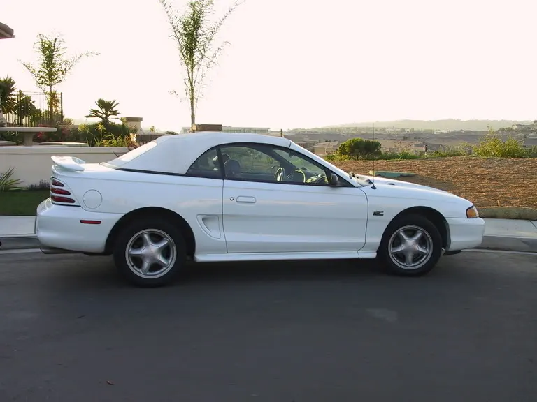

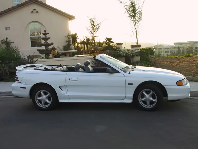

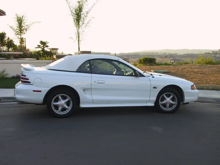

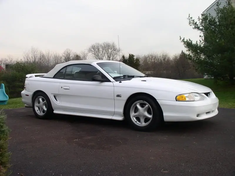

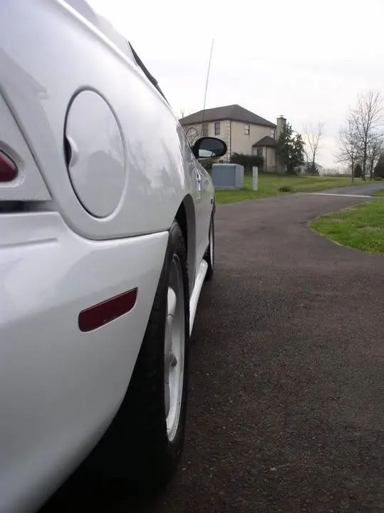

Now for some befores (from when my uncle owned my car)
...sorry i couldnt better before pics

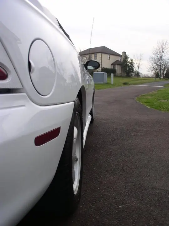

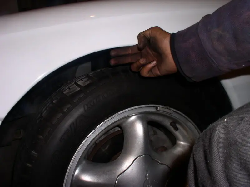

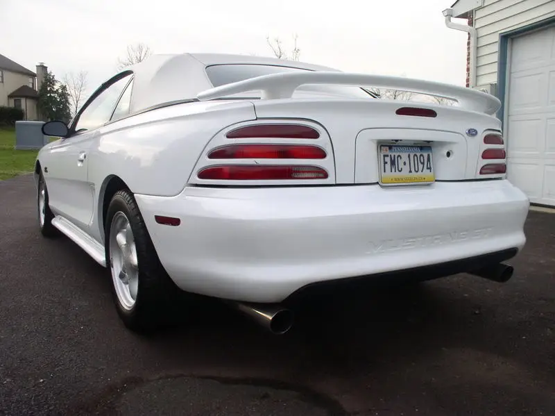

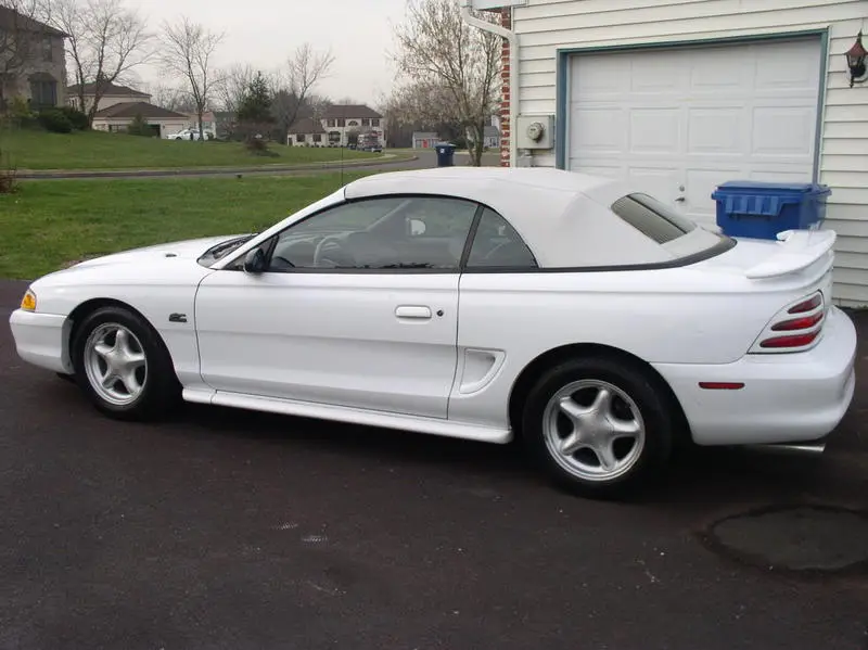

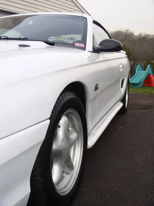

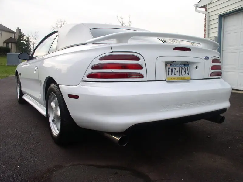

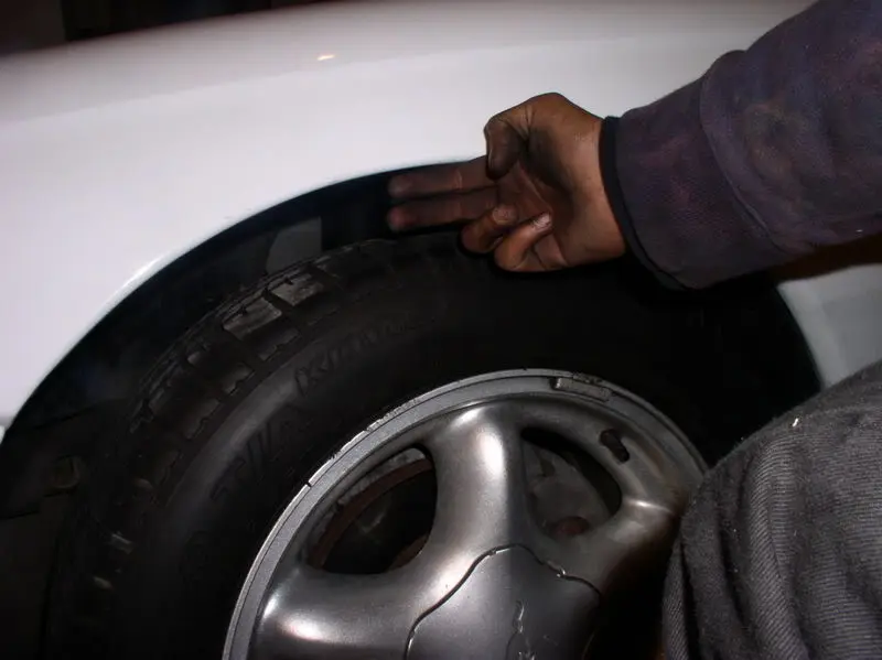

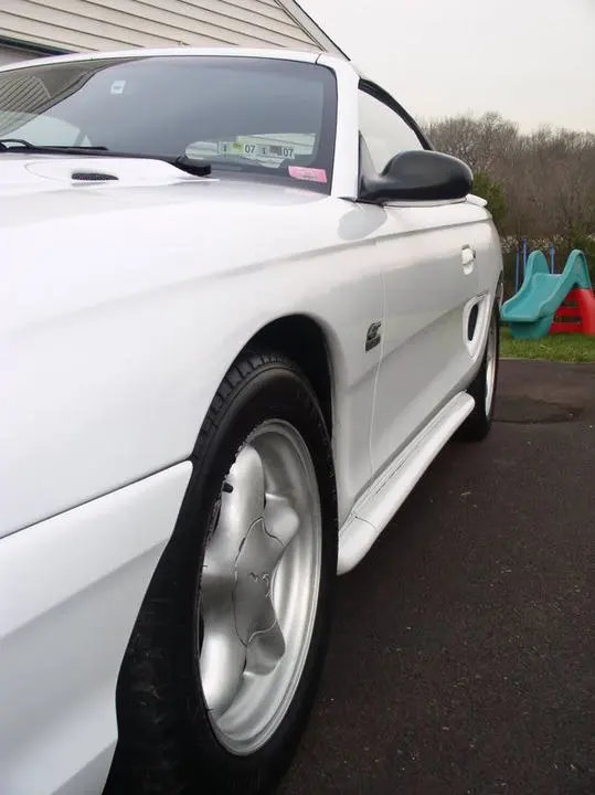

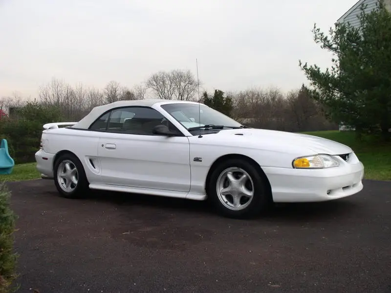

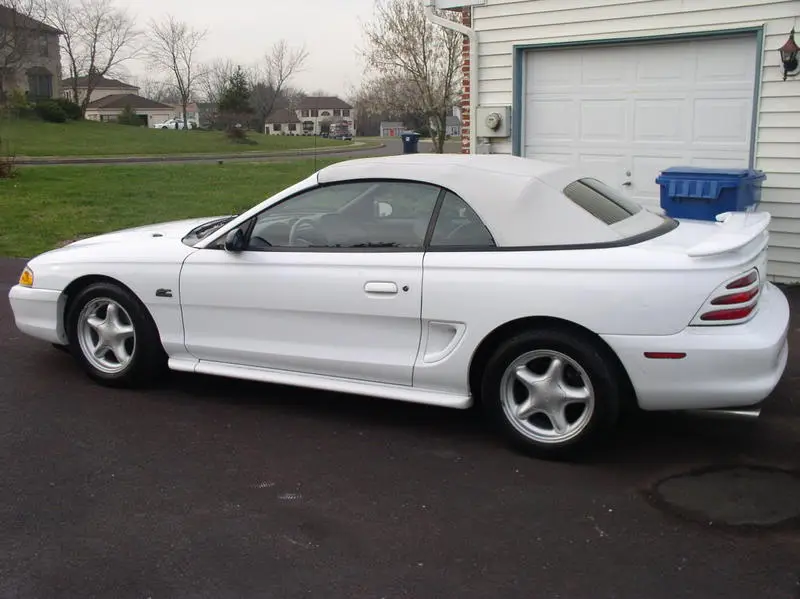

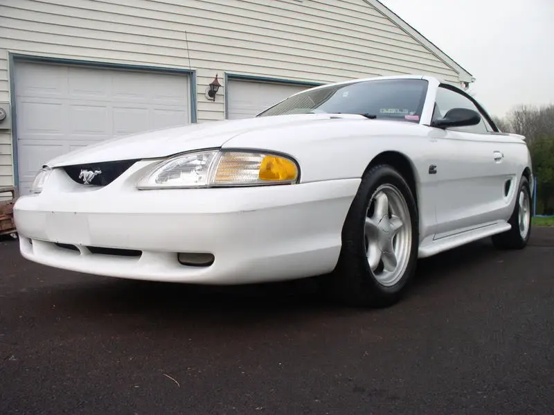

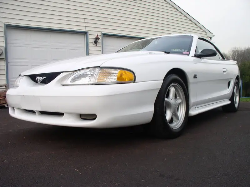

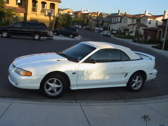

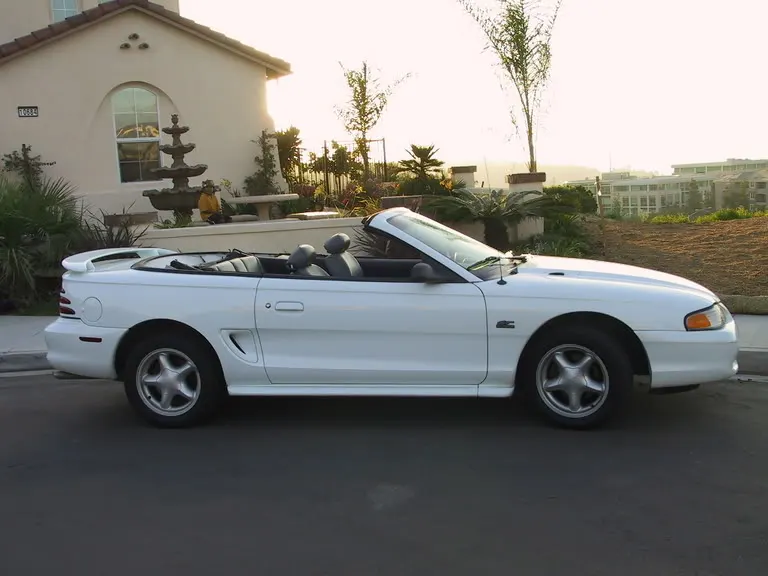

Now for the Afters...
this one is RIGHT after i took it off the jack stands
after the clean up...
oh yeah...h&r ss springs, tokico blues (fox), mm cc plates, 1 in spacers out back
...ok the car doesnt seem that low in the pics...but it is!!
let me know what you think!

Anyway, did you use 2 large one's on bottom & 2 small one's on top of each plate? Reason I ask again is that your diagram shows it that way ..... but it "says" 16mm spacers for top & bottom.
