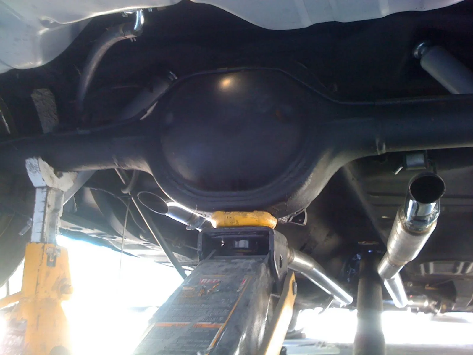

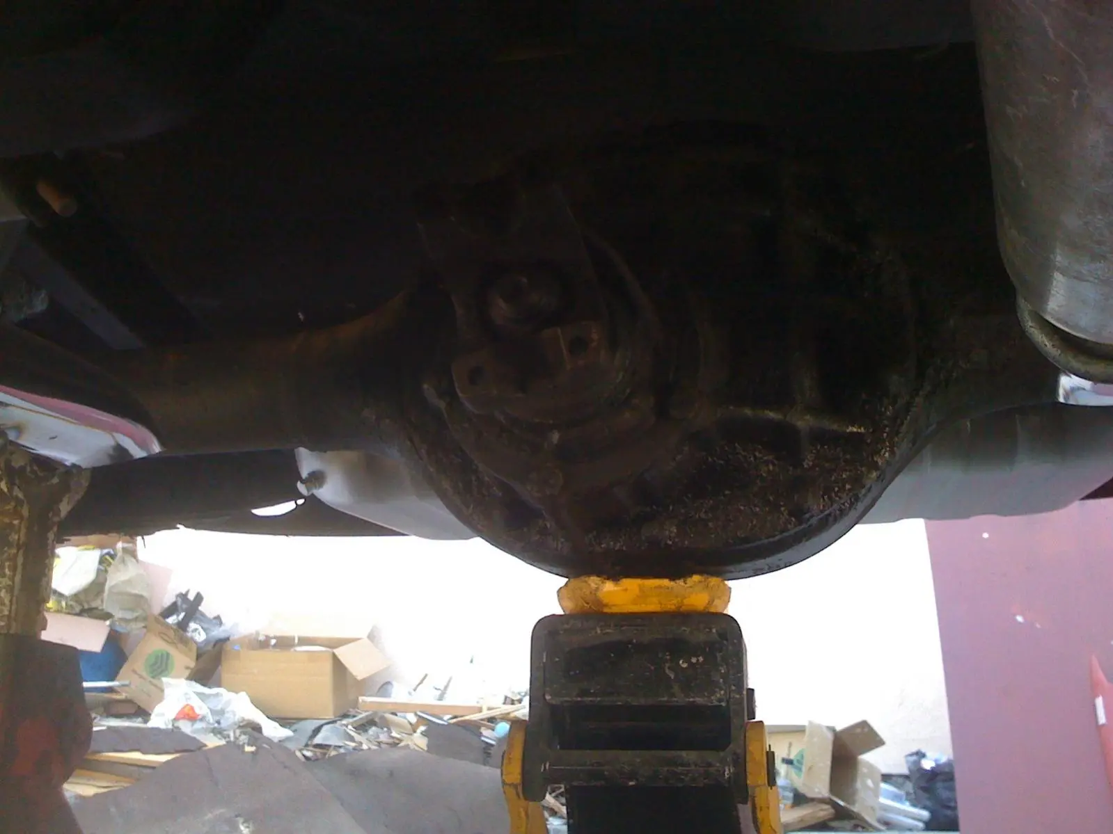

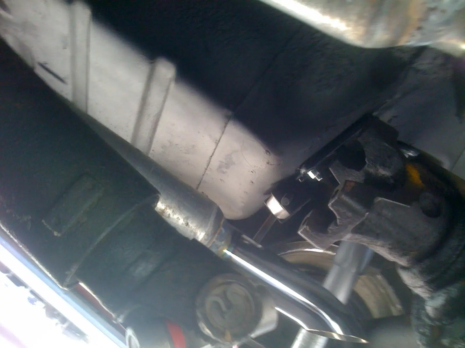

Now another problem that i have is im missing the little piece that connects the drive shaft to the yoke on the rear end. can u guys help me ??
ok this is what i mean i have the yoke but how do i connect it to drive shaft??i heard it gets connected with a univerrsal joint lock?? but when i looked under my 86 it had a flange yoke?? what can i use for this car?
where can i find one ?
