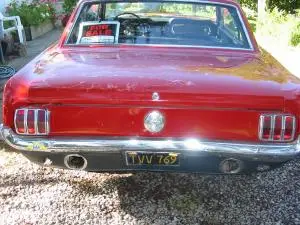

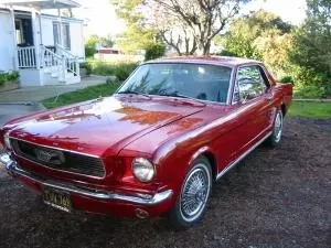

how much of bondo and fiberglass on the car is enough for me to walk away from? here's some pics of the car...

A note on the floorboards...ask to pull the carpet back, more than half of the floorboards rust from the INSIDE not the outside. I have seen many that looked great on the underside but were trashed from the inside.
