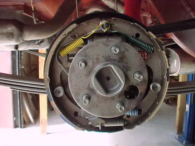

Also, should I bother getting auto adjusters for the rear?
Oh yeah.
