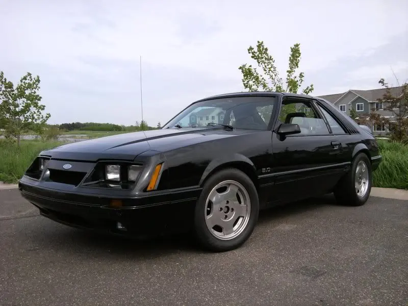

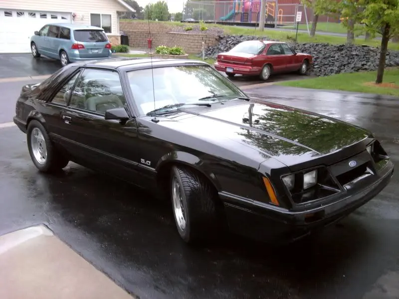

Just picked this Mustang up. I'm a car guy but have no experience with fords. 86 GT with a 91 5.0 swapped in. 3:73 gears in the rear. The engine runs very well, and even sounds like it may be cammed. Now, when shifting through the gears, getting into 3rd and up the rear end(sounds like it) starts to whine very loudly up until 55 or so, ONLY when on the gas. After about 85 it develops a vibration in the driveline which seems pretty severe. The car is in excellent shape and all seems well underneath, U joints, trans fluid, etc. Have yet to check the rear diff fluid. Could it be that the spacing between the pinion gears is off? Or do aftermarket gears usually make noise? Thanks
