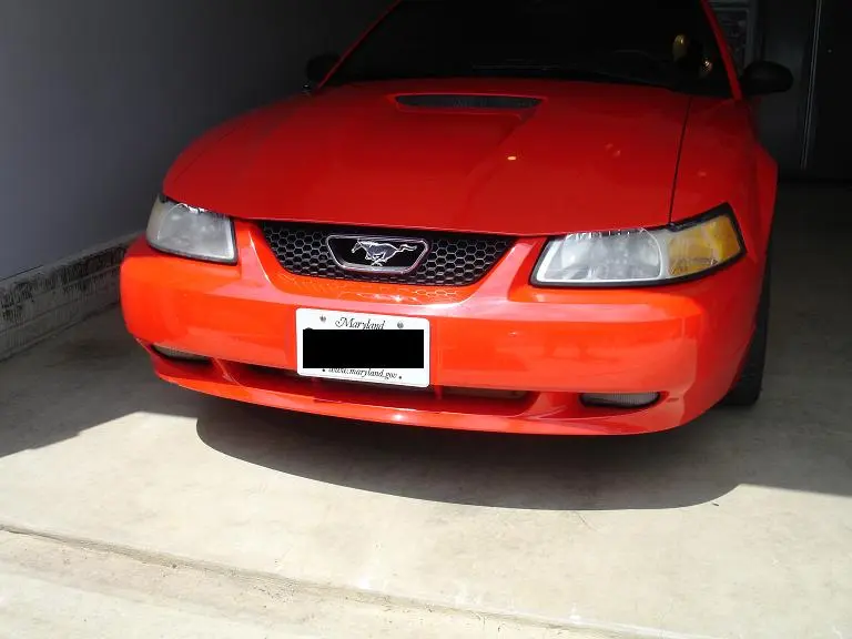

I just bought a 2000 Gt, 64k miles on it. It is the bright red (looks orange in some light) and i think its called torch red but not sure. It has 18" Saleen wheels (which im having a hard time finding the proper size tire for). It has the Eibach sportsline lowering springs with stock shocks and struts (need replaced i think). It sits lower in the front (Ughh) and scrapes the underside on the smallest speed bumps. I cant get into my garage without hitting the underside b/c of my steep driveway. It has Accufab plenum with BBK cold air intake, underdrive pulleys, headers with cat back exhaust. It has 4.10 gears (i think) with short shifter, white face gauges and some billet interior items.
I have ordered new headlights, Mach 1 grille delete and new 3rd brake light. Have new brakes and rotors ready to be installed. Im looking to replace the tires (thinking about Nitto555s) and the suspension (thinking about Ford Racing or the Bullitt suspension kit to get it set up properly and raise it a little). I like how it looks lowered, but think its not sitting right.
I need a black leather rear seat. I plan on installing some stereo mods to. Since the 1st owner took all the Mach stereo stuff out, it sounds horrible. Eventually I would like to add a supercharger. Not sure what else I need at this point.
I'm in Maryland. Anyone have any suggestions for the tires, suspension, rear seat and how to make it faster???

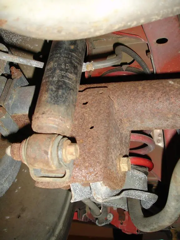

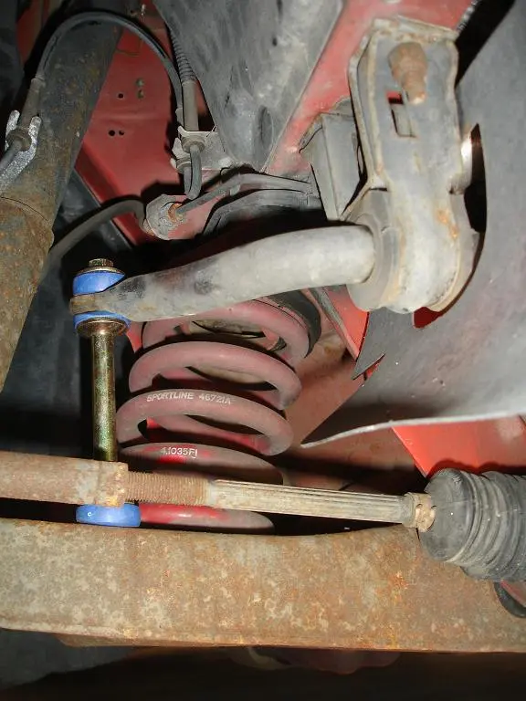

Thanks for the info and advise. It is sitting lower in the rear so Im not sure if i just need to replace the shocks and struts since it already has the Eibach sportsline lowering springs. I just want the back to lift up and sit a little above the front or at least level. It rides pretty ruff to, but i guess that is to be expected. I like the back seat in b/c i have two sons who like to ride in it. This is my toy car and wont get driven in the winter. I have a black 07' Chevy Tahoe on 22's for everyday driving.
Thanks again.
Sorry, I should have noted that the eibach sportlines are famous for "sagging" in the rear. Many others have had this problem. Shocks/Struts will not fix this.
I would suggest going with a Pro Kit since you have a clearance issue, the Sportlines are pretty extreme and slam the suspension. The Sportlines can really screw up your suspension geometry without CC plates, Steeda balljoints and bumpsteer kits.
I would suggest going with the Pro Kit and something like Tokico HP shocks, they give a great ride and can handle a stiff spring rate if you keep the Sportlines.
