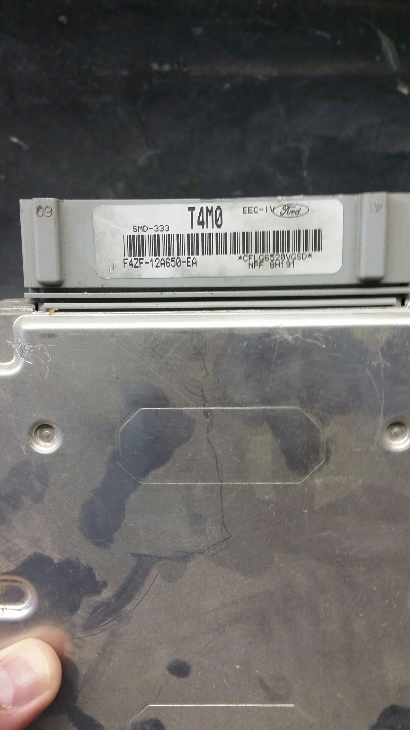

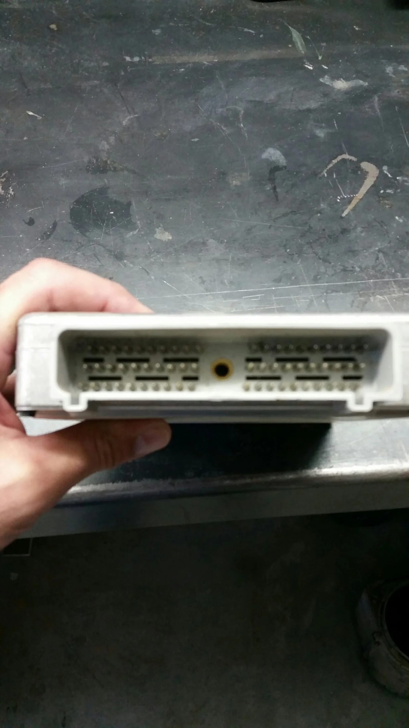

How many rows of pins are on the big computer connector for the wiring harness?
19falcon62
Active User
Jul 14, 2016
11
Jul 18, 2016
  • Jul 18, 2016
sorry it took so long to reply i have been out of town. @jrichker

Thanks for showing the computer connector, I would like to see the wiring harness connector as well.

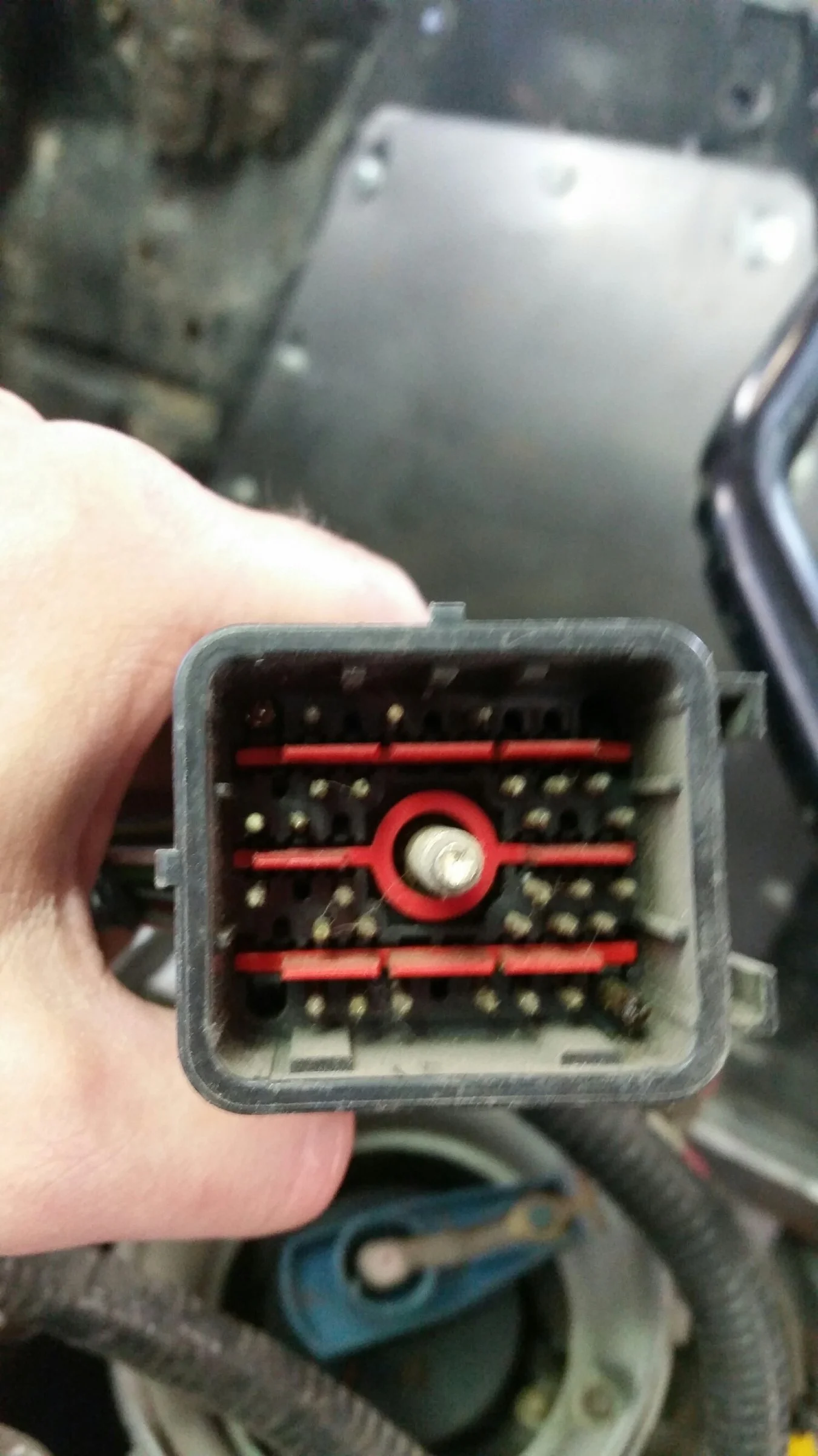

OK hope this is the one you are looking for.
Thanks for the help.
jrichker
StangNet's favorite TOOL
Mar 10, 2000
27,512
2,813
Dublin GA
Jul 28, 2016
  • Jul 28, 2016
The computer and connector don't match in any shape or form unless you have a trick camera that changed the shape of the connector.

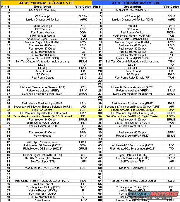

The proper computer connector looks like this....
See for the pin functions and wire colors on a 94-95 5.0 Mustang
