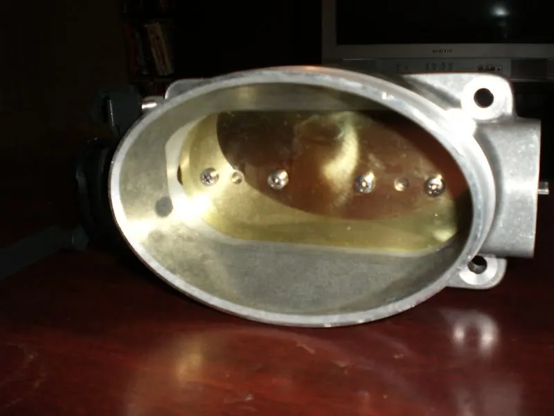

....as you can see by these pictures (below) posted by another SN member who upgraded his Saleen kit with the Tork Tech inlet. The Tork Tech intake is pretty mammoth by comarison.
One of the members of this site you might really want to hear from is rfedd. He's also one of the persons responsible for bringing the Tork Tech kit to light. I've been in regular contact with him about the kit and he Emails me everytime they've got new results.
Most recently it was a bolt on '99-'04 Saleen putting out 520 rwhp and 549.50 rwt @ 14psi through just the blower and upper inlet of the Tork Tech kit. The owner believes at this point its the heads and Saleen lower intake that are holding him back. I guess we'll see where it goes from there. Oh....and as far as I know, this was all done on pump gas as well?

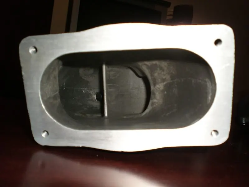

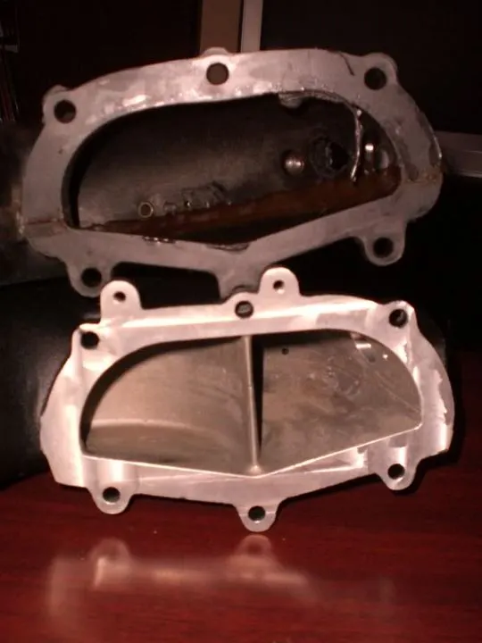

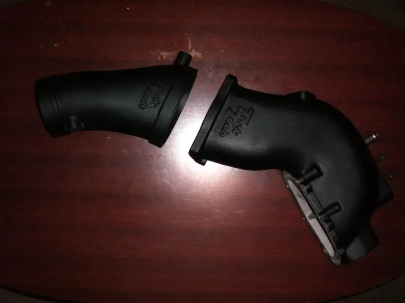

How do you figure? The Tork Tech kit was the brain child of FAST Secialties and Charles from Magnum Powers (who I shouldn't need to tell you has one of the best reps for putting out a quality product in the industry). As such, the kit utilizes a 5th Generation 4-loeb Magnum Powers MP112 that's more than capable of running head to head with a 2.1L Kenne Bell twin screw. Add the fact that the Tork Tech comes standard with 42lb/hr injectors and a high flow fuel pump (Kenne Bell supplies their kits with 36lb/hr injectors and boost-a-pump band-aid...but has the 42's as an option for another $350).
The Tork Tech kit also comes standard with a large bore single blade oval throttle body, high flow intake tube and a 90mm Mass Air Meter with a shielded open element filter. Kenne Bell wants an additional $812.00 for the "big tube" kit, that includes switch chip upgrade, large diameter intake tube, throttle body and Mass air upgrade + another $153 for the cold air kit. The intake system is also only available with a maximum 75mm standard round bore throttle set up).
The Tork Tech kit comes with a heavier duty intercooler and heat exchanger, which (unless you want to run race gas in the tank and insane amounts of timing to make big dyno numbers like Kenne Bell does when testing their systems....)certainly comes in handy when trying to keep things pump gas friendly when swapping out pulleys for additional boost later on down the road.
Top it off with the fact that the Tork Tech comes standard with an 8-rib supercharger drive system (a $399 option with Kenne Bell) and I really can't see how anyone would think the Kenne Bell is a better kit?
If the M112 isn't enough power for ya....no sweat. Just upgrad to the 600hp capable TVS 1900 for an extra $1,000 and you're good to go. Sure, Kenne Bell has the option for the 2.6L which lets be honest, doesn't make a whole lot more power than that, but you're paying over twice as much for the blower upgrad.....and it won't even clear the stock hood on top of that!

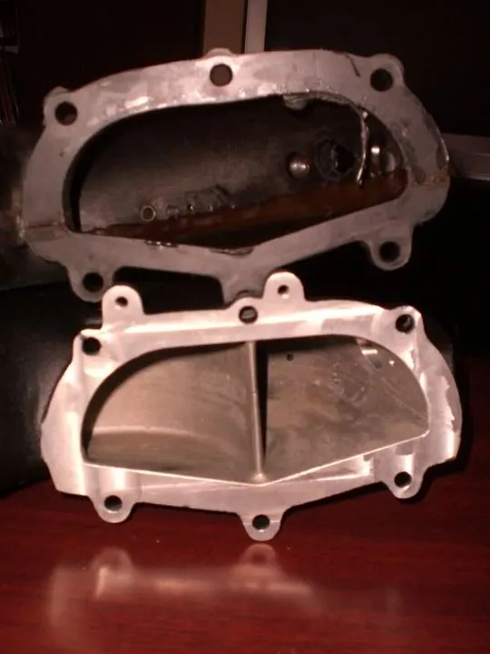

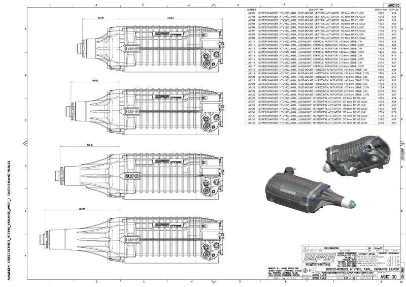

Hi Chris …
Thank you for your HTV1900 Supercharger enquiry.
Harrop manufactures the most advanced supercharger technology available, developed in conjunction with Eaton Corporation. The new HTV series is based on the Eaton TVS rotors, and is proving to be the superior solution for many applications.
As an indication of our new HTV supercharger retail prices ...
· Harrop HTV1350 (for any input/actuator configuration) A$2,275
· Harrop HTV1900 (for any input/actuator configuration) A$2,410
· Harrop HTV2300 (for any input/actuator configuration) A$2,500
The US-Aussie exchange rate today is 0.65, which equates to the HTV1900 costing approximately US$1570. The prices shown are FOB Melbourne excluding any duty/taxes (which should be nil).
I have attached some specifications of each for your consideration, and can forward more detailed drawing of the HTV ranges if required.
We have no knowledge of the compatibility of our HTV range to the kits you indicate below. It would almost certainly require some adaptation.
Feel free to call for further information. (+61.3.9474-0900).
This is the correct supercharger though, i got the contact and info from this thread: LS1GTO.com Forums - Magnuson MP 122HH supercharger - Page 5
$1570 even with our crappy exchange rate? That's awesome considering with the TT kit you'd be paying about $3k for it on top of the intercooled kit bare. I have no idea how cheap the MP112 would be.
This is what he attached:
Keep in mind you would still need to buy the TT intake parts - so who knows what they would charge for that - but this is certainly a price savings. It'd be $3570 for the tuner kit + intake parts instead of $4800 with intake parts when using the TVS 1900 bought from Australia vs from TT.
I say the Blower from Australia + TorkTech kit should be called the CobraRed mod:p
