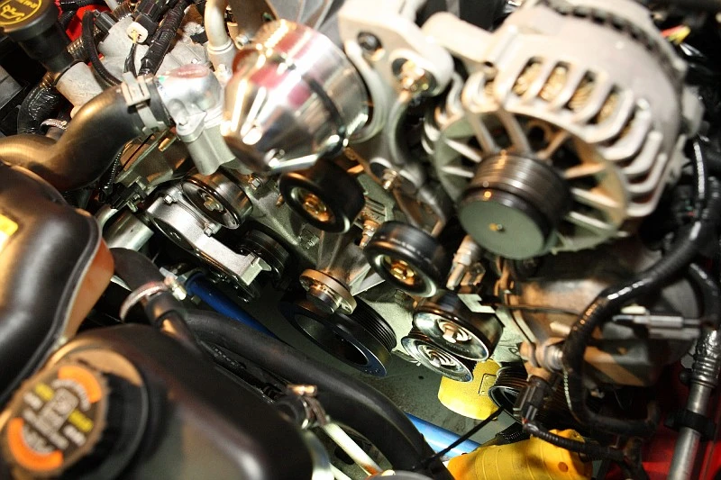

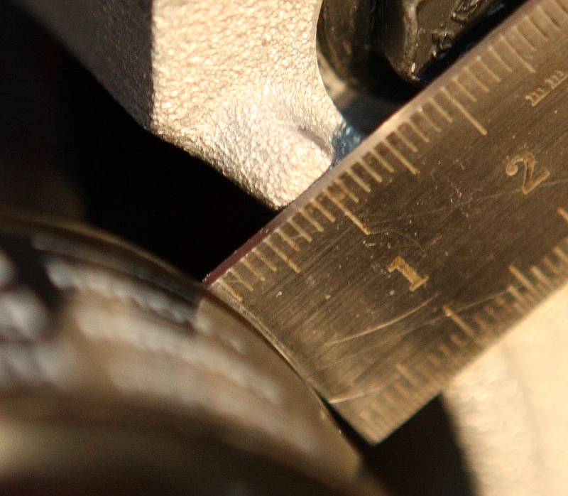

You can see there is limited clearance between the stock 3" snout pulley and the alternator bracket, which has a raised rib molded into it. Additionally, clearance is not uniform around the periphery of the pulley; it is tightest near the top.

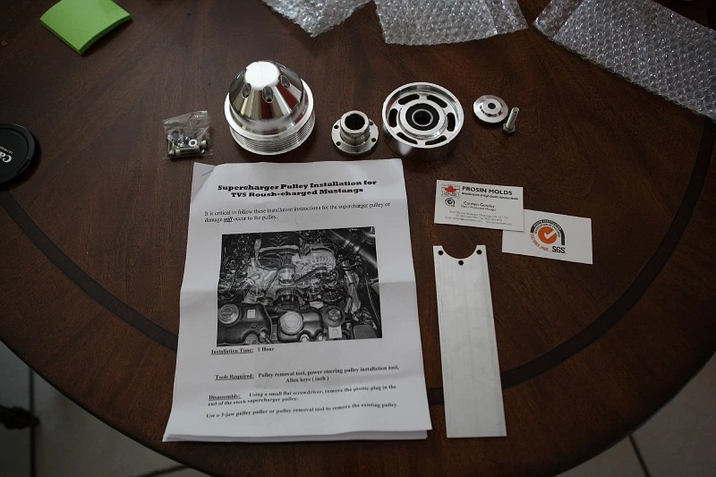

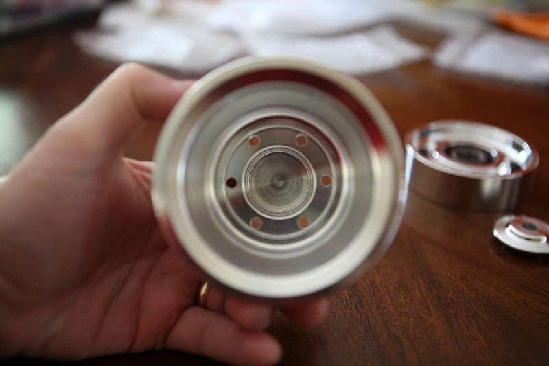

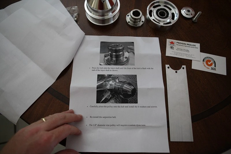

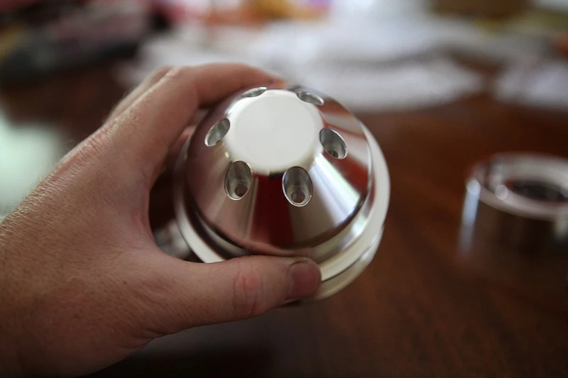

Paper mockups were made, micrometers were employed, PM's were exchanged, and Carmen fired up the CNC machine and delivered me some billety-bling.
Take heed of the pure moto-**** that emerged from the FedEx box. It is an impressive package - all parts are individually bubble-wrapped, instructions are clear and concise, and the parts are polished to a show-quality luster. Carmen even built a special "holding tool" to keep the pulley from turning during installation, which was very useful. I had Carmen add a billet 85MM idler, just in case I had belt tension issues, as the required belt length was unknown since I am the first one to run this diameter pulley.

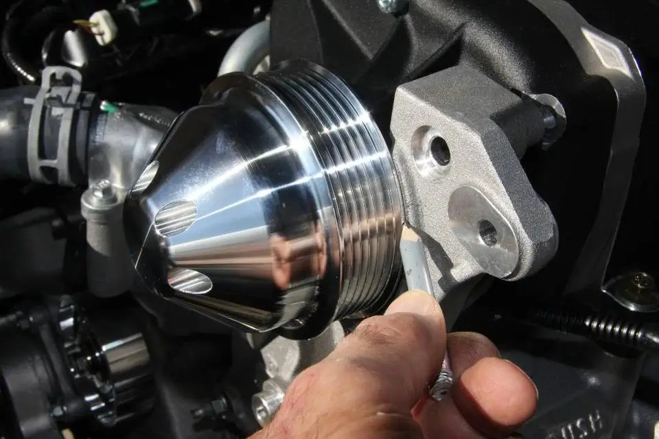

The pulley size I asked Carmen to make was one that is the absolute maximum size that can be installed without grinding the alternator / FEAD bracket "raised rib". That size is 3.47" (88.14 mm) at the top of the pulley's V-ribs.

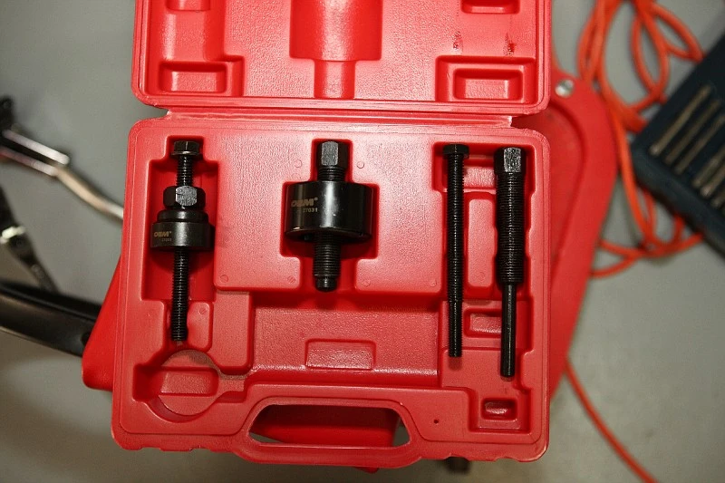

I needed two tools, both available as free rentals form my local autozone.
1) A large, 3 jaw puller
2) A power steering pulley "install / puller" tool

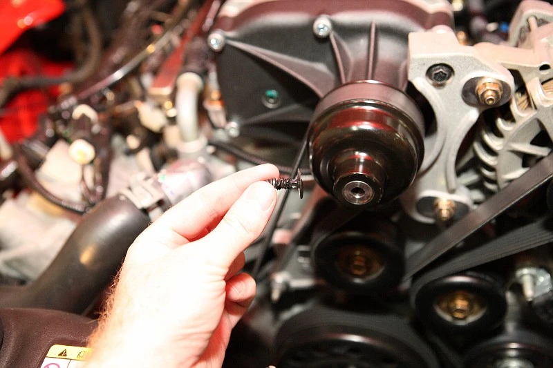

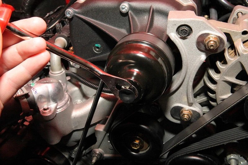

First, I pulled the plastic plug out of the stock TVS snout pulley ( I used a panel-popper from my car stereo days, but a screwdriver / pliers will suffice just fine):

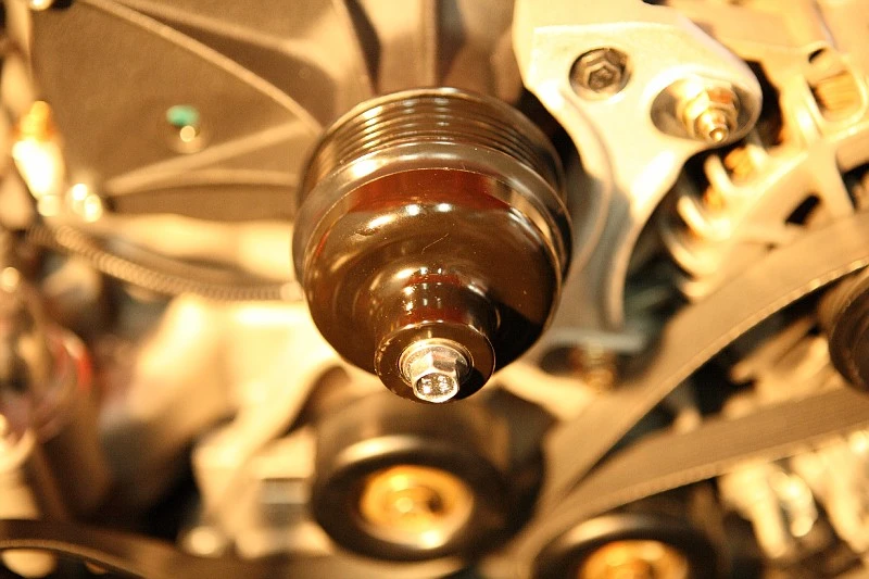

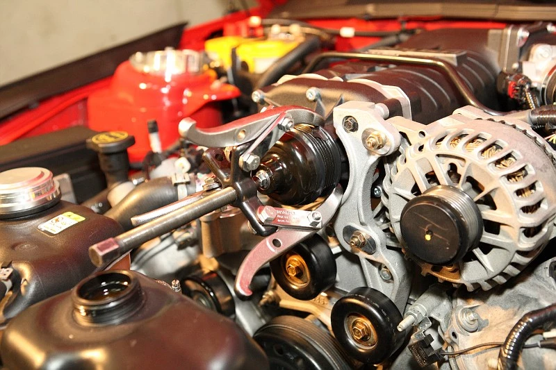

Then, I wrapped 3 turns of electrical tape on the front and aft edges of the stock pulley, so as to not mar it during removal. I also added a short M8x1.25 bolt (that is the TVS blower shaft hole spec - bolt procured at Lowes hardware) to act as a stop for the pulley shaft and protect the opening:
Here is the 3-jaw puller doing its job. I removed the intercooler reservoir cap to provide more clearance; I placed painters tape over the opening to keep it clean:

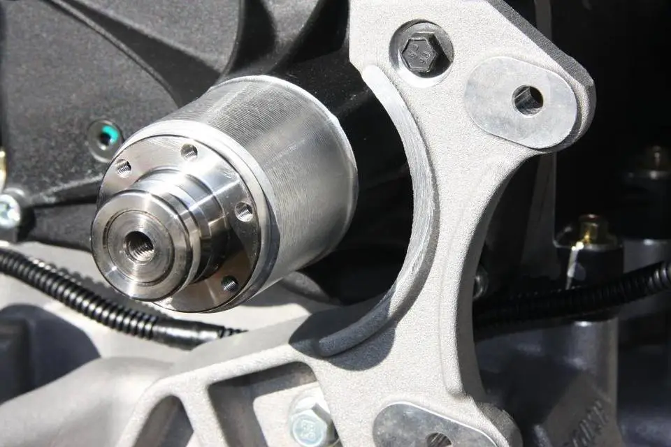

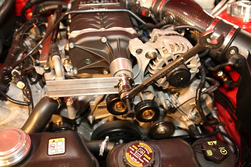

I then mounted up Carmen's press-fit billet pulley mount adapter using a power steering pulley press, again rented from autozone. Note: Do NOT allow the press shaft bolt that screws into the blower shaft to bottom out...if the bolt snaps it will make removal difficult. This may take a second person to hold a wrench on the end of the press to keep the bolt from threading in too deep. The first Autozone press I used gave its life (the bolt snapped) so I had to pick up a second one to finish the job:
I don't recommend the Autozone tool, as it is of poor quality, but the bottom line is it worked. (When I returned it they didn't charge me for the damage and said they see them broken all the time). Perhaps O'Reilly or Advance Auto will have one of higher quality, or you can purchase a dedicated pulley swap kit from various vendors.

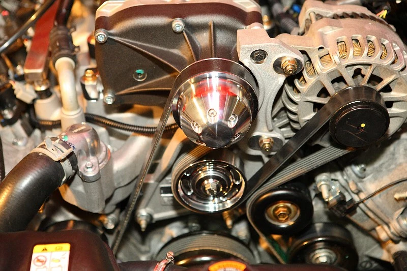

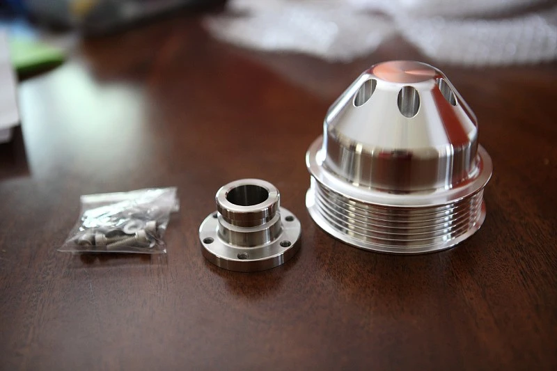

Once you have the press adapter installed, the 3.47" pulley itself literally bolts up the the adapter with six hex-key allen bolts. I added some blue Lok-Tite for good measure. Since I was removing the Steeda damper, I had also rented (again, free from Autozone) a harmonic damper puller tool...I removed the steeda underdrive pulley and re-installed my stock GT damper (I had removed the rust off of it with my wire wheel and moto tool and re-painted it two days prior). Here is the freshly painted GT damper and Carmen's 3.47" pulley installed:
I then employed my helper for final belt installation:

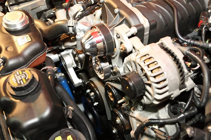

Note the 85MM billet idler below the 3.47 TVS pulley. It allows me to use the belt that came with the TVS blower with perfect tension:

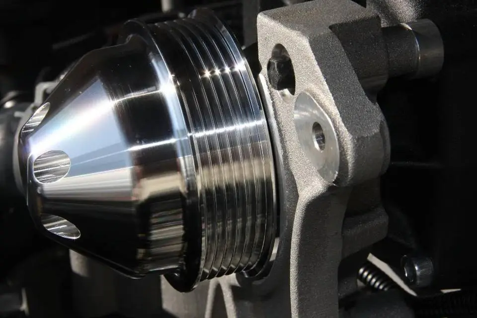

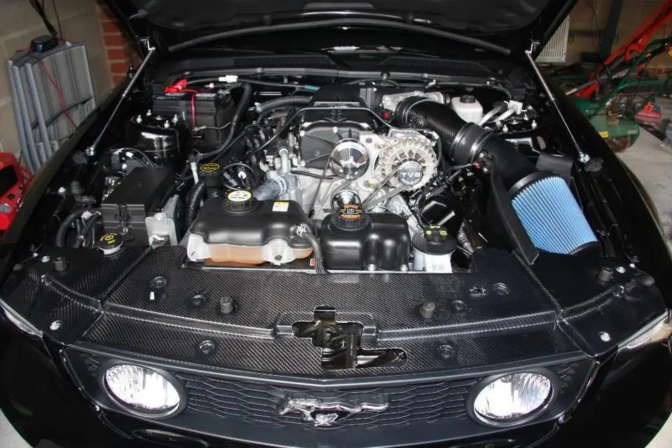

I am also running a set of Carmen's pulleys on my TVS. I went for the 8lbs option, which equates to a 3.75" pulley. As Shane explained, this requires some very slight grinding on the alternator bracket behind the pulley, but this is really easy to do with no adverse effect.
My final numbers were 421/391 RWHP/RWTQ on a Mustang dyno, which equates to about 455/422 RWHP/RWTQ on a dynojet. Peak boost was around 8.3lbs. My car is an 07 Auto, with no motor mods other than the TVS.
I also opted to add the complete set of pulleys from Carmen, just to up that 'Bling Factor'!

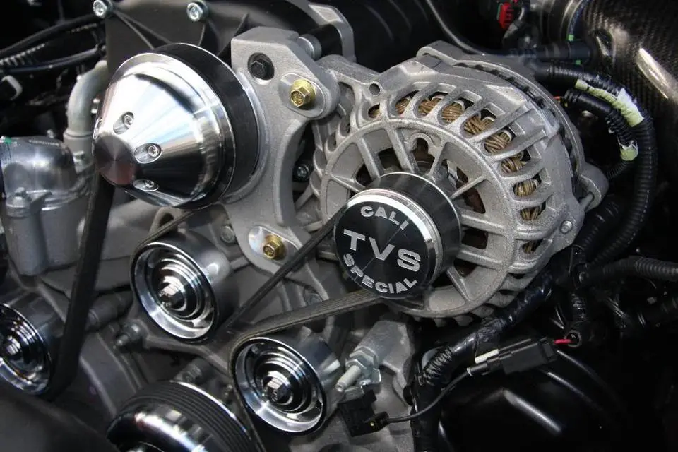

These pictures show the minimal amount of grinding required to fit this size pulley...
And the finished item...
I cannot overstress the quality of these pulleys or how easy Carmen is to work with. Even if your car is N/A, I would definitely recommend them.
