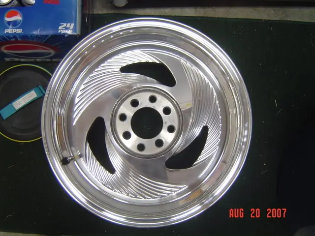

I just picked these wheels up and would like to know what is the best to polish them with.
Assuming they're bare aluminum, I'd use PowerBall and PowerMetal polish from Mothers to clean them up initially. Wipe the polish off with a microfiber. If you think they'll polish up some more, flip the PowerBall around and use Mothers Billet Polish... should come out real nice.
