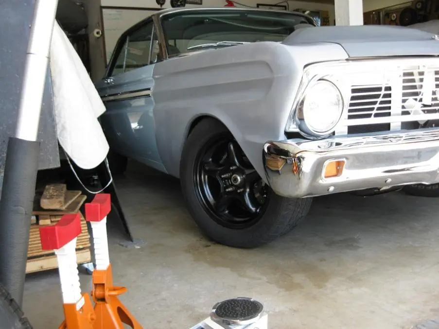

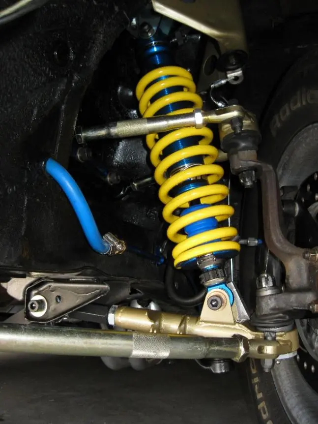

Im new to the site, i have a 65 falcon transam theme. I custom built my own suspension. here are some pics

289 with edelbrock perfomer RPM heads, cusotm cam, victor JR, 650 speed demon, full length headers. makes aroun 375hp at the crank. C4 with reverse manual valve body, kevlar bands, red alto steels and 6 gear planetary. The rear is stock 8" with 270 gears. i am designing my rear 3link right now. also working on my own rack and pinion.

yes, i am running a sway bar. I will get some new pics up. If you look at the bracket just to the inside of the coilover mount that will be the rodend attachment for the sway bar.

The ball joint holders are afco and allstar products. the swedged steel tubes are from speedway motors. The shocks are afco. The tabs are from my local hardware store. i built it all myself. the uppers are close to something you can buy, but not perfect. so i made them myself for under half the price. And better components. Low friction ball joints and teflon lined chromoly ball joint.

i have an accelerometer in my car and i can tell you what my specific car can do with my set up and tires. but i think better numbers may be the suspension characteristics. Like roll center, camber gain curve, caster gain curve and scrub radius and others. also maybe the adjustability of all these components. any after market company should be able to provide you with these numbers and that may give a good comparison?

i designed my suspension to be completly adjustable, so i could do all three, street, autox and drag.

just so people dont get the wrong idea. I built this for myself and dont own a shop or any suspension company. I built it cuz i didnt want to spend 2500-3000 for a similar setup. I also felt i could design a system that was better engineered for my car than anything off the shelf.
