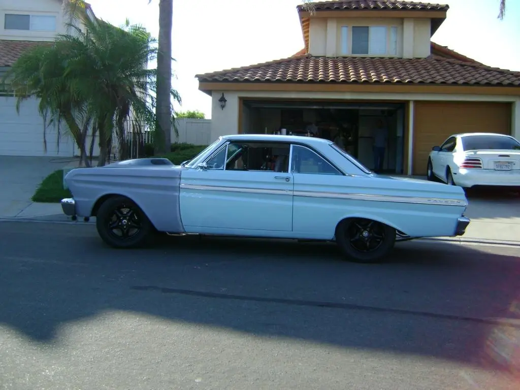

I put in a 9" with 4.11 gears. I lowered the back three inches and i have a 245 tire on a 16" rim on all four corners.
yep, good eye. I stole them off my 95 to see if they fit. and they do. with a 1/2" spacer. you can see my 95 in the background it has my centerlines from my falcon on it.
