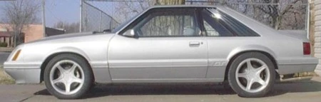

I've had my 85 for 17 years and have done many upgrades over the years. I can answer many of your questions also. I tried the KYB Gas-a-justs and agree with v8only, they sucked. It may have been due to the fact I have stiff lowering springs (650lb front/200-250lb rear). I have the 17x8 99+ GT wheels with 245/40ZR17 tires and the fronts do rub the inner fender liner when turning too sharply. I don't have the dampners on the rear so I couldn't tell whether there is any clearance issue. You might try http://www.afswheels.com/v2/ for more information about which wheels you can use. As I recall, they are very informative. You can e-mail me with questions and I'll try to help you out. If I haven't done it yet, I've researched it.
Here is a pic I just uploaded with the wheels on my car. I love them, but now I need a new paint job.
