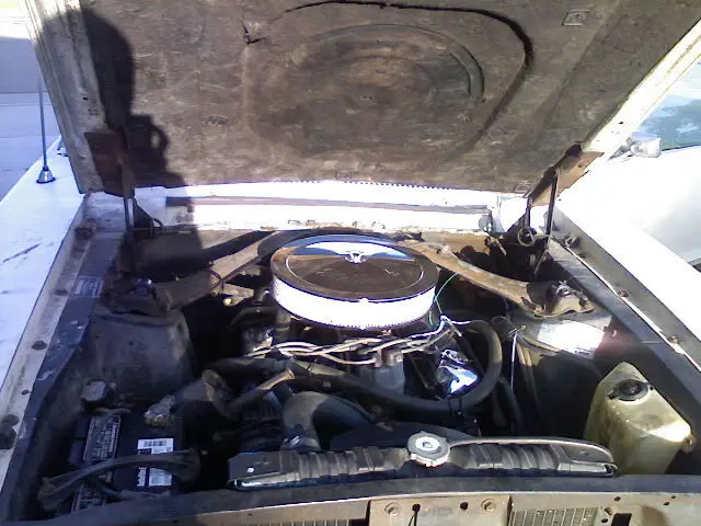

Ok well i just got my hands on a 1967 Mercury Cougar with the ford 289ci engine and 2 barrel carb. Now this "v8" wasnt all i thought it would be. And i want a fast "muscle car" if you will. Or be able to beat the other daily drivers out there without a problem.
My question is is the 289 a performance worthy engine. Because right now i can tell you that my stock 289 is not going anywhere anytime soon. So, from what i have heard I have a good reliable engine that can put pretty much as much power as a 302.
***So im looking to get headman shorty headers along with dual flowmaster 40 series mufflers. A performance edelbrock intake manifold with a 4bbl carb to replace the 2 barrel. And a nice performance Cam kit. Is this going to make me feel a little better about my 289? a lot more power than i have now?

well first of all, you can't really expect ANY stock engine, V8 or not, to be "muscle car fast" unless it is a special model with a bigger engine or whatever.
Your 289 can be wicked fast, there are plenty of parts out there to make it fast. Using a 302 or 351 will make it easier to make more power, but not necessary. But I think throwing in a stock 351 isn't going to get what you want either.
No one can tell you anything unless you give us some goals and tell us some things that are out of the question. How big is your budget? How do you want the car to act? Generally, if you throw in a decent cam, get a good set of aftermarket heads, upgrade the intake, use a 4 bbl carb, get headers and exhaust.... you should make some pretty good power.
Check out Dougs for headers. Thorely is the man for headers.
For the love of God... not the Flowmasters. 2.5" mandril bent exhaust with Magnaflows are what you really want. Flowmasters are for setups that need the extra back pressure.
If you swap to a 4v intake/carb without changing the cam too you will not get increased performance, just worse gas milage.
Puting a set of heads and exhaust on the motor will get you instant HP and torque.

As far as the 289 goes, it is one of the most winning engines ever.
THe 2v motor, when it was new was plenty for the little cat. 40 years later, compression is down, the carb is tired, your timing gear is sloppy, and the clutches in the transmission are worn. Of course it isn't going to melt the tires. Plus, you probably have a nice high way 2.73 or 3.00 rear end. Good for over all performance, but again, not meant to go racing.

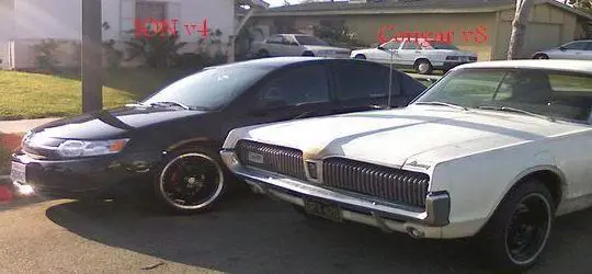

I know my ION is not a v4 but an I4. i did it as a joke at another forum.
