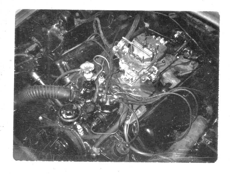

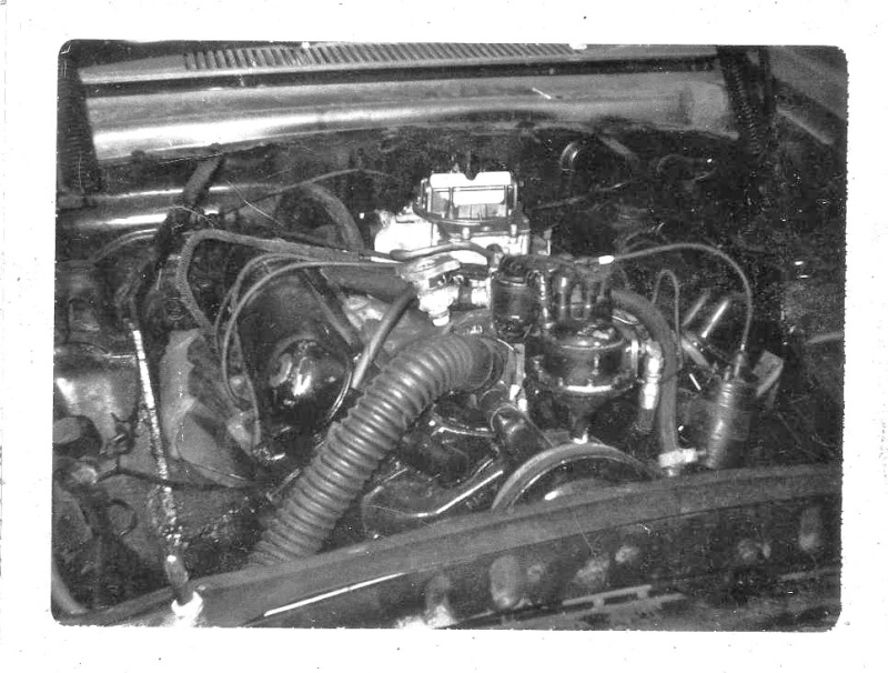

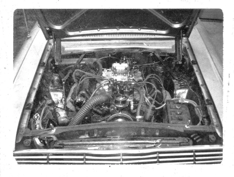

Crazy things CAN be done, as you mention, least amount of modification is often a moot point. Below, my 1963 Falcon, ca. about 1970, with a big, 430 Lincoln tucked away under stock hood.
You can see the flat, 1/4" plates I welded on the spring towers, and the huge iron exhaust manifolds, this was a WIDE engine for it's time! Sorry, no digital cameras then. imp

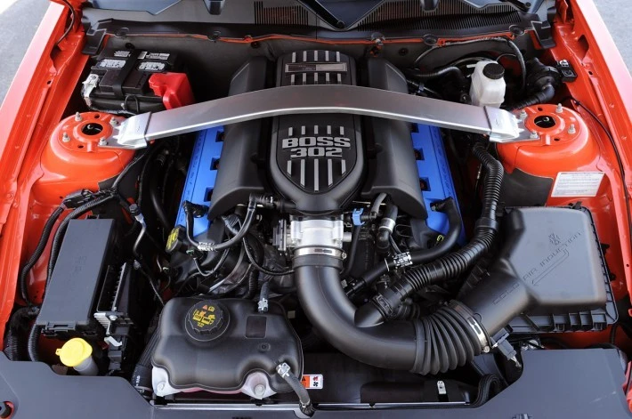

Yes I have an idea. Nothing will "bolt up". That is an OHC engine, very wide, and you would need to know it's overall dimensions, and measure the engine room in your '69 to even consider the possibilities. It can be done, don't know the vehicle, or if those spring towers were modified, but here's how it would look:
