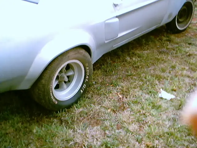

Minitubs I suspedt would be best. I haven't gotten around to that area ofd my '69 yet. However I got 295/50/15's under my '67. (Long time ago) Trimmed the snubbers. A narrowed rear and flares. Flares partly because though the quarters were otherwise fine, the wheel well lip was rusted. It has 18's on it these days but here's a shot from over 20 years ago.
