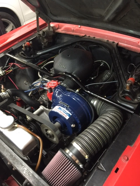

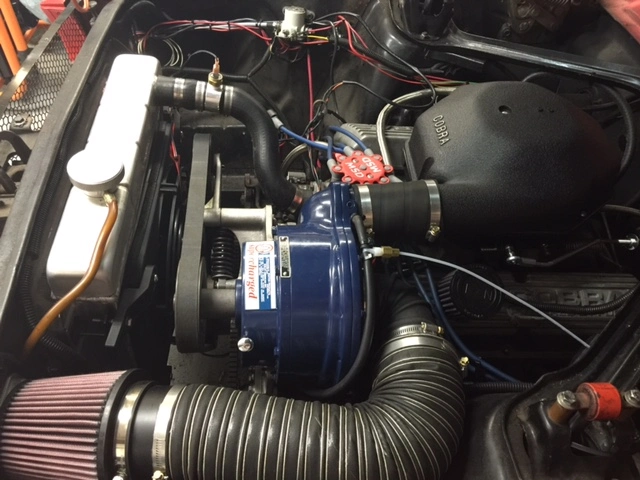

Alohastang Member Jun 2, 2006 38 6 19 Honolulu Dec 15, 2015 #1 Dec 15, 2015 #1 Attachments 70.webp 103.4 KB · Views: 325 71.webp 101.1 KB · Views: 342
horse sence 15 Year Member Nov 29, 1999 12,519 8,562 233 Wile Coyote's stunt double Dec 15, 2015 #2 Dec 15, 2015 #2 Nice . Did you change out the brass floats in the carb for the plastic solid floats ?A Paxton will crush the brass ones
Alohastang Member Jun 2, 2006 38 6 19 Honolulu Dec 15, 2015 #3 Dec 15, 2015 #3 horse sence said: Nice . Did you change out the brass floats in the carb for the plastic solid floats ?A Paxton will crush the brass ones Click to expand... I sure did.... I got the Holley 650 Double-pumper set-up from the Paxton supplier.
horse sence 15 Year Member Nov 29, 1999 12,519 8,562 233 Wile Coyote's stunt double Dec 15, 2015 #5 Dec 15, 2015 #5 Alohastang said: I sure did.... I got the Holley 650 Double-pumper set-up from the Paxton supplier. Click to expand... You would be surprised how many people don't change the floats ,then wonder why the floats look like a raisin after they have driven it a bit

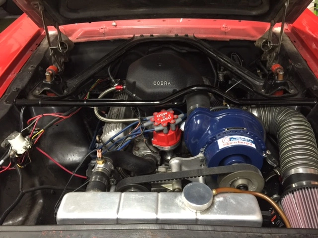

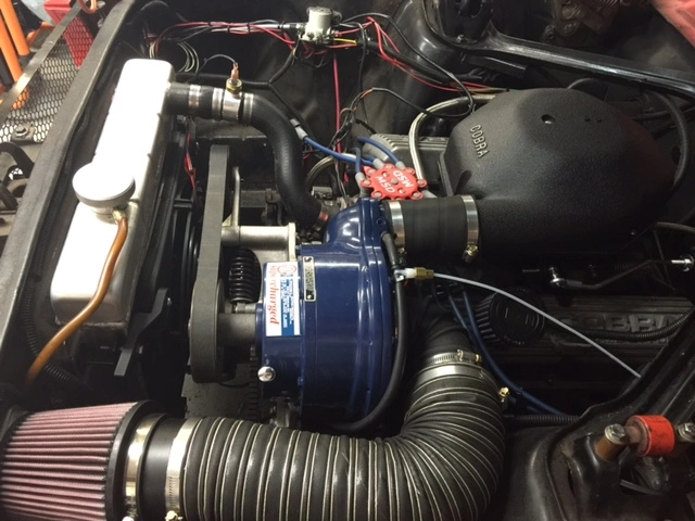

Alohastang Member Jun 2, 2006 38 6 19 Honolulu Jan 13, 2016 #7 Jan 13, 2016 #7 Just installed a new Monte Carlo Bar with the bend for the Paxton.... Attachments 2000.webp 104.2 KB · Views: 270 2007.webp 102.6 KB · Views: 313
