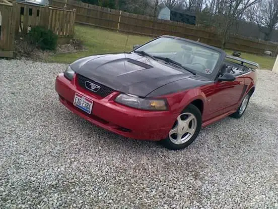

Keep your eyes on the lookout for a 1999-2004 8.8 rear out of a gt. It should have the locker in it. Also gears will be easier to buy for the 8.8 vs the (7.5 i believe it is.) The car should still bounce in the front if the shocks were gone. Hell it would bounce to much which is a sign of bad shocks. Now if the car isn't bouncing at all and the front seems really low I'd check for a collapsed spring(s). I had dual flow master 40s with custom h pipe that was all 2 1/2" pipe on my two toned vert. Sounded good.
