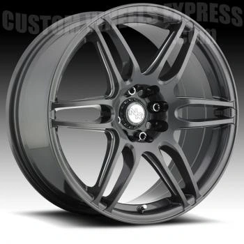

Niche Wheels
These are the wheels
Stock wheels are
16x7
4.25" BS
+22 offset
Looks like those are FWD rims but the numbers, and not really ideal. They will sit VERY inboard on your car. You'd need 1" spacer or more to make them flush, and that's not really ideal.
It all comes down to your taste. I would hate like hell for someone to pick wheels out for me. I personally have been really liking the 93 cobra wheels lately
