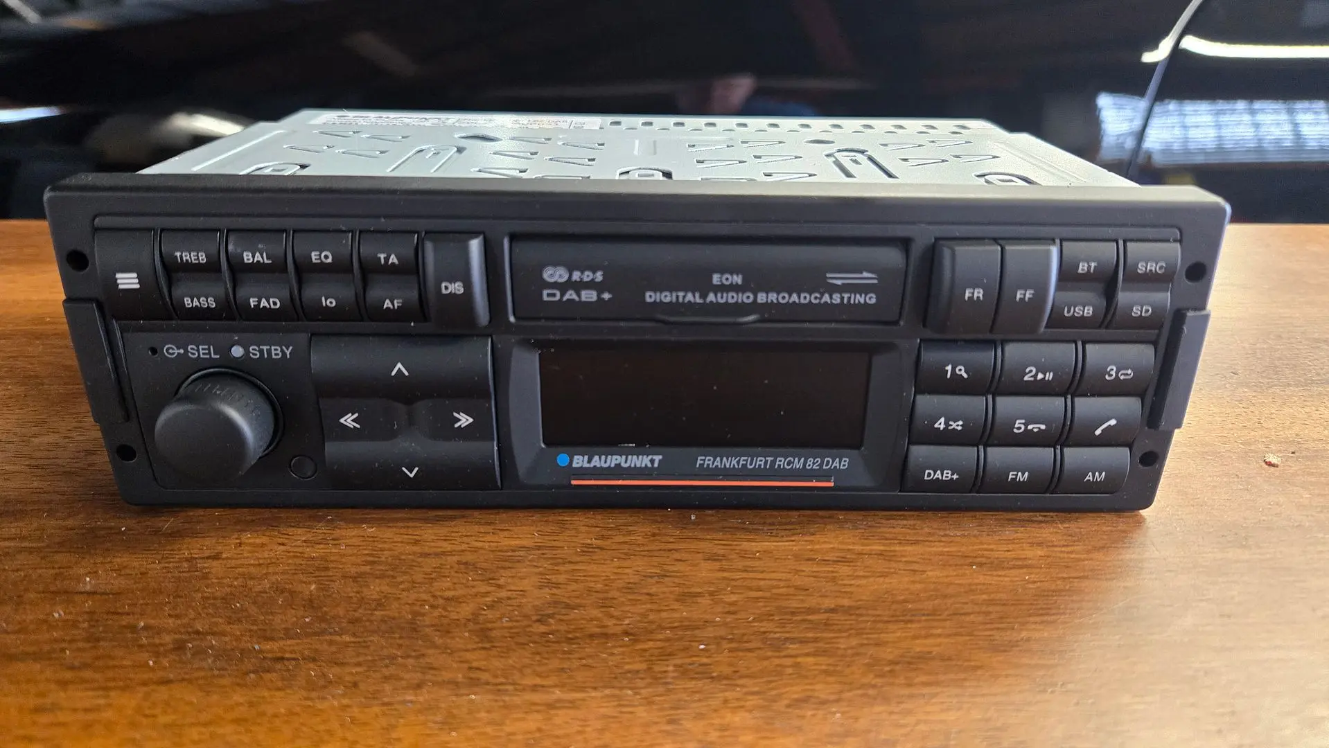

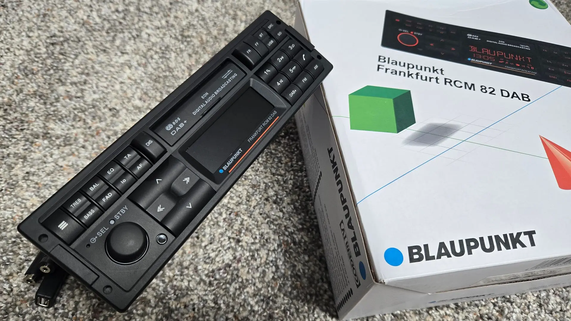

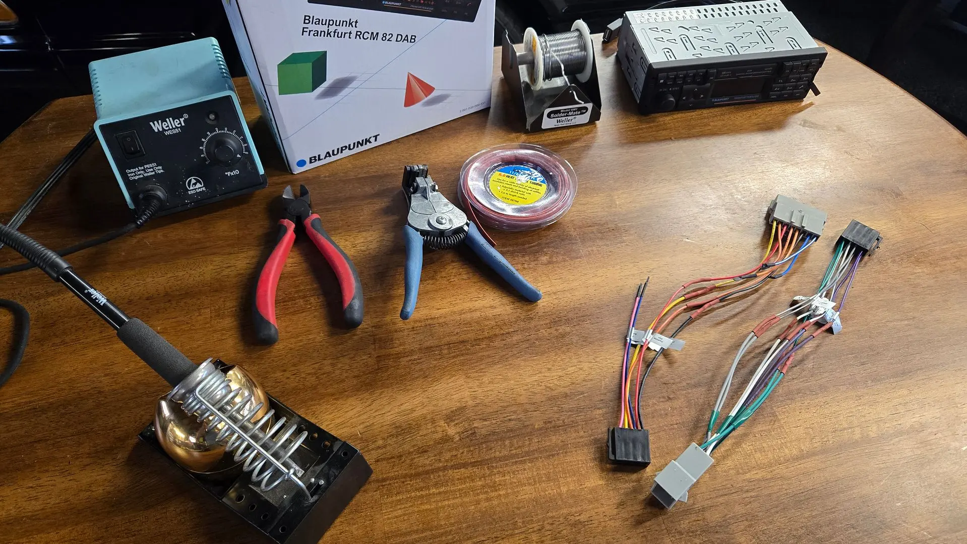

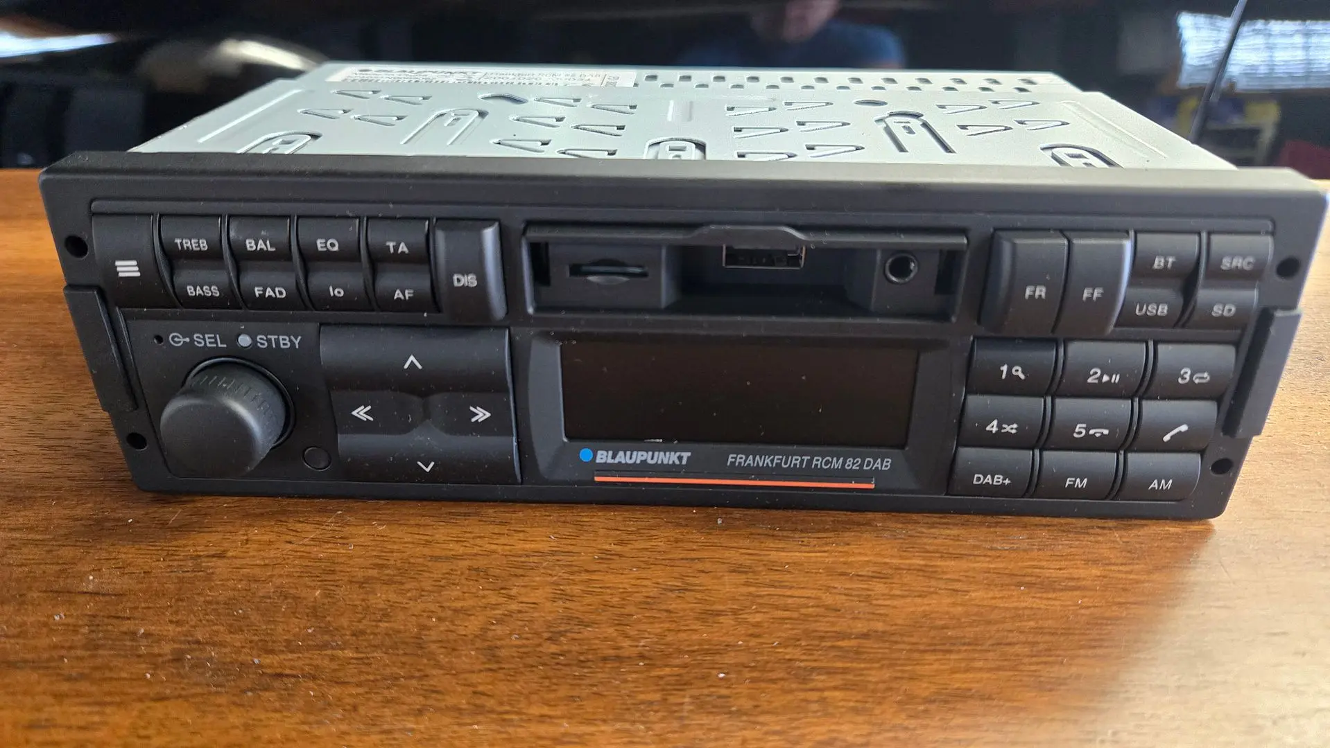

Its a Blaupunkt Frankfurt. It looks like a tape deck
But the little flapper opens up for USB and other connectivity. It's also Bluetooth which is the main reason to replace the factory one.

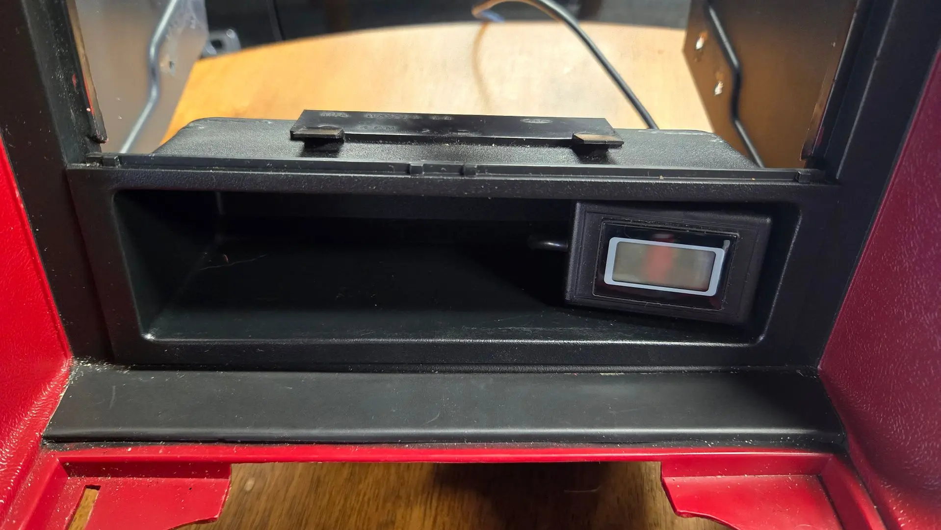

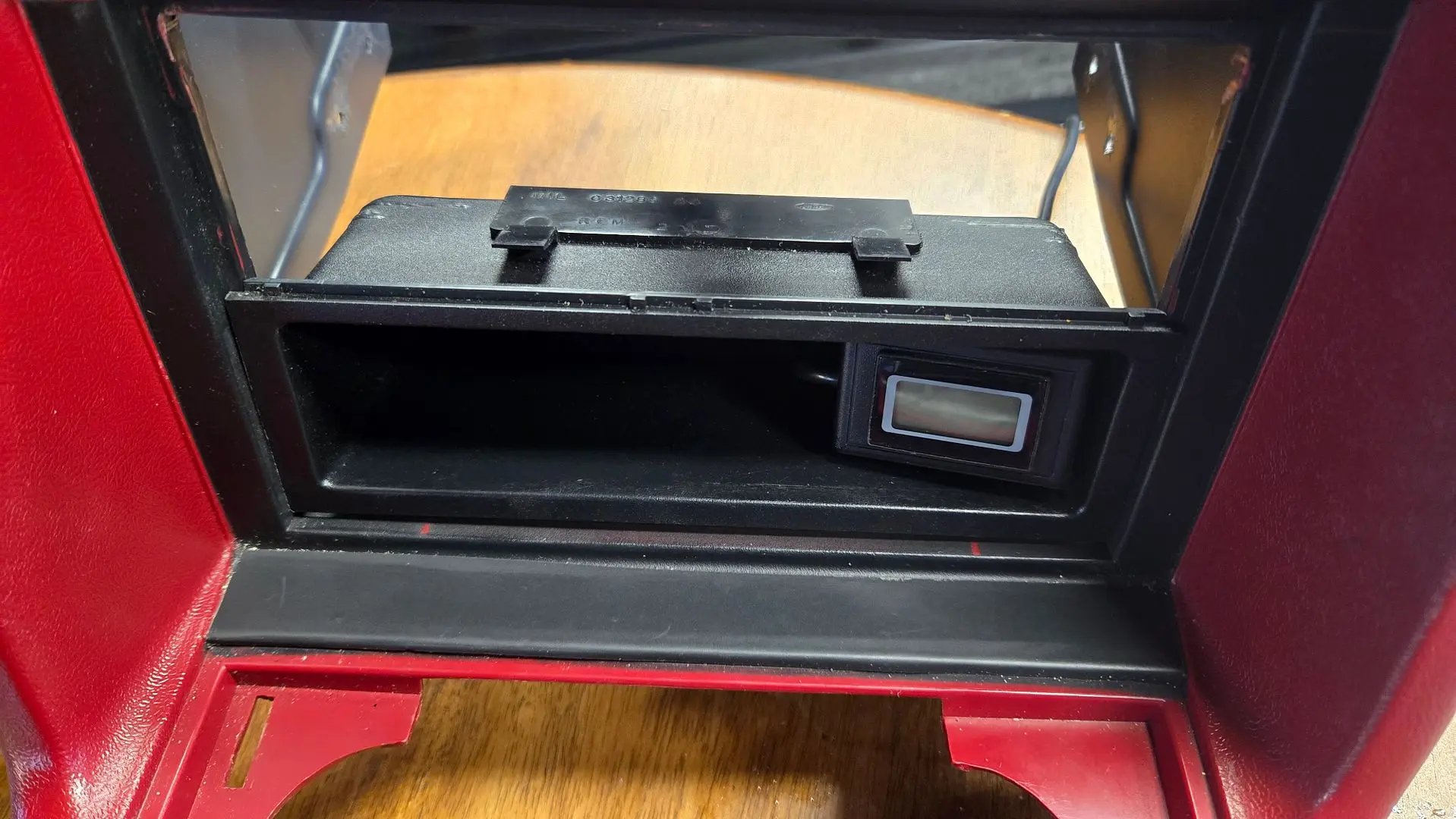

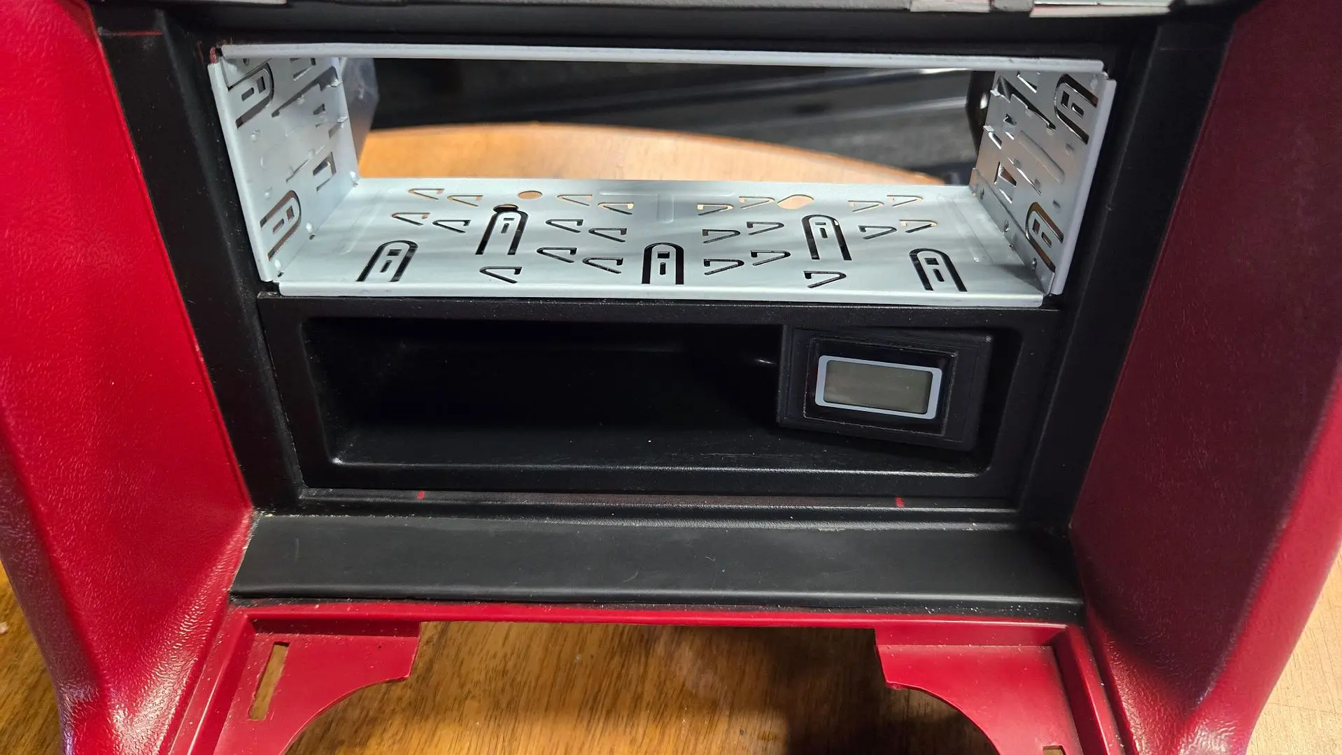

I don't want to use the typical mounting kit with exposed screws. So I'm going to make some brackets and do a little welding. I'm going to retain the little cubby, I have my FP guage mounted in it. The original radio and cubby don't sit flush with the console. Sits like this:
To get the new radio and cubby to look seamless the cubby needs to be recessed into the console a little. I used a file and sized the cubby so it sits into the console like this:
This is it with the radio sleeve slipped in. The bottom of the radio sleeve tucks nicely over the cubbys top lip. This is why I wanted to recess the cubby.
I'm going to make these two peices one peice much like the factory set up. That way it will all pull out for good access to my wideband controller and other wiring behind it. I have some parts coming for that, so I'll cover that next time.

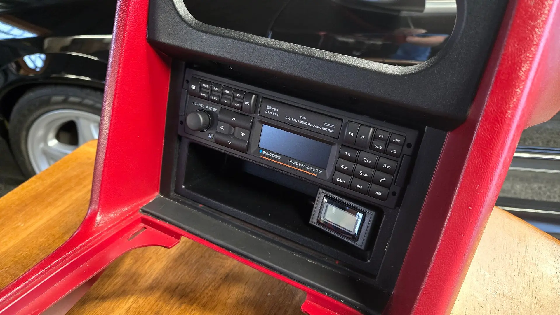

A little test fit. It will look like this when complete. I'll have to pick up some trim black to repaint the black portion of the cemter console, its got some scratches.

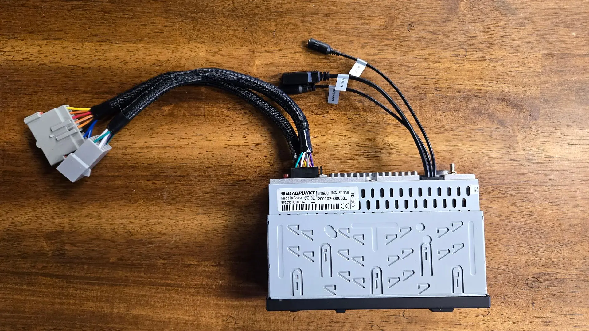

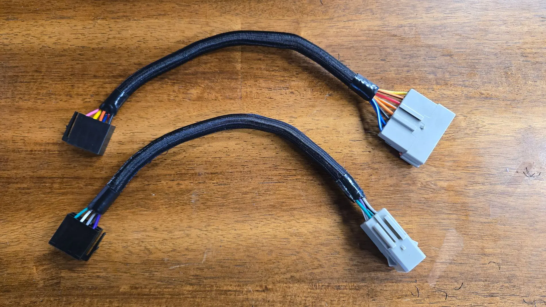

Did a little wiring. Soldered and shrink wrapped
Then some wire loom

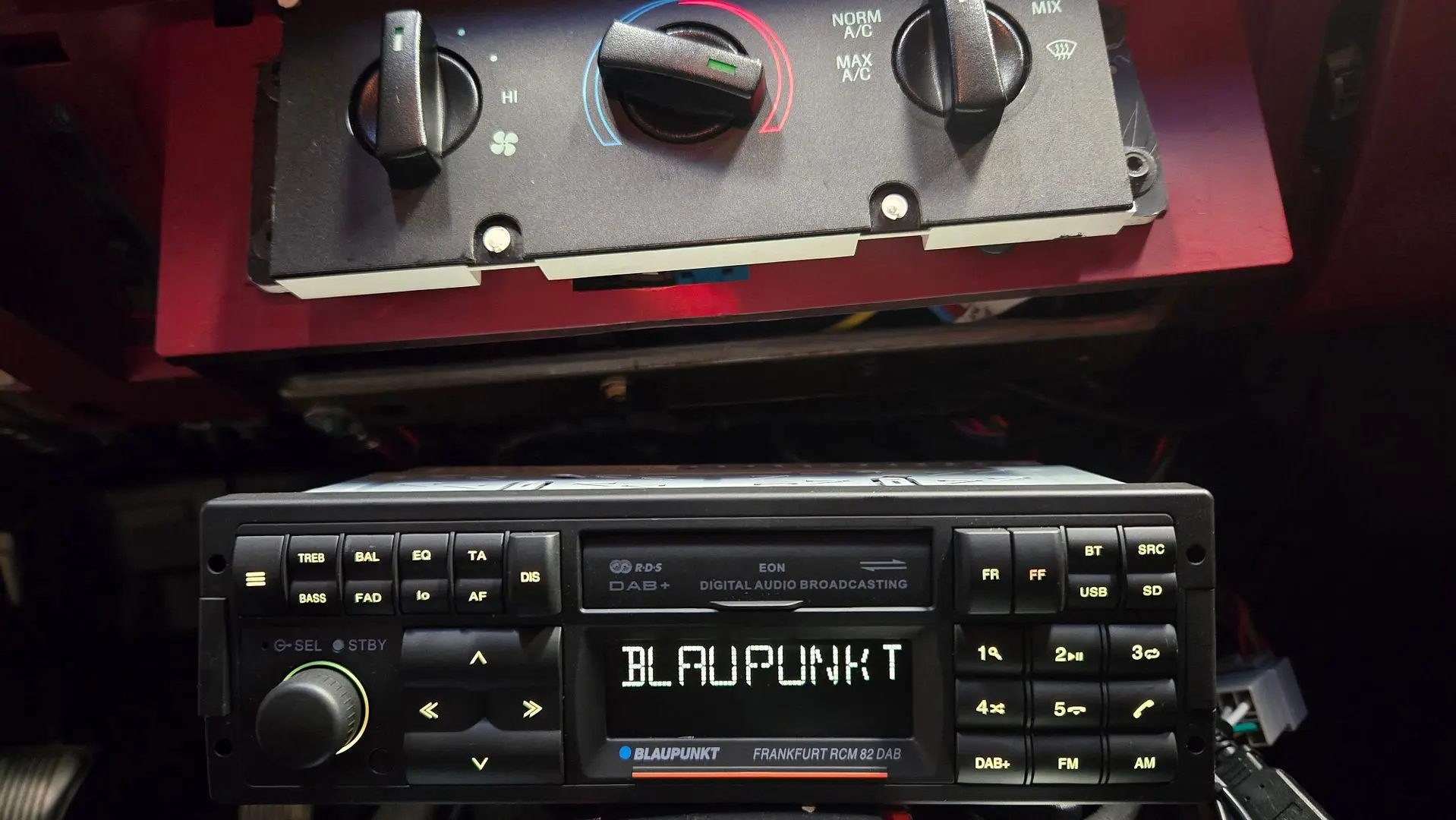

The display color can be customized to any shade. You can blend green and blue together to really dial it in. I'll match the green of the factory dash. This looks pretty close in person.
It sounds good! I have nice speakers in the dash, doors, and rear, so this really helped.
