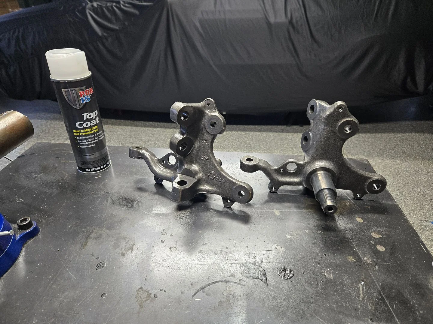

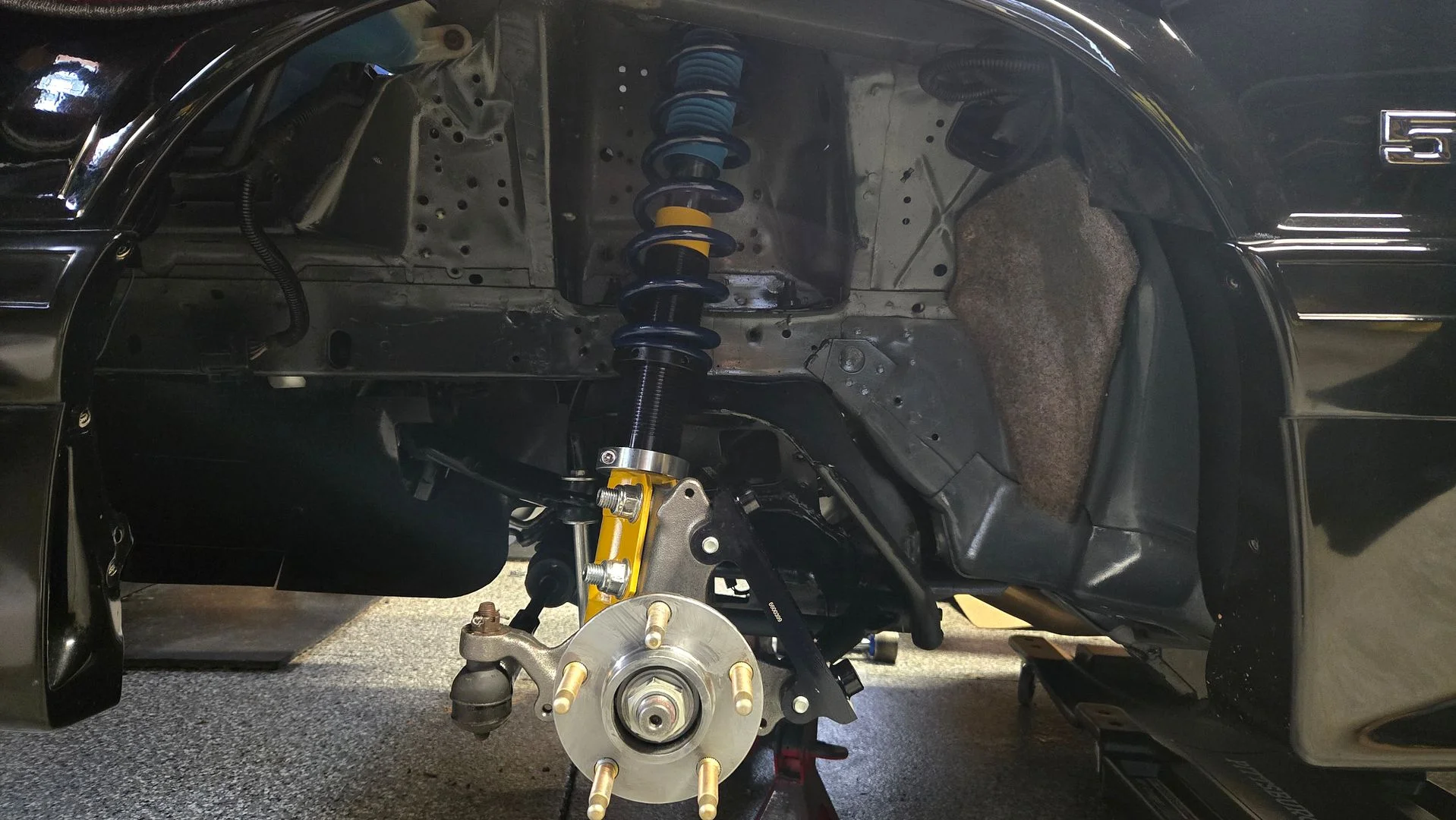

I restored some ebay 94 spindles a few pages back with Evaporust. To keep them looking good I hit them with some direct to metal clear top coat.

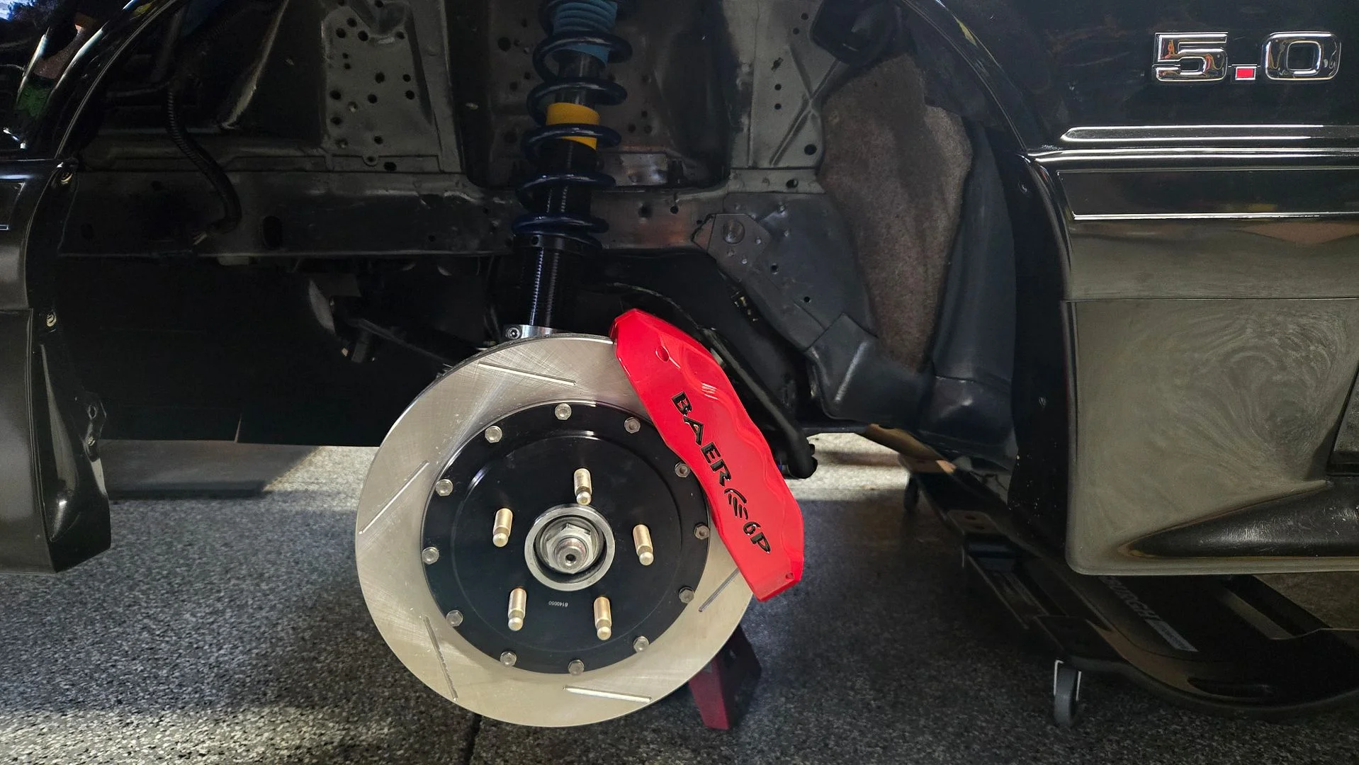

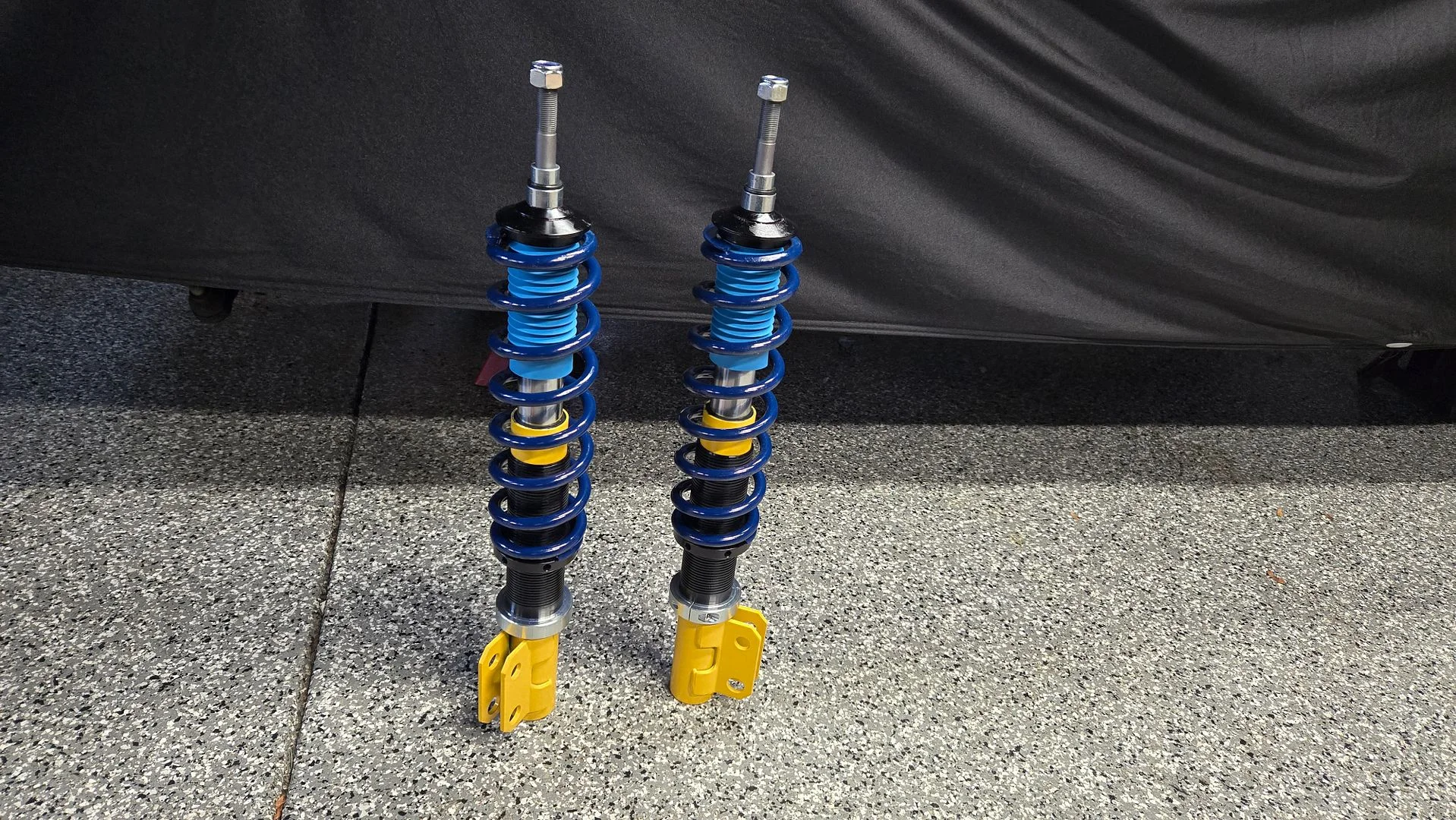

Got my coilovers assembled
Installed the MM control arms, spindles, hubs, and coilovers.
Fit the brakes in place
Next will be getting the booster / master finished and all the lines hooked up and bled.

Always top notch work!
What spring rate did you go with on the coilover setup?

Thanks!
I called MM and told them I wanted a nice riding and handling street car. A little less body roll preffered but not at the expense of a bone jarring rattle trap ride. They suggested the Hypercoil Coil Over Spring, 250 lb/in, 12", 2-1/2" dia. The rear springs are MM R&T, also what they suggested.
The control arms are MM non off set stock geometry which keeps the wheels centered in the wheel well when using a factory K member.
Reactions: gkomo and bird_dog0347

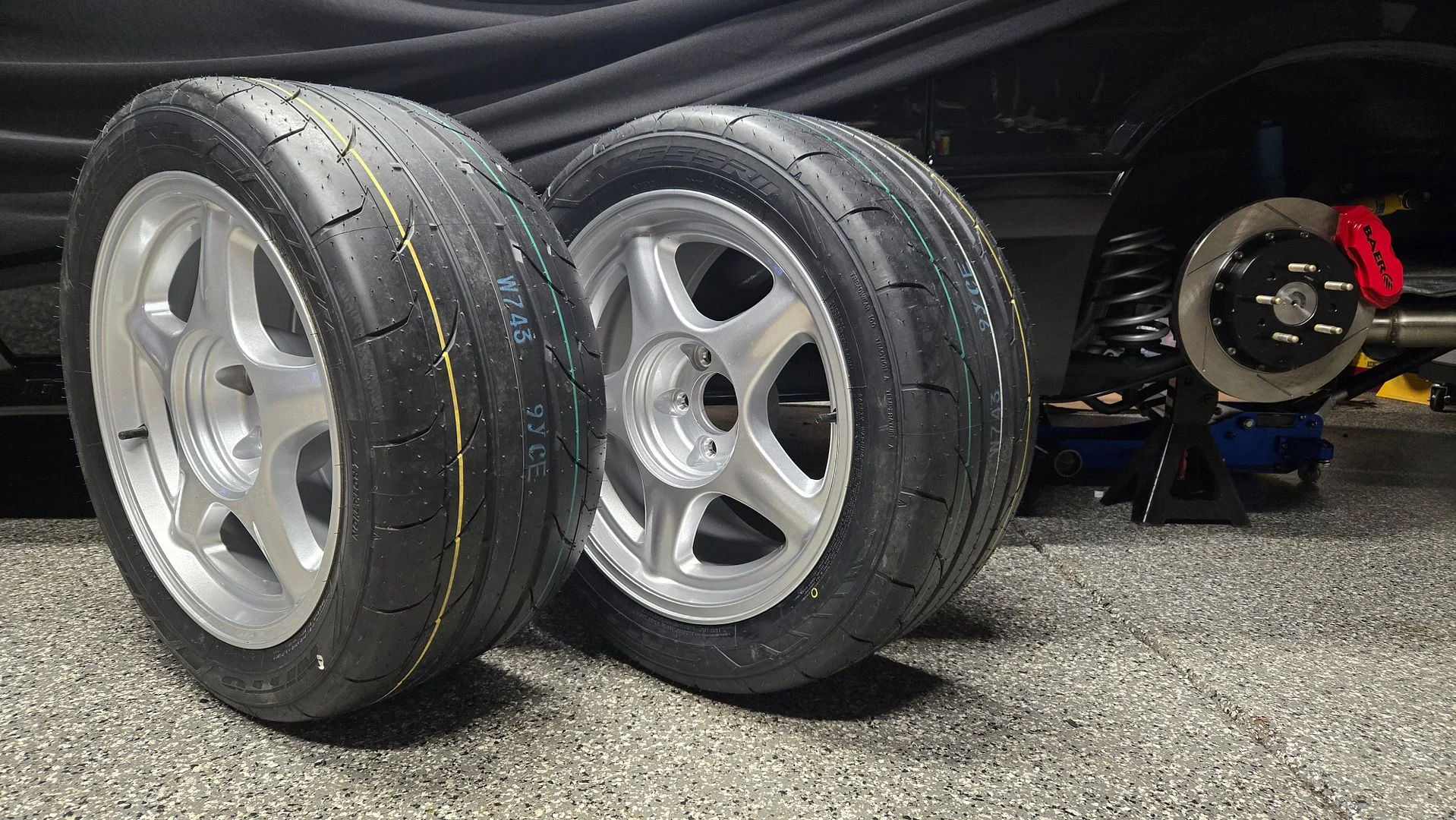

Got the Nitto Drag radials mounted up. Even in the frigid weather they feel sticky. So this should help. 275/40/17.

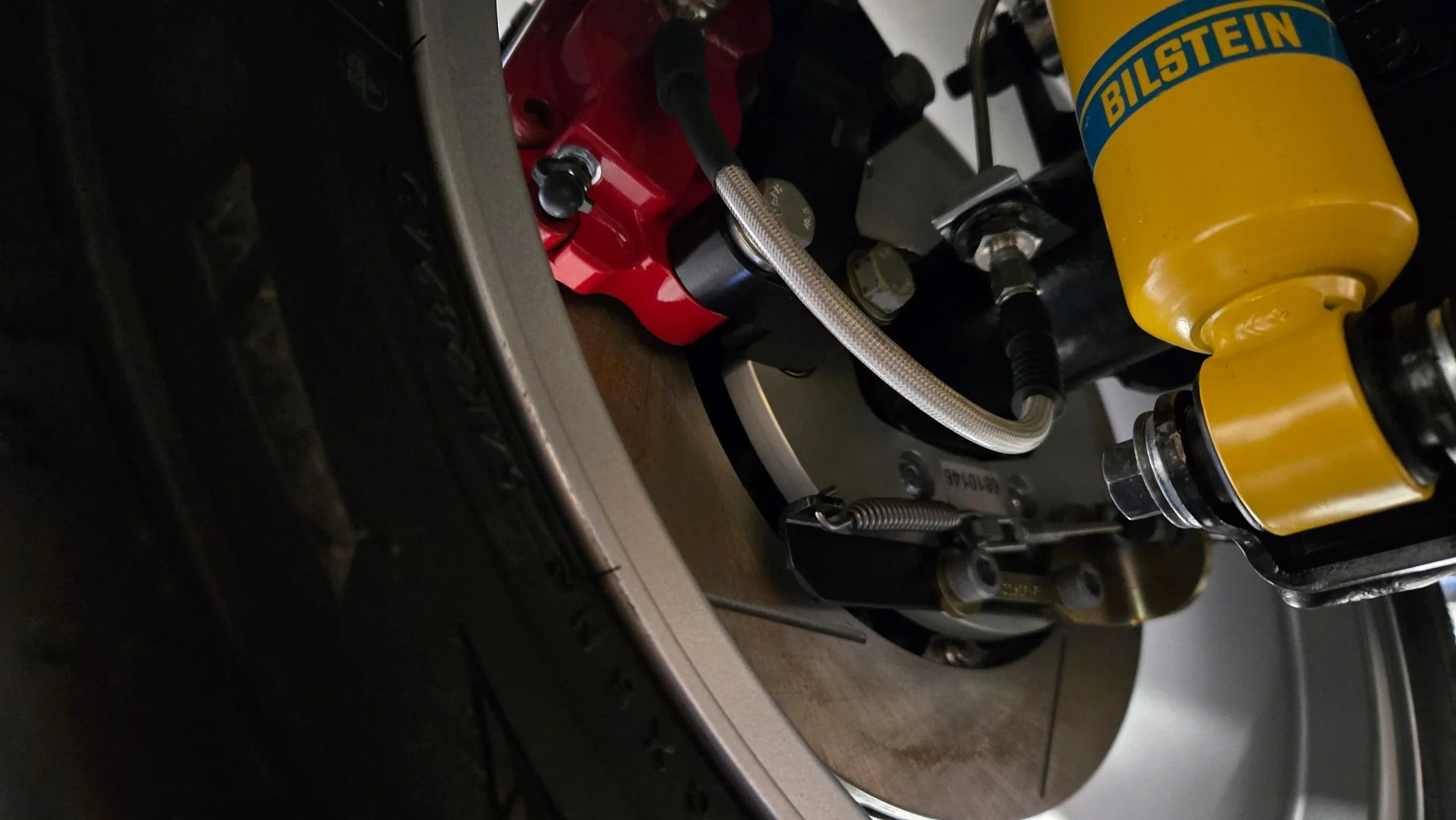

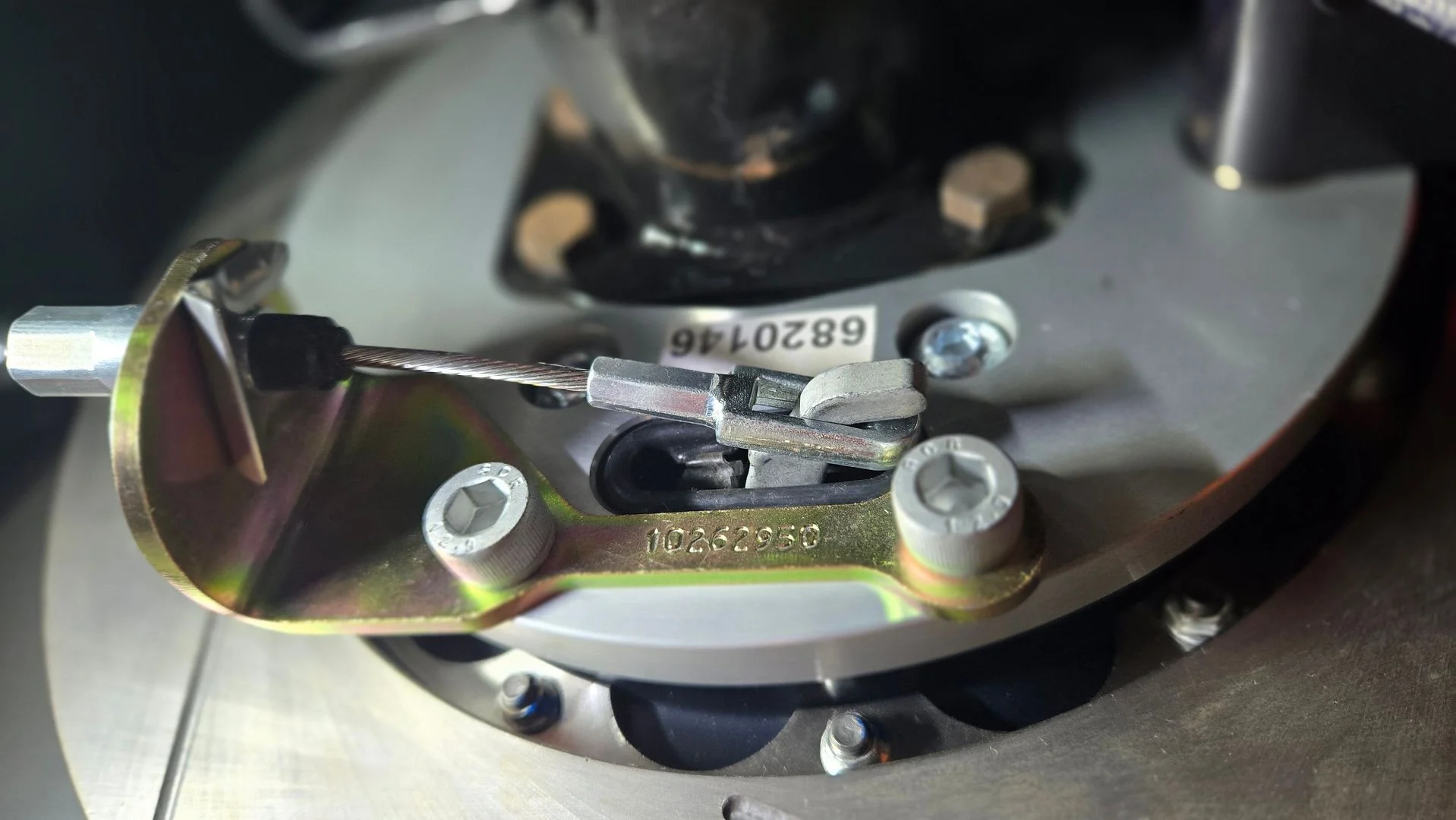

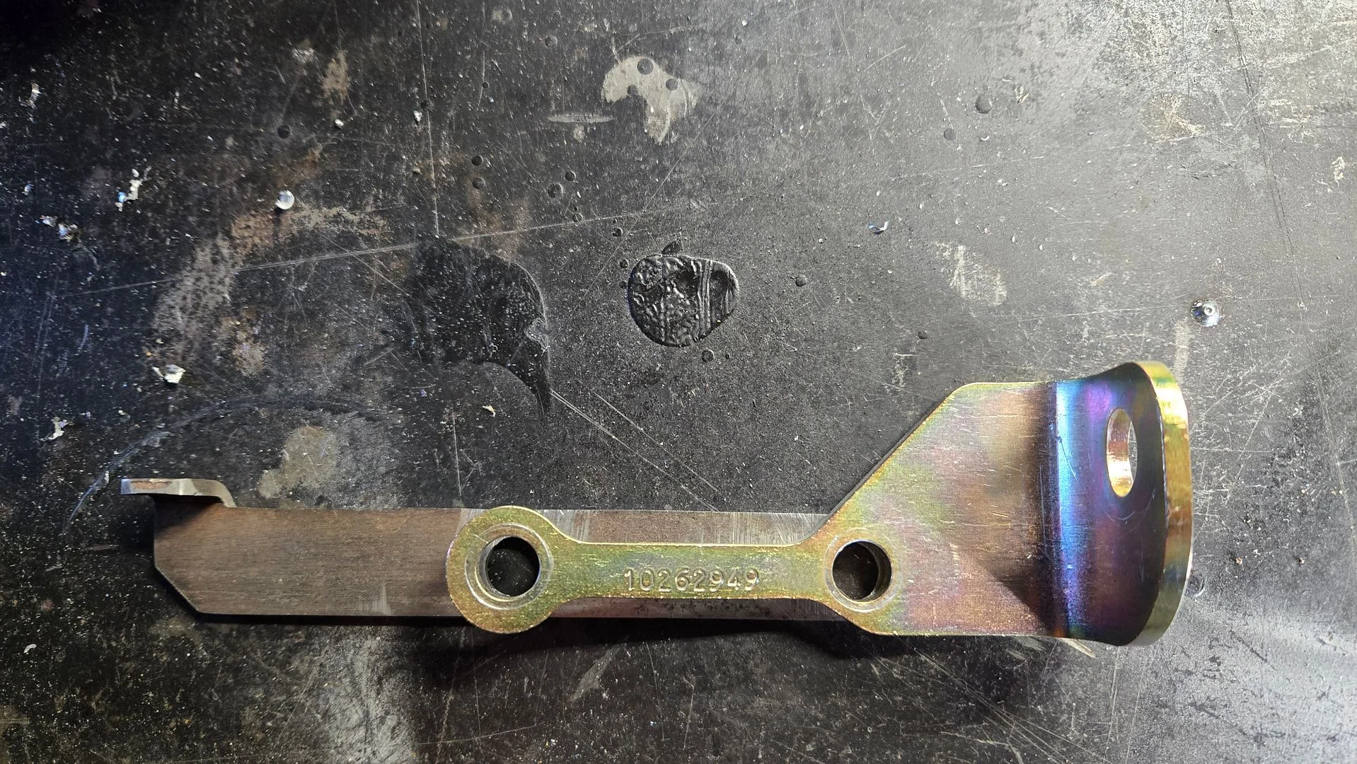

One thing about the e-brake setup on the Baer kit bugged me. On the stock Fox there is a spring in the e-brake handle assembly that keeps the cables pulled taunt to keep them from sagging and rattling around. To counteract that pressure so it is not activating the e-brakes there is a spring on the end of the cables behind the drum. That spring counteracts the pressure from the e-brake handle so the e brake doesn't drag.
The cables on the Baer kit had no such provision. What keeps the rear shoes retracted is the one peice shoe design, I put up a picture one page back It's intended to act like a spring itself. However when I pull and release the e-brake there is a slight bit of drag. I believe the force of the factory e-brake handle tension spring is overpowering the one peice shoe design to some degree. Is it okay? Not sure. But i had an idea to fix it so I went ahead and built a counteraction spring.
Here is what the Baer e brake setup looks like. The lever the e-brake cable is hooked to pulls a mechanical wheel cylinder to apply tension to the one peice shoe.

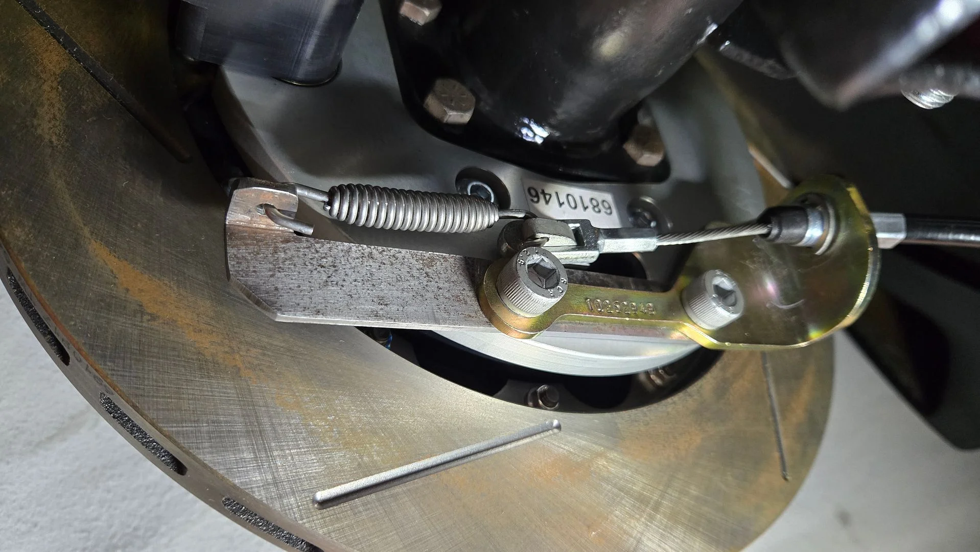

I wanted to add a spring to keep that lever pulled back when the e-brake is not applied similar to how the stock spring setup works. I re purposed some stainless steel springs. They are usually used to hold motorcycle exhausts together.

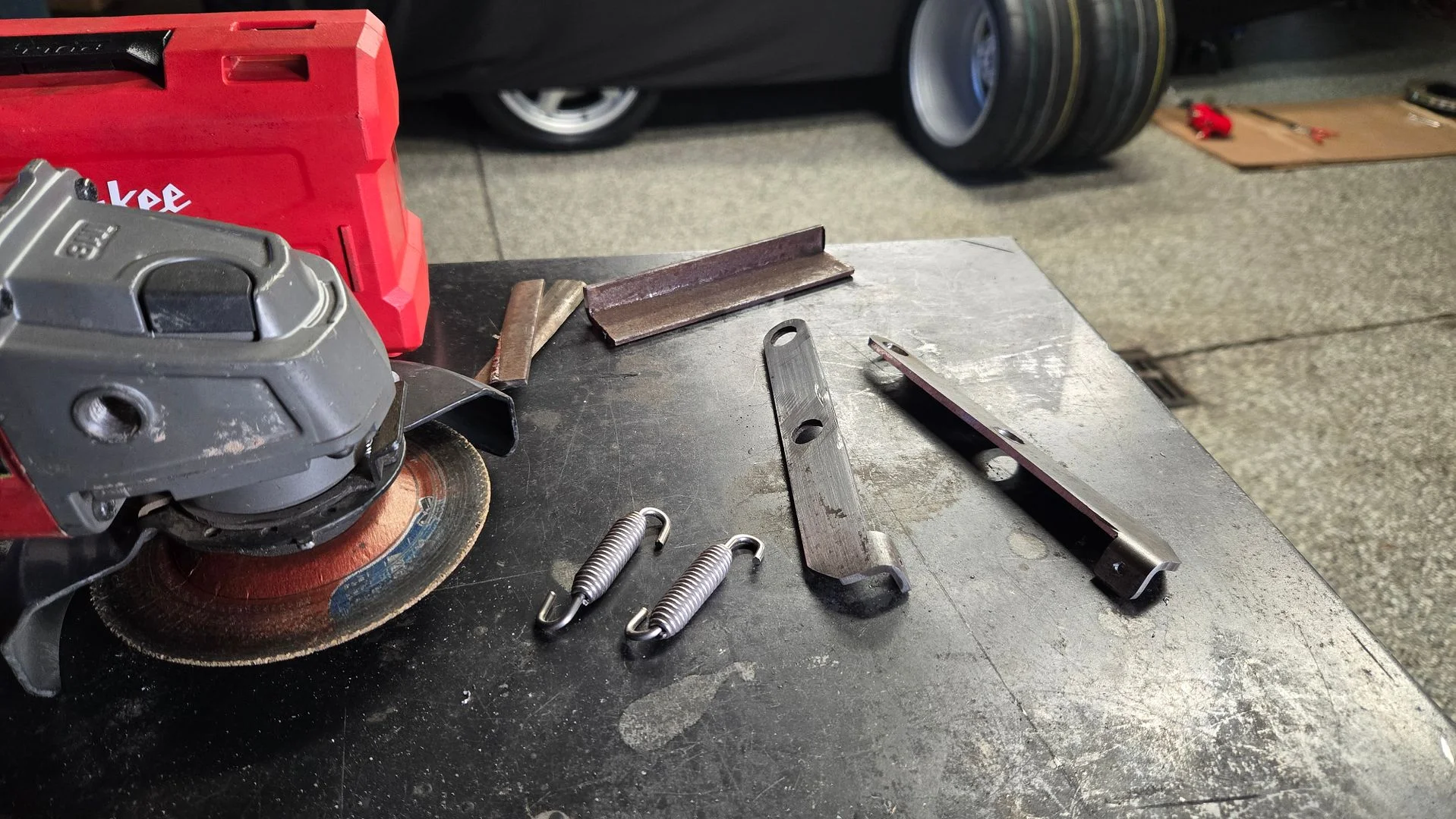

I made some brackets out of a peice of 1/8" steel L channel.
These will go between the gold e-brake cable bracket and backing plate using the same bolts.
Here is my bracket mocked up before paint. I drilled a hole in the actuator lever for the spring.
It works great.
Reactions: Snakbytn1990, Noobz347, bird_dog0347 and 2 others

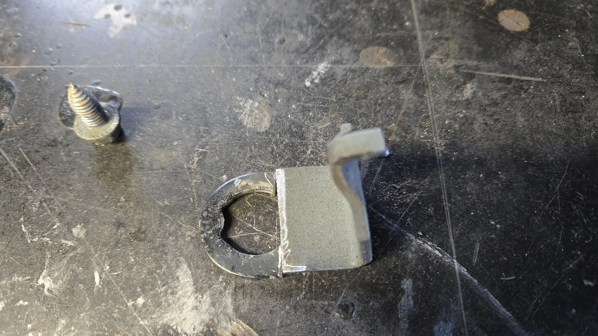

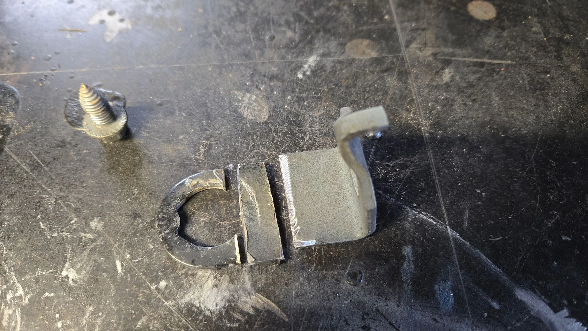

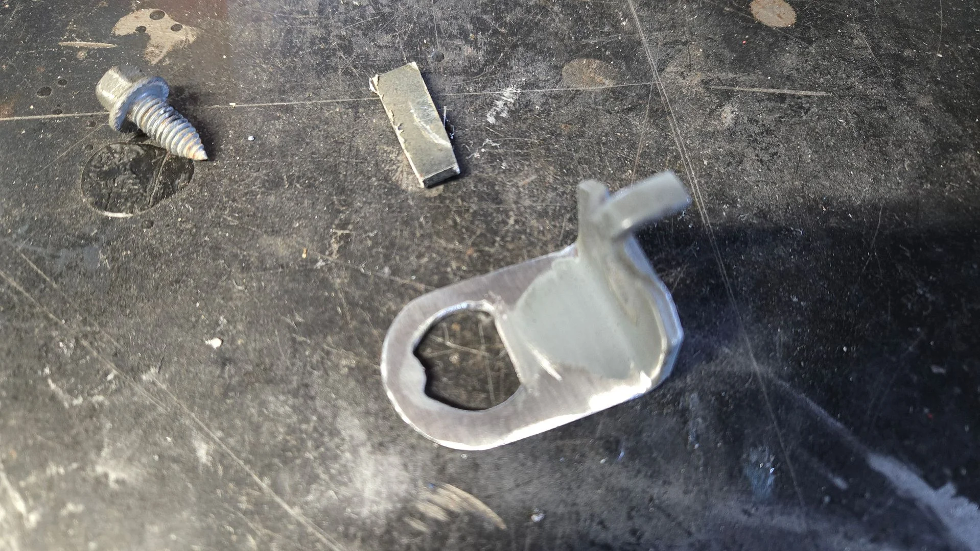

I finished up my e-brake counter balance spring and got everything final assembled. It works perfectly.

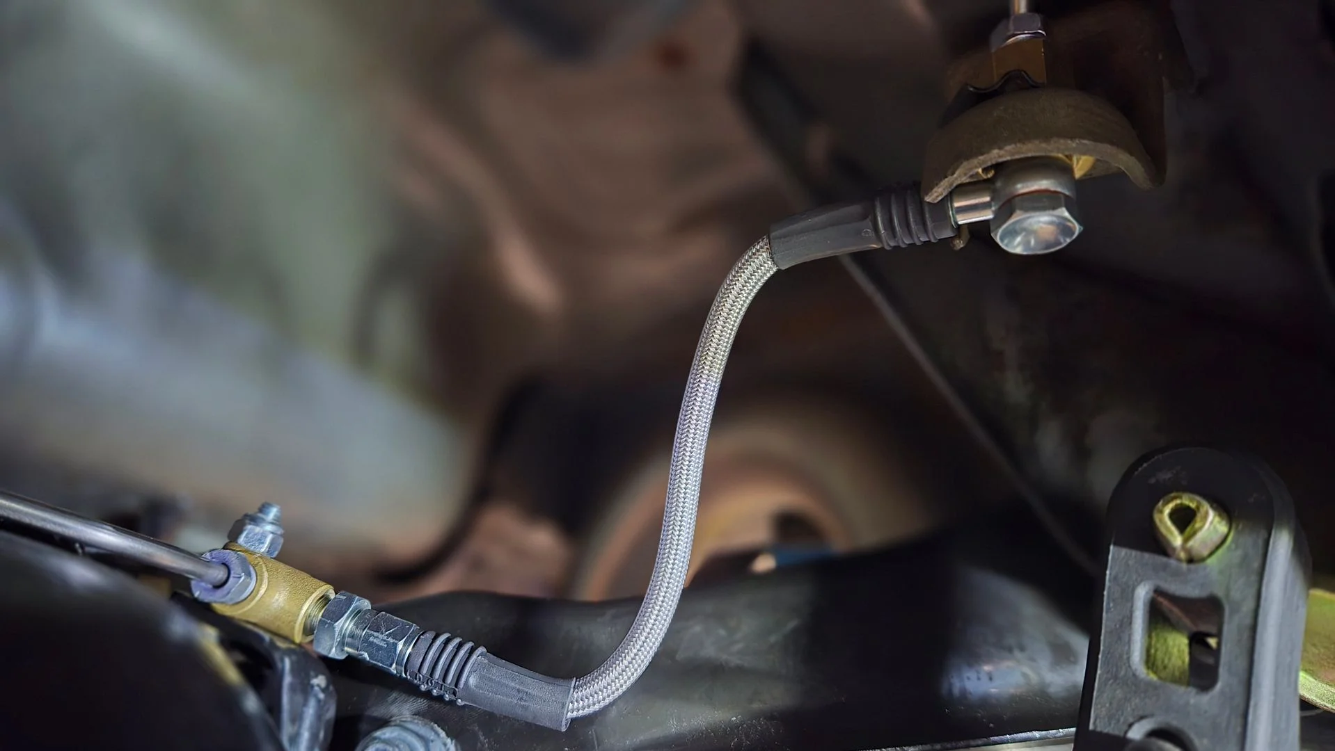

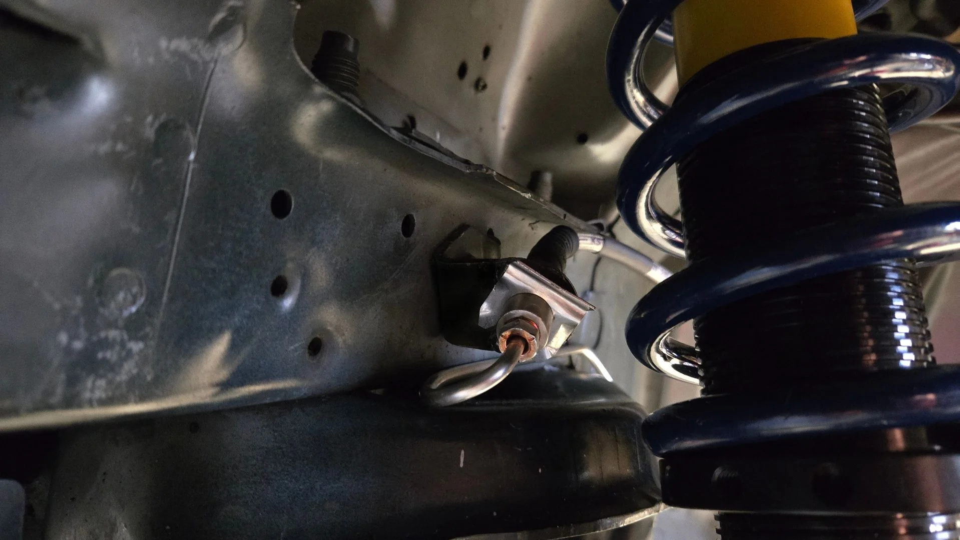

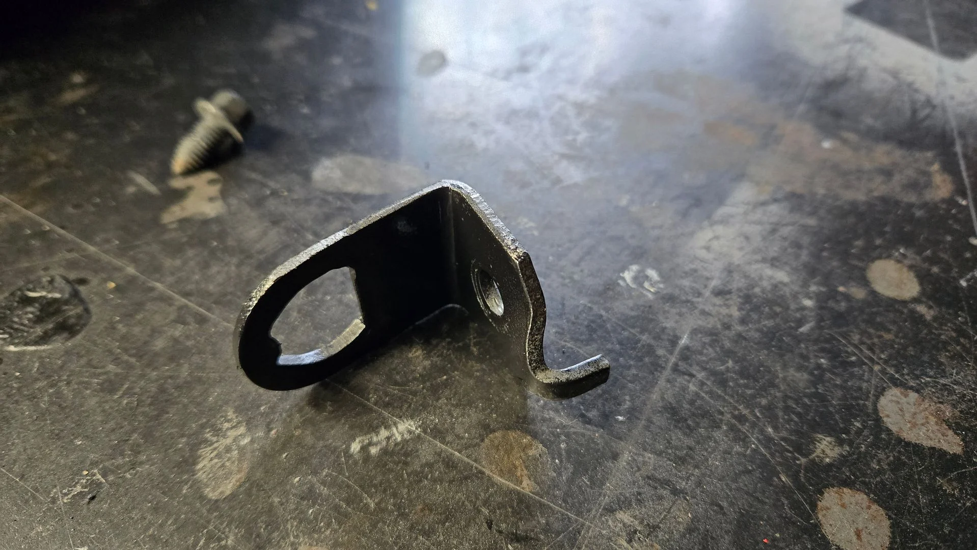

I worked on the front flex lines as well. The hardline to flex line coupler in the kit is for a 94+ Mustang and threaded for a 3/8" hardline fitting. The 90 Mustang has 7/16" hardline nuts so I ordered the correct 7/16"-3an fittings last weekend. When I assembled everything I found the factory bracket that secures the coupler was very close to the coilovers.
This is the factory bracket that secured the brake line.

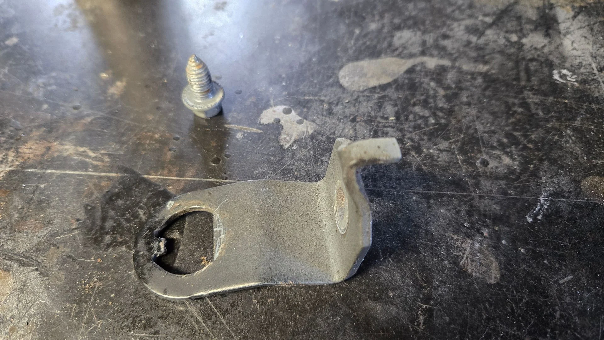

It needs to be shortend. I cut out about ½"
So it will fit together like this
Then I welded it together and ground it smooth
A little paint and I have a nice looking bracket
Now I have clearance between the brake line and spring on the coilovers. I did both sides the same.

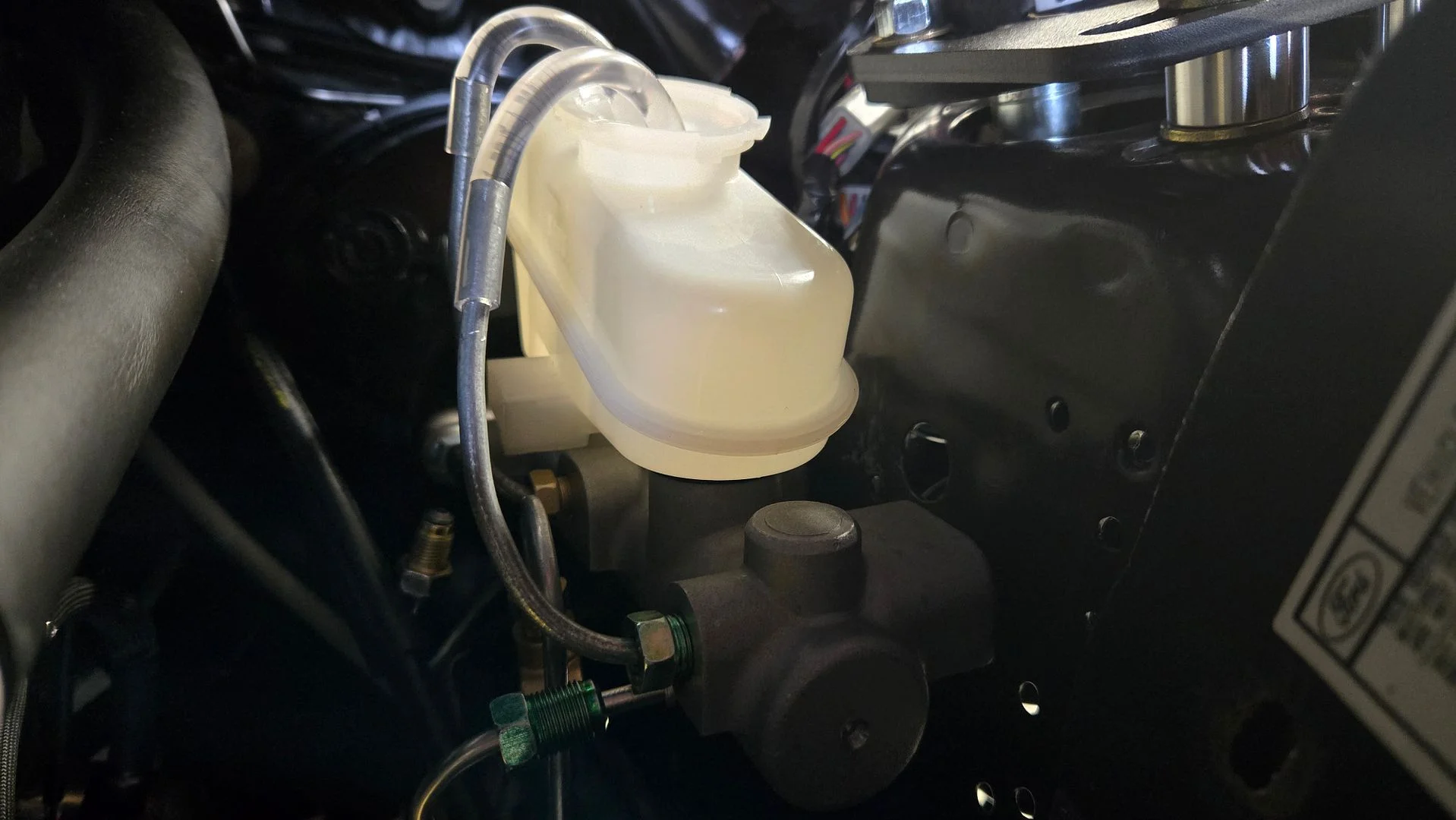

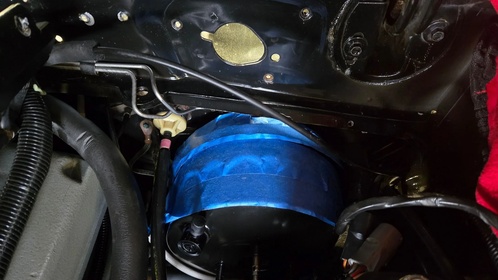

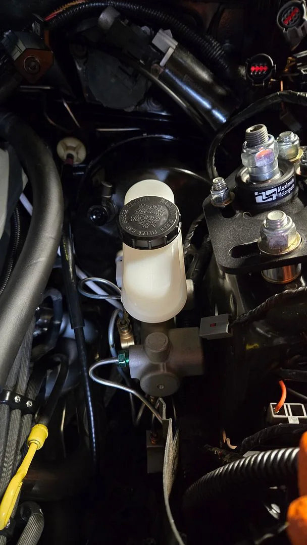

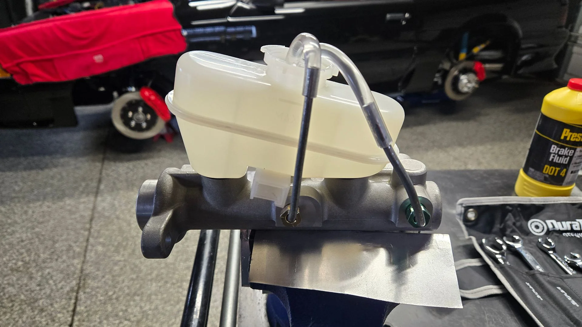

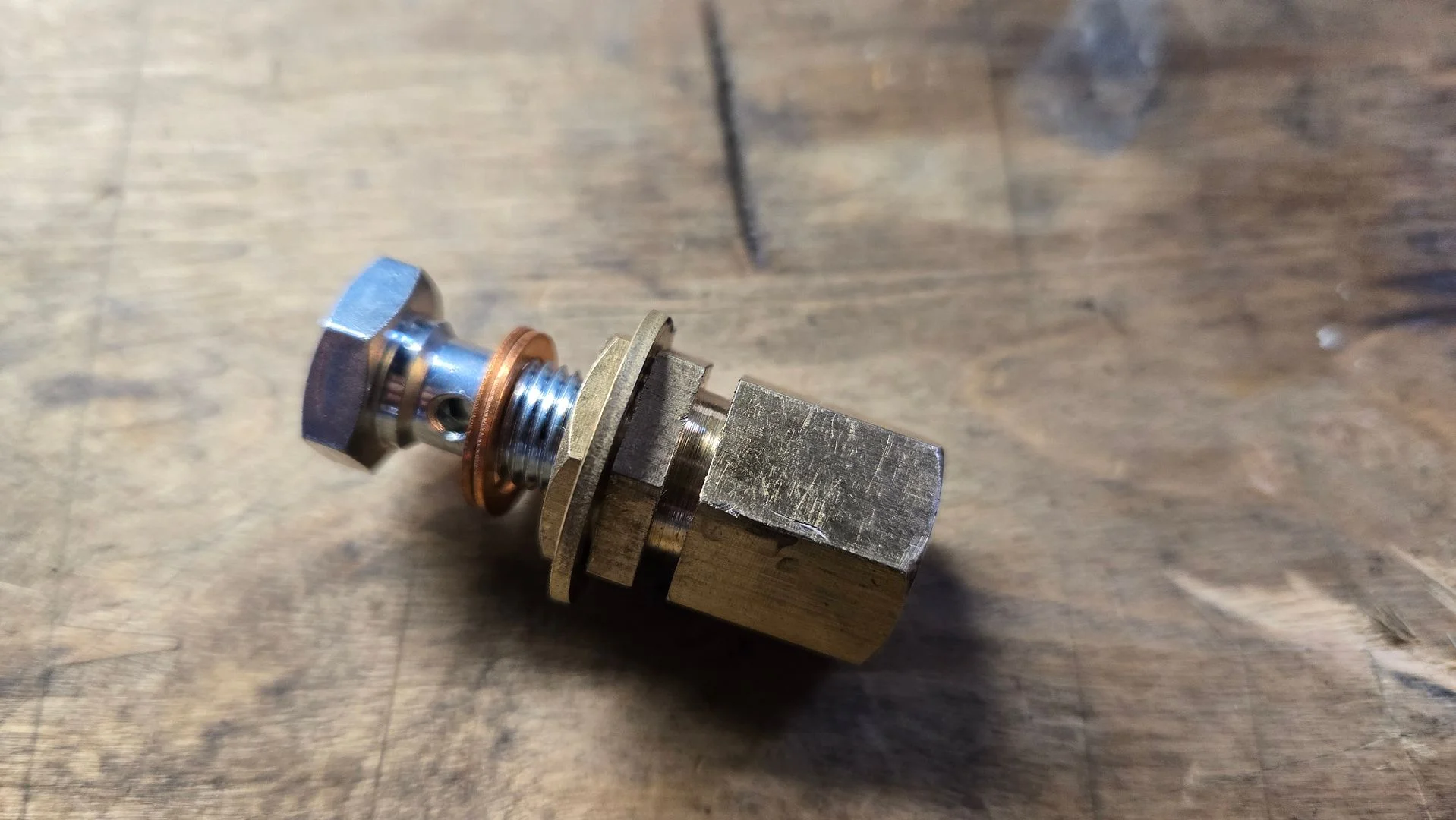

Today I installed the 93 Cobra booster. I've had it out on the bench for the last few weeks. I double checked the pushrod measurement and it was fine, so I went ahead with the install. My car is a 1990 and I've read horror stories about smashing the strut tower or needing to completely remove the pedal box. Before I did any of that I decided to just see how bad it was going to be. Well, it pushed right in with no drama. I put some painters tape on it to avoid any scratches.
Then I test fit the 1993 1" bore master and temporarily connected it. I wanted to make sure I have all the correct lines on hand.
I really wanted to get the master bench bled and bleed all the lines. But unfortunately i can't find the fitting that goes in the body side of the rear brake line above the axle. I have a sneaky suspicion I tossed it with the old rear brake line. So the final bleeding will have to wait until next weekend when the new one arrives. It will be nice to button up this phase so I can move on to the next one. I just don't want too many open items so I'll wait till it's complete.

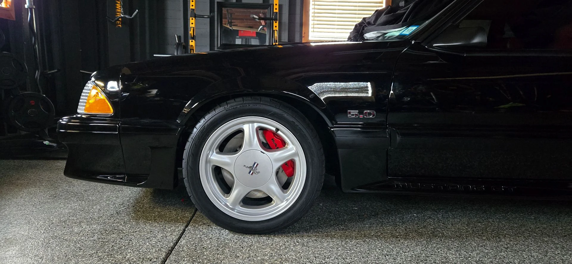

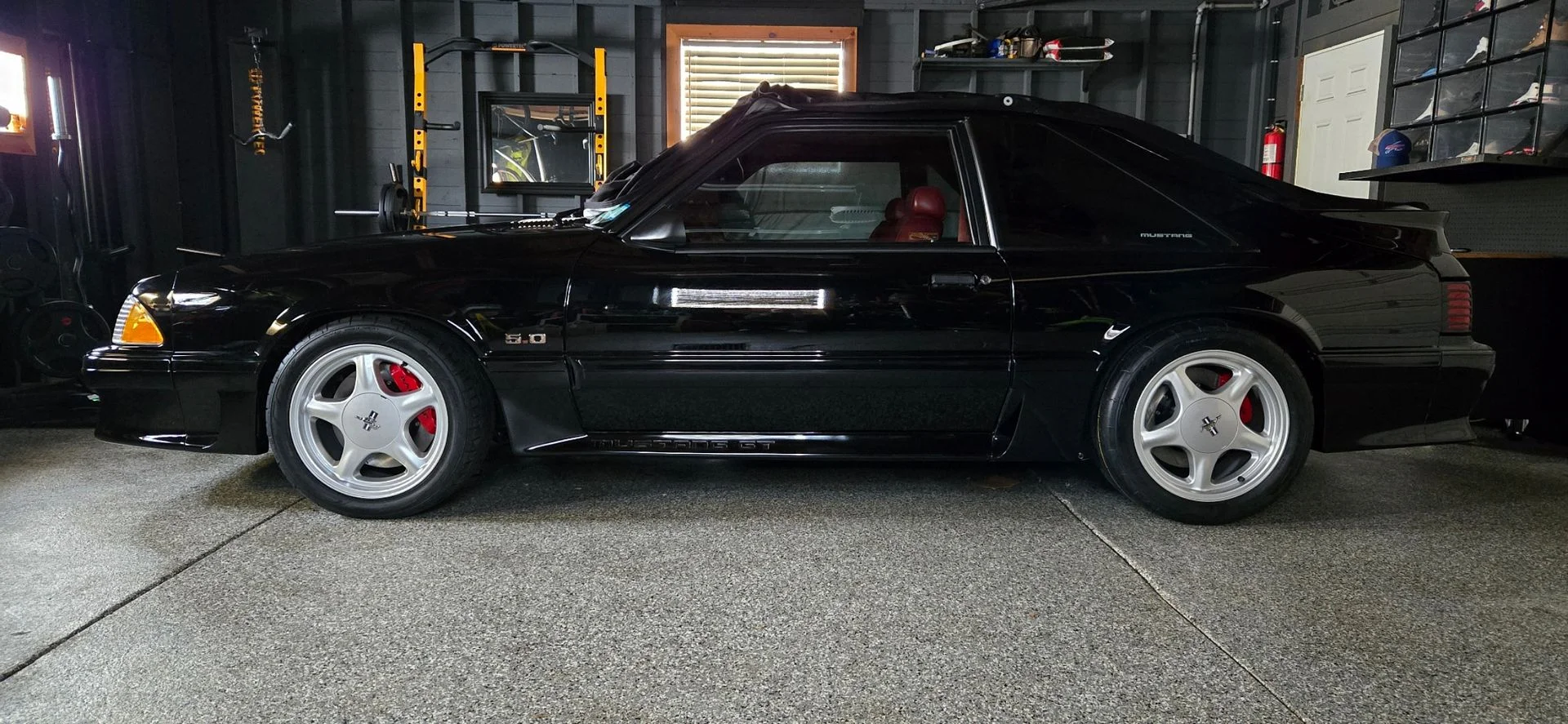

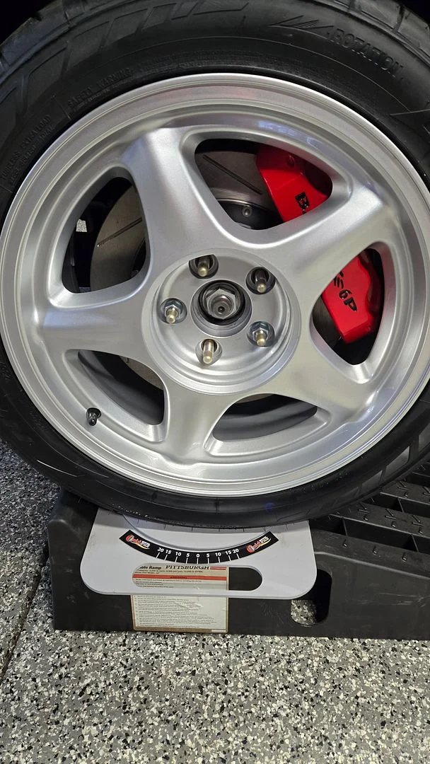

I like the big brakes lurking behind the Pony wheels. I went with 17×8 front wheels with 235/45/17 Nitto's. The rears were going to be 17×10 and I may go down that road at some point so I'm hanging on to them. But currently using 17×9 with 275/40/17 Nitto drag radials on the back.
Still playing around with the ride height.
You didn't have to slot any of the holes? It just plopped in, huh?

Yup. I was prepared for a fight from everything I read and it just fell in. I did chase the holes with a bit one size larger than the original holes. But no slotting or anything.
If I remember right, the whole [bang on the strut tower] thing was for 79-86. 87+ wasn't necessary but I [thought] they all still had to be slotted.
Something new (to me)
When I go to do my 86, I'm going to try and avoid the shock tower thingy if poss.

nicholase said:
Its probably good to have it all in one spot. Also some things changed since I did a partial parts list earlier. Here's a recap on the final parts that went in for the brakes and suspension:
-1993 Cobra booster (5.0 Resto)
-1993 Cobra master cylinder 1" bore. (New, from MM)
-MM 3 port to 2 port master line kit
-Replacement brake actuator lever bushing (LMR)
-Prop valve gutted, MM plug
-Wilwood rear proportioning valve
-All hard brake lines replaced with new stainless steel brake lines from Classic Tube
-Baer 3an stainless braided front brakes flex lines
-Earl's 7/16" to -3an fittings for front flex line to hard line junction
-MM stainless braided flex rear axle to body flex line
-Baer 6 piston front calipers 13" Pro+ rotors (kit for Sn95)
-Baer 4 piston rear calipers 13" Pro+ rotors (kit for Fox 8.8 c-clip axle)
-Baer banjo to 3an braided stainless flex lines rear caliper to axle
-Baer e brake cables
-SN95 spindles (1994)
-Motorcraft hubs
-ARP wheel studs
-MM front lower control arms, non offset stock geometry
-MM front control arm urethane bushings
-MM front coilovers w/ hypercoil 250# springs on Bilstiens
-MM caster camber plates
-Bilstein rear shocks
-Bilstien quad shocks
-MM sport adjustable perch rear lower control arms
-MM rear upper stamped control arms
-MM axle side bushings
-MM rear R&T springs
-All new bolts for struts, front control arms, rear control arms, shocks and quads from LMR
-Moser fox length SN95 flange axles
-Ford Performance carbon trak lok kit
-Mobile 1 synthetic 75w/140 (3 quarts)
-Ford performance rear end cover girdle
-17x8 Pony wheels 235/44/17 Nitto NT555 G2
-17×9 Pony wheels 275/40/17 Nitto NT555 R2 DR
Original brake pedal and pad lol
Just a bit over 60,000.
All for 225 HP and 300 ft/lbs of tq.

I mentioned losing the rear body side brake fitting. The new one showed up. This is the little thing that kept me from getting my brakes done last weekend. I'll probably find the one I lost tomorrow.
Got it installed to the MM braided line.
To check my front flex lines and clearances at ride height I set the front tires on my Quick Trick bearing plates.
They are from my home alignmemt kit. This let me turn the wheel lock to lock and look around good for rubbing or interference. I did make a few tweaks to the lines.
Then I bench bled the master
And mounted it in the car
Then hooked up all the lines, put a wrench on every fitting one last time and bled the brakes. It's feels good to wrap up one of the phases! Suspension and brakes are complete.... at least for this year

Damn good work! What’s the status of the shortblock? Is it already done or just leaving it as is? Are you doing the top end kit yourself?
I really dig the big brake kit (those brake calipers look so good).
