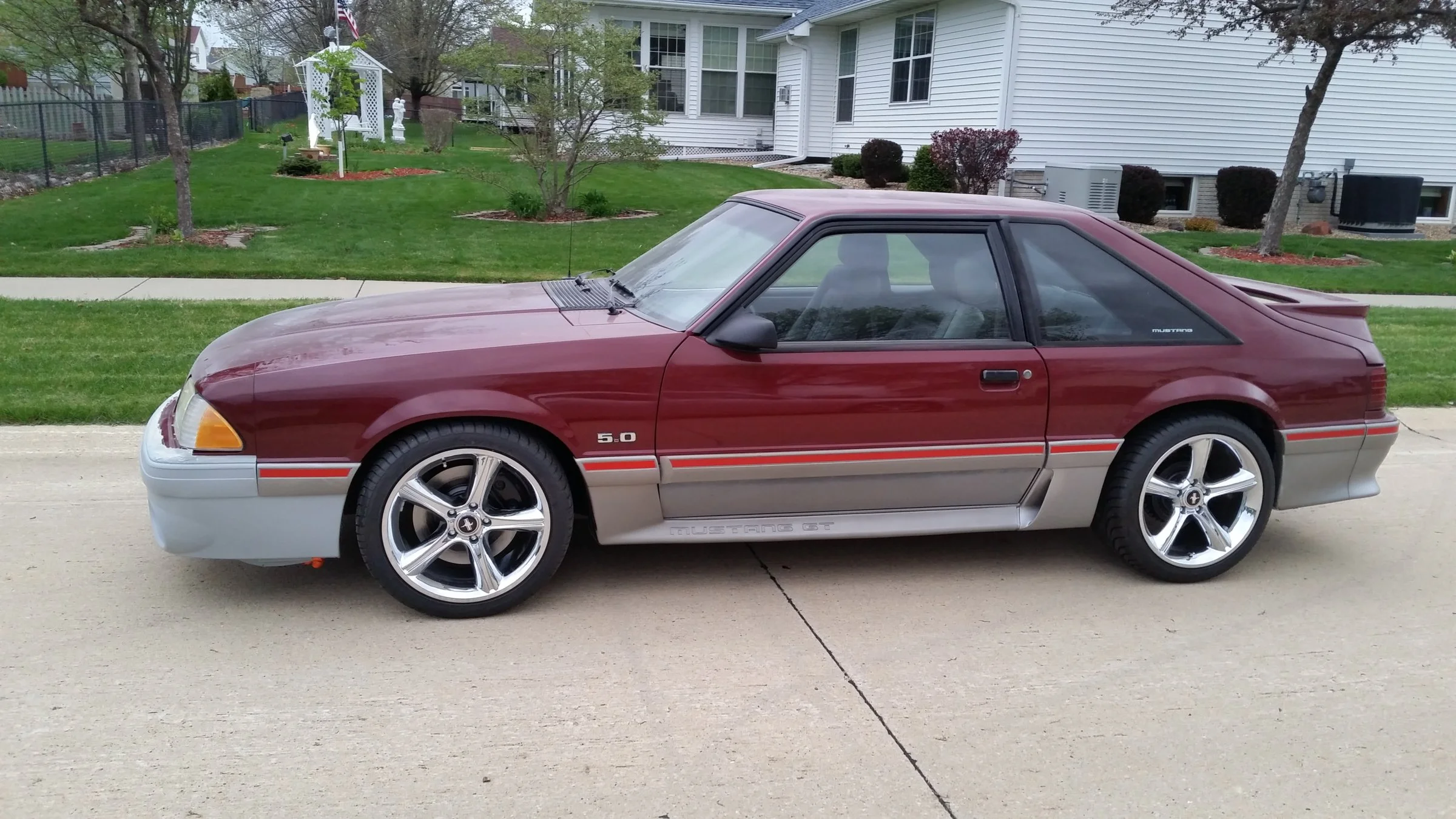

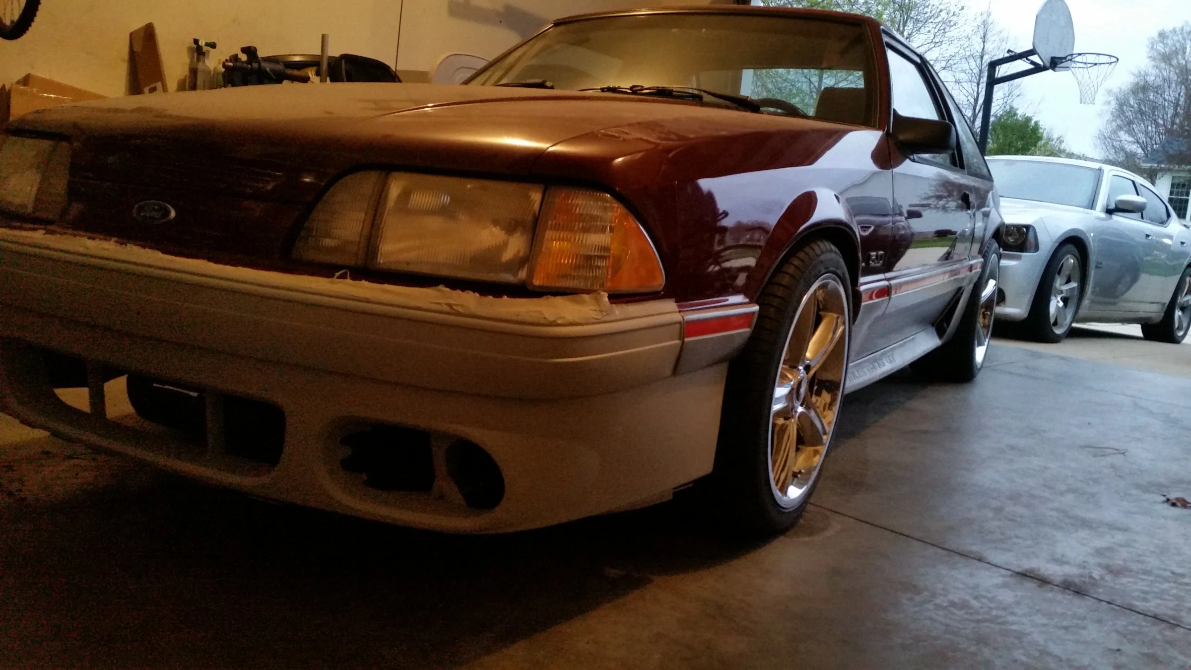

Random real update. I finally fitted the nose back on the car. These things dont really fit worth a shyt, do they? I got it decently lined up, and only have minor tweaks to make down at the bottom of the Cobra lower bumper. Sanding the body line off the side of the Cobra bumper left it thin, and you can see a line where it shows. Gotta add some PBA on the back of the bumper, and probably a little filler to the outside. Then I will sand the rest of the silver on the car, tape it off and spray it all.

I know it seems like I like everything people do here. So let me say this Nick I REALLY like that look!
Got me thinking of screwing up my already painted blue bumper.......

Thanks Dave. I think Im going to like the finished product as well. Wasnt sure at first, and still have some tweaks to make, but its coming along well.

what's not to like? That looks better than any version the factory originally installed, and it finally carries the same skirt height (off of the road) that the rest of the car has.

That looks really good. Excellent decision to maintain the separation with the molding. I can't even see the difference in the curve radius when it's installed. That's going to look amazing once it's painted. Excellent work!

I like those attributes that you pointed out, but I need to get the sides of it in check. It bows out at the bottom in front of the tires. I need to make some brackets to attach it to the fender down there, as well as trim the underside of the bumper to relieve some binding. Then the shape should come out nicely. Still not sure about attaching the lip. That will make it an inch or so lower than the rest of the car to the road. When I put the bumpers together, I didnt think I'd use the lip, so I didnt accommodate for it.

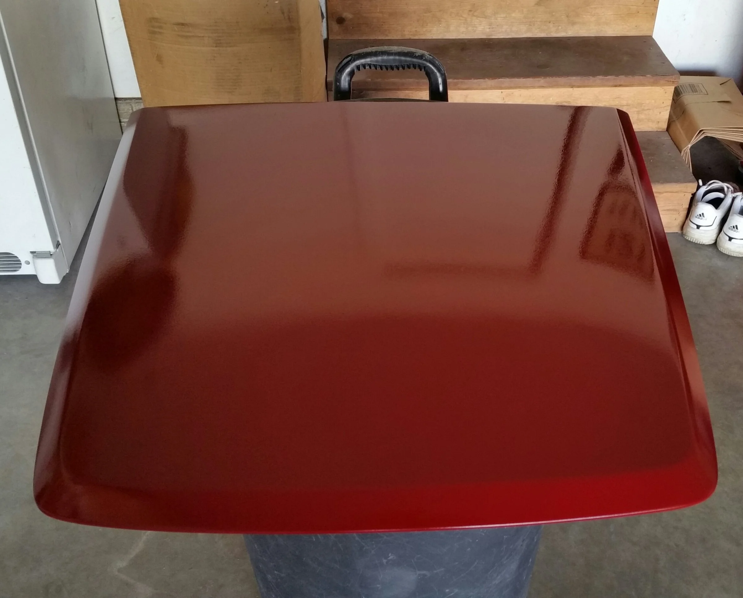

I am no @Davedacarpainter , but I used some duplicolor "perfect match" paint along with their clear coat and painted my '83 scoop just now. Of course mine has some bugs on it that his doesnt, but one day he will paint my whole car, so its good enough for now.
Not sure if I will get the silver lower portion of the car painted this weekend or not. I have a rear bumper project to do first, so we'll see.
Looks good in pictures.
Be advised though. Perfect Match is lacquer paint. Keep solvents away from it...it wont like that if that happens.

I know so little about paint that I assumed any solvent on any paint is bad, so I think I am good as far as that goes.
Just got the yard mowed, and weeds sprayed. I think I am going to go start marking, taping, and cutting, but not before I enjoy a cold one. As far as Im concerned, that is a must after mowing.

My hood scoop is not very glossy and kinda orange peely (just sitting on the dusty hood atm). Gonna have to try some super fine grit on it, and polish it. Still havent tweaked the front bumper into place yet, but I only have so much time with the newborn. We are slowly getting there fellas!
