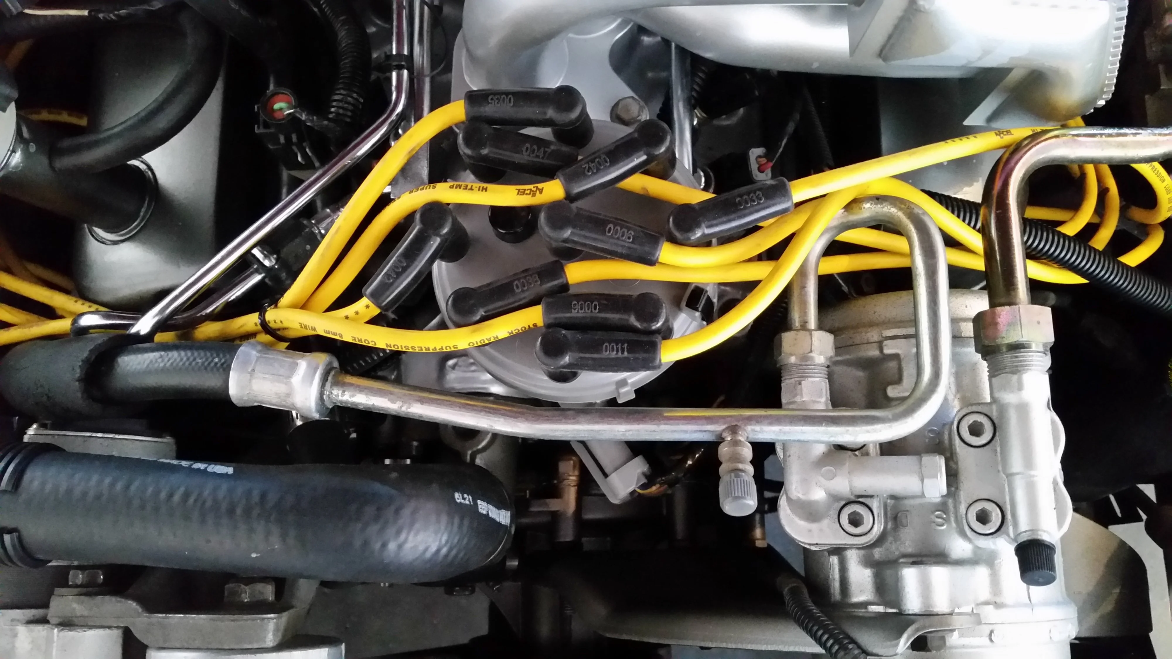

Show a pic of the distributor too, straight downon the top

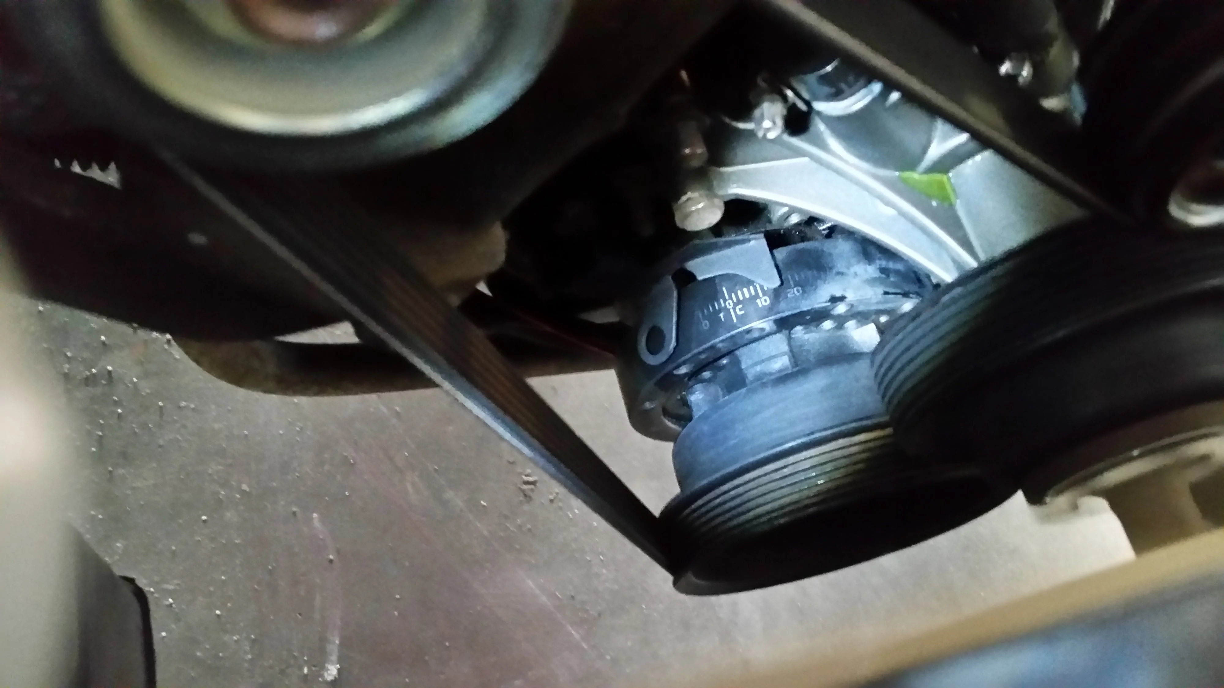

Set it by the tip, with the spout pulled out. Ignore the circle. It's for an obsolete timing device
Right now you are at 44 degrees of timing. Should be 10-14

Barely runs at 14. But when I go a tooth forward on the distributor, the car wont start. Thinking I went the wrong way, I went two teeth back, and it also wouldnt start. When I put it back in the middle, it starts, idles like it has been, but runs and revs and shows 40+ degrees. Im starting to hate this car.

Whenever I have timing issues I take a deep breath, and start basic, roll it over to the #1 compression stroke, with the pointer on the balancer at 0 and the rotor pointing at #1. Make sure my wires are right and fire it up, with the spout out set timing to 12 with a timing light, shut it off put spout back, happy motoring (hopefully)
Now I know that you know all that, but why does it run at 40* and not 14*, when bring #1to compression is the pointer at 0 or darn close on the balancer

Well, I'll tell you. I moved the pointer ahead one tooth, but left the housing advanced where it had been. That is why the car wouldnt start. When I twisted the housing back, it started. I now am reading 16* (felt better than 14* driving), and have the distributor on the right damned tooth.

One tooth forward or back makes no difference. You just spin the dist to compensate. In theory if the intake wasn't in the way you could just stab the dist anywhere and rotate the housing until it starts abs then time it from there.,
Did you ever pull the timing cover? I wonder if the cam wasn't installed or degreed correctly
