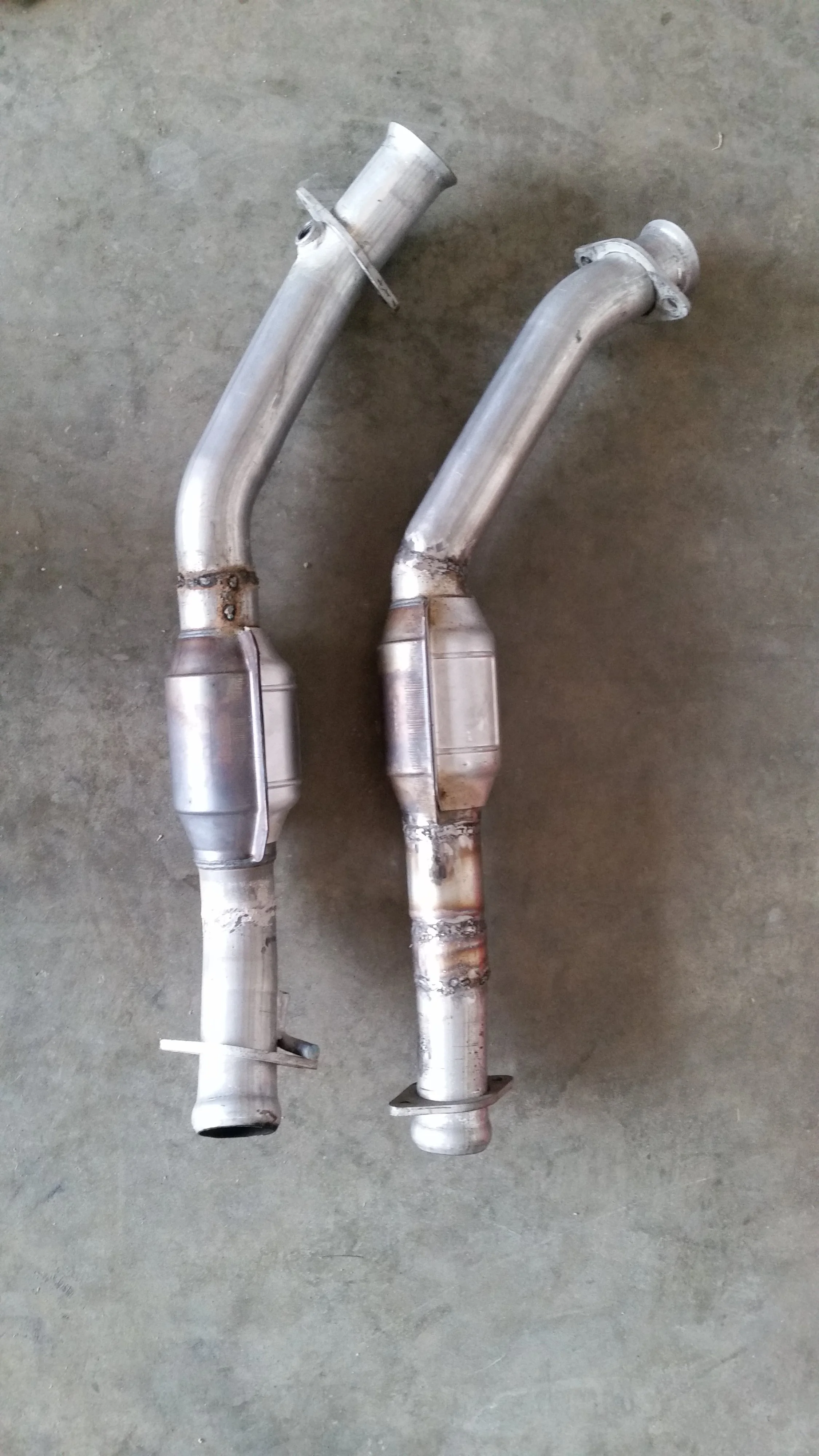

I got a little chore done today. I redid the driver's side catalytic convertor, and then welded both sides fully. They are currently off the car for some more grinding and high temp paint. It aint pretty, but it fits tight and is no longer upside down.

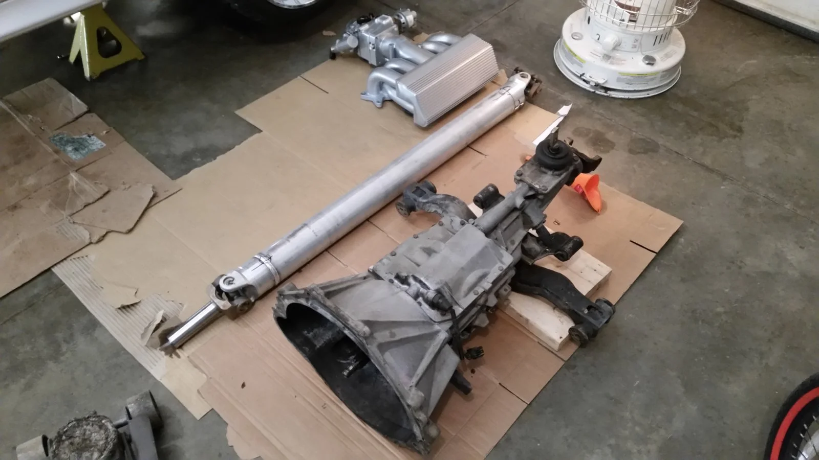

I got the transmission back out, and took off my intake to thoroughly clean it the inside. I have the new (to me) TB and spacer, but didnt install it back on the intake yet, as it needs some polishing.

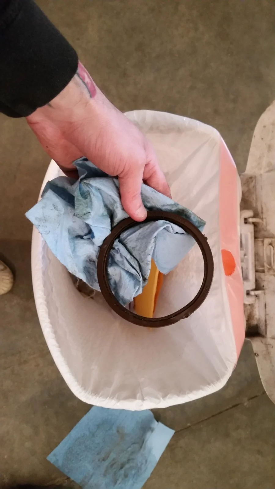

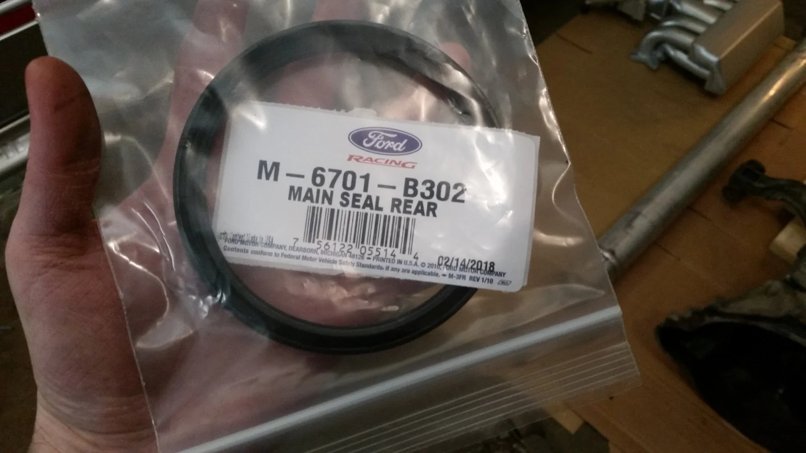

I put in a new rear main seal.

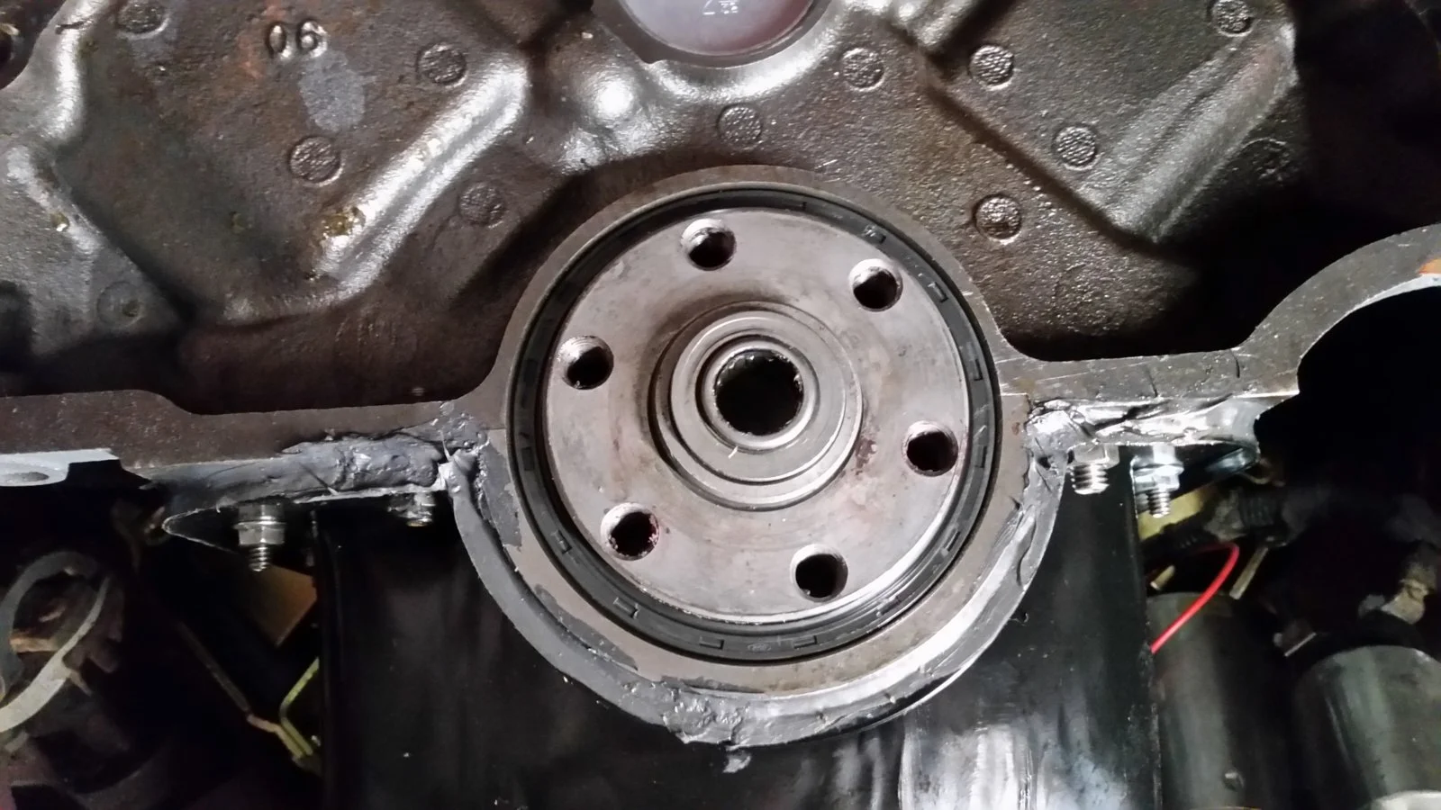

Out with the old.
In with the new. Notice I wasnt taking chances on my oil pan leaking, lol.

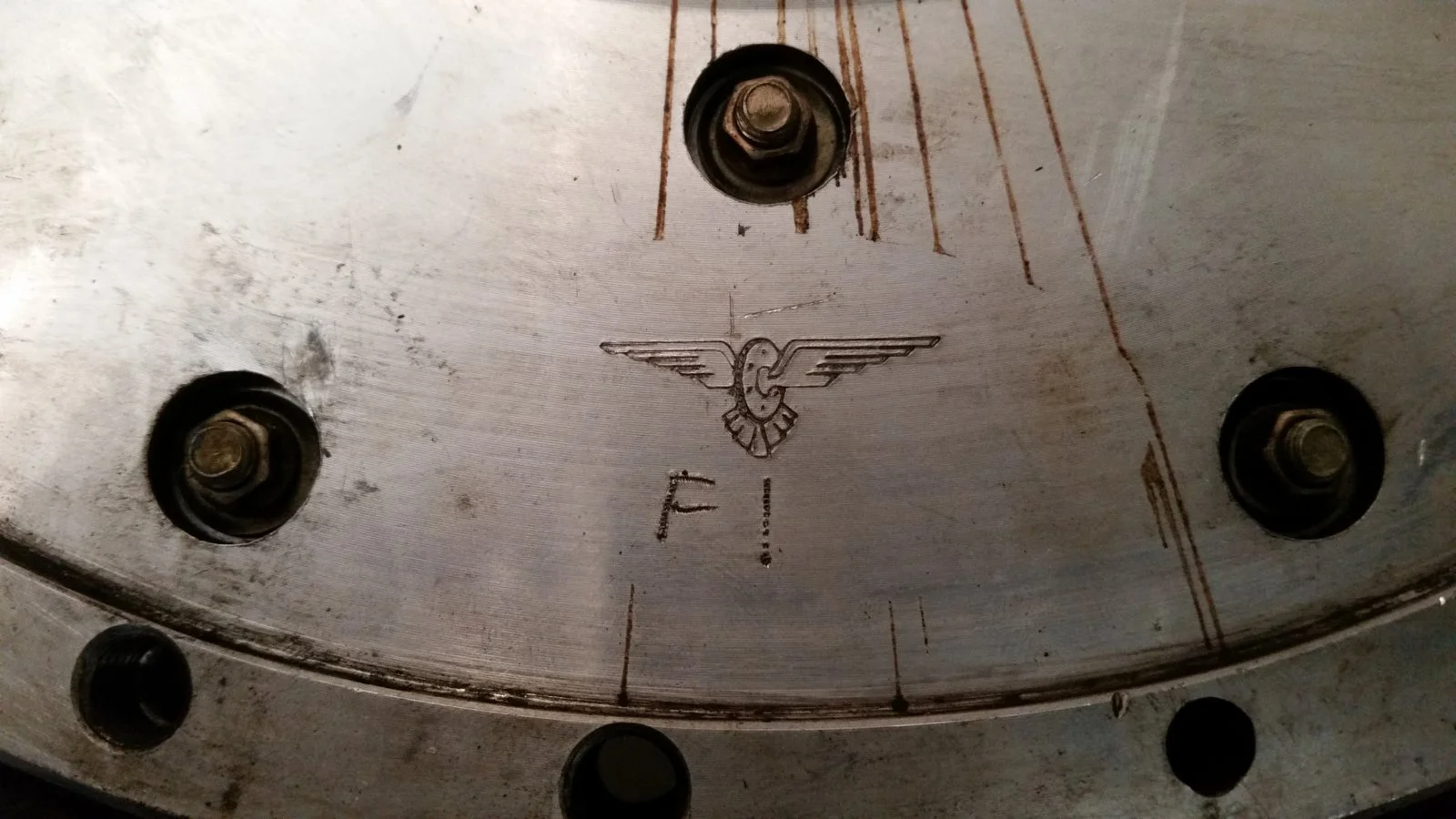

Looks like the Spec and Fidanza inserts are the same, so I picked up Fidanza part number 221101 for the friction insert. Fingers crossed its the right one. Tomorrow will be power washing the tunnel and prep for POR15. I didnt really bother with it during the engine swap.

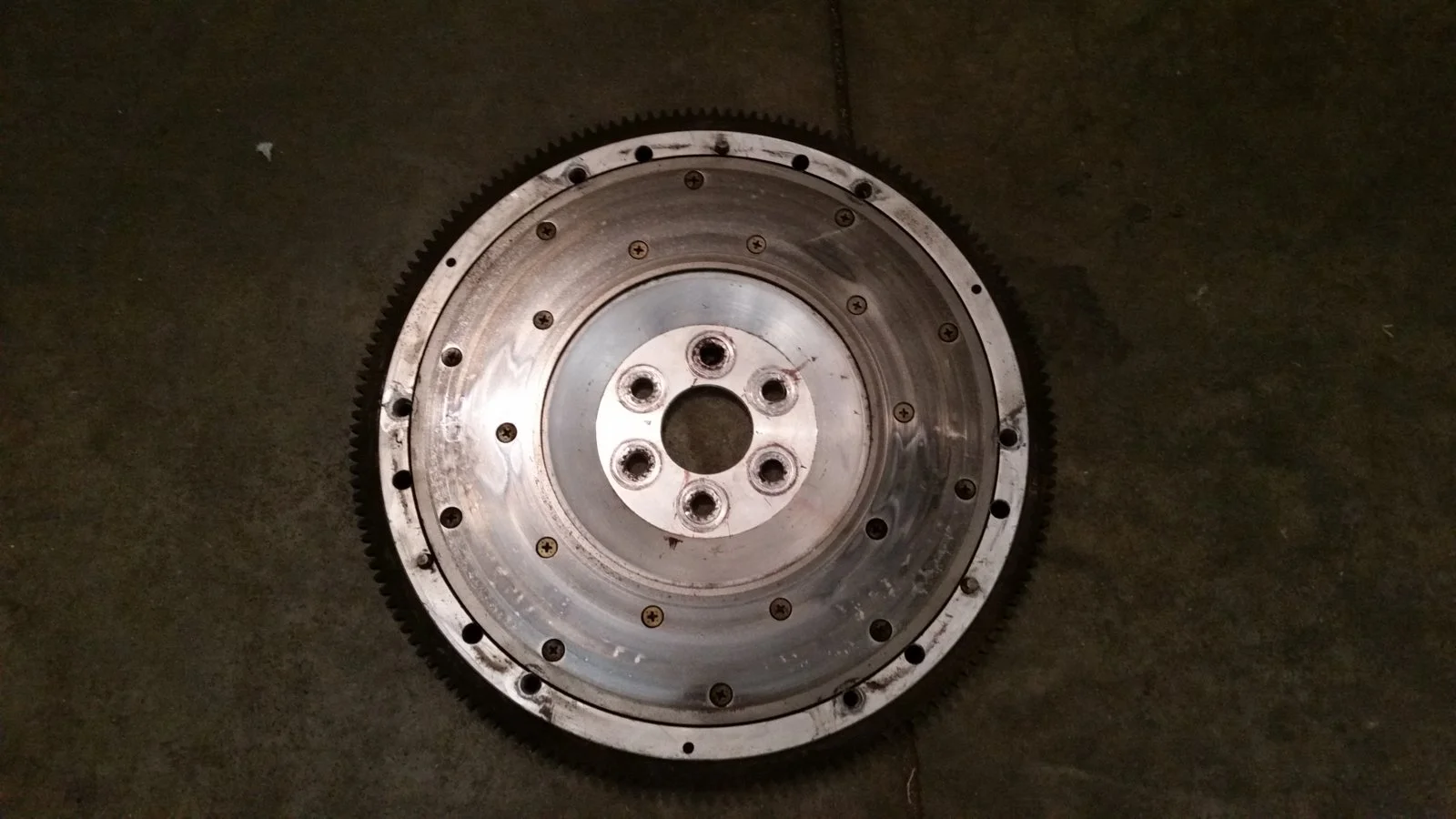

Turns out I have an aluminum flywheel, didnt even notice when I put it on the first time. Do one of you guys know the brand, so I can buy the right insert? Seller of the engine cant remember.
Looks like Aerosmith to me Nick. Jeez, the band really expanded on there businesses!

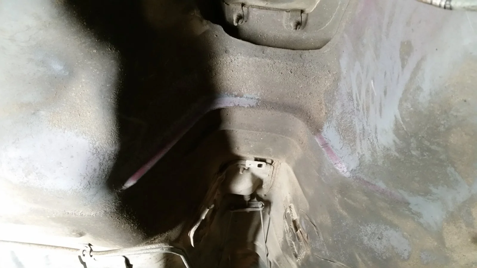

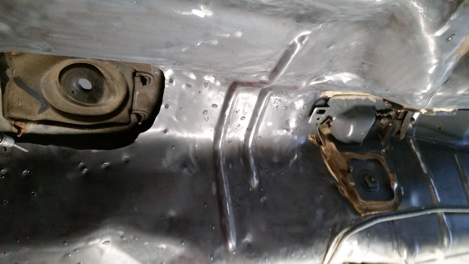

Today's task suuuuuucked. Power washing did nothing to the grime, so out came the grinder with a wire wheel. After about an hour, I then had to steel wool behind the fuel lines, and around the ebrake cables. I did only the tunnel, and will do the rest of the undercarriage in parts.
I have gone back and forth on whether to use silver POR15 or black, and decide since the lower portion of the exterior is silver, that'll be the ticket. Plus, I already used silver under the gas tank as well.

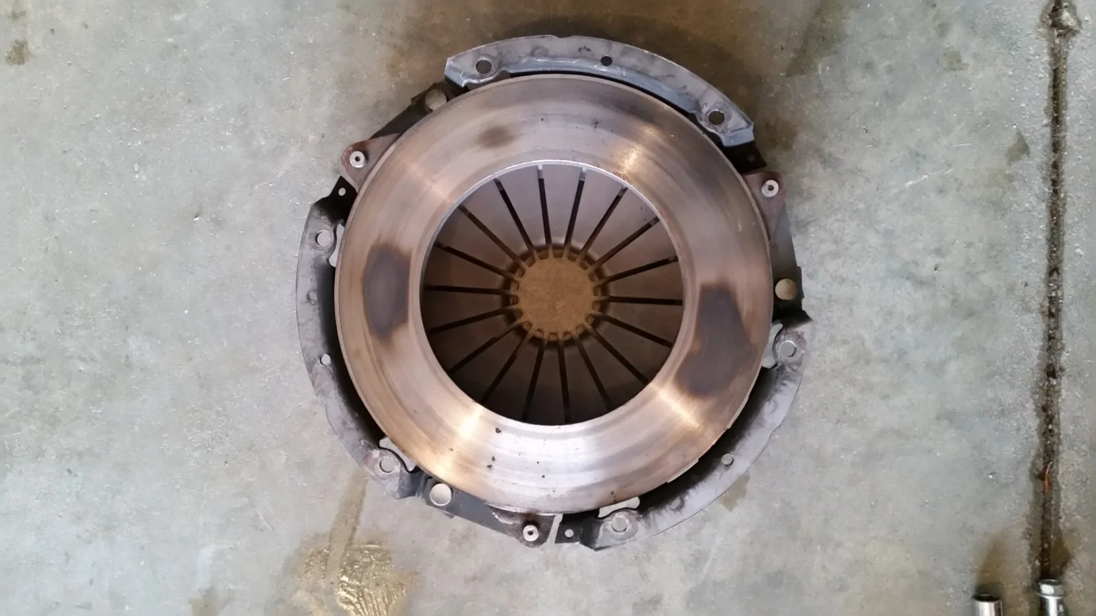

PS, do you think my pressure plate got hot when I fried the clutch?

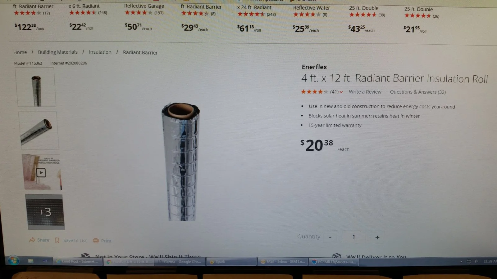

Trying to see if I can something like this locally, but obviously in a larger roll.
http://www.jegs.com/i/Thermo-Tec/89...KcL5zXnfbQkELEdZNnAGGLIysUmMcR18aAmfbEALw_wcB
At the same time, Home Depot has adhesive backed foil barrier for hvac systems, so I will check that out while Im there for a wire wheel. Will depend on if it looks like it can handle water or not.
