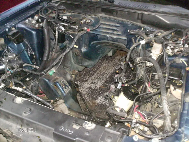

for now heres the few pics ive taken so far..

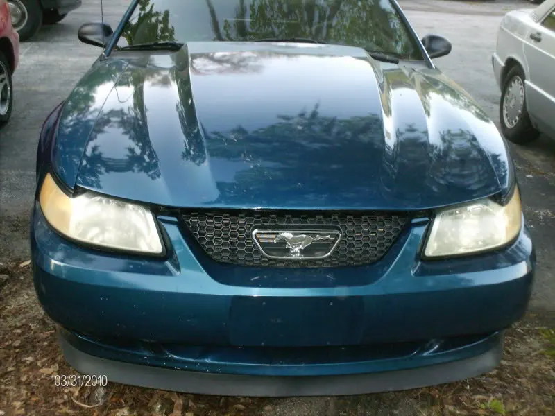

not sure if ive put pics of the new hood up yet but here is one..
and the empty engine bay..
more to come... i have a whole rack of parts..gonna take a pic of that later and put it up
AB FTW!!! Love that hood. :nice::nice:

thanks! and hell yea dude thats gonna be effing sick :nice:
