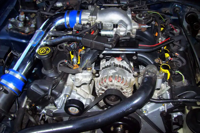

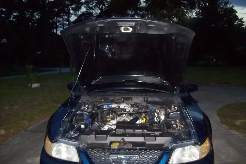

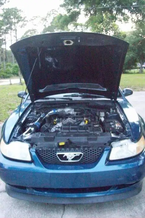

out of neccessity i just had to swap out c.o.p's... i called ford they wanted $92.58 each for the motorcraft ones...fuuuggg that..so i looked up what we had in stock at work and all we had in my store were the crappy accels...really didnt want to buy them but it was either get them for $11 a peice or wait a really long time for msd's or wome weapon x's...id rather have went with weapon x but like i said it was out of neccessity so i got the accels...
i was scared at first of having them and the second one i pulled out of the box i had to fix the prongs to get them to plug into the harness and i really hate yellow things..but i plugged them in, they dont look too bad and they actually are working quite well... so far...
took these randomly and kinda liked how they looked

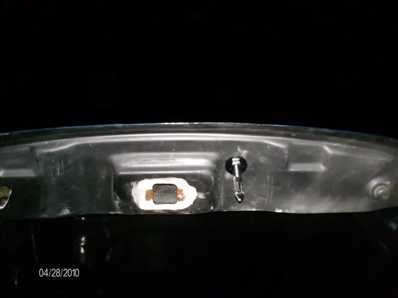

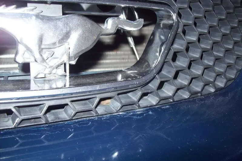

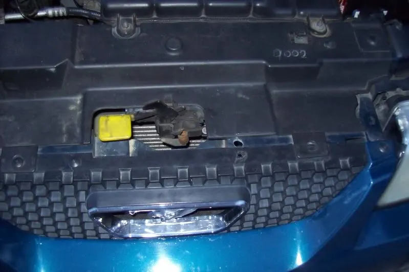

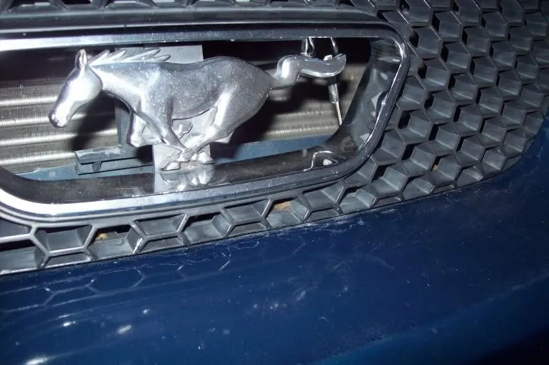

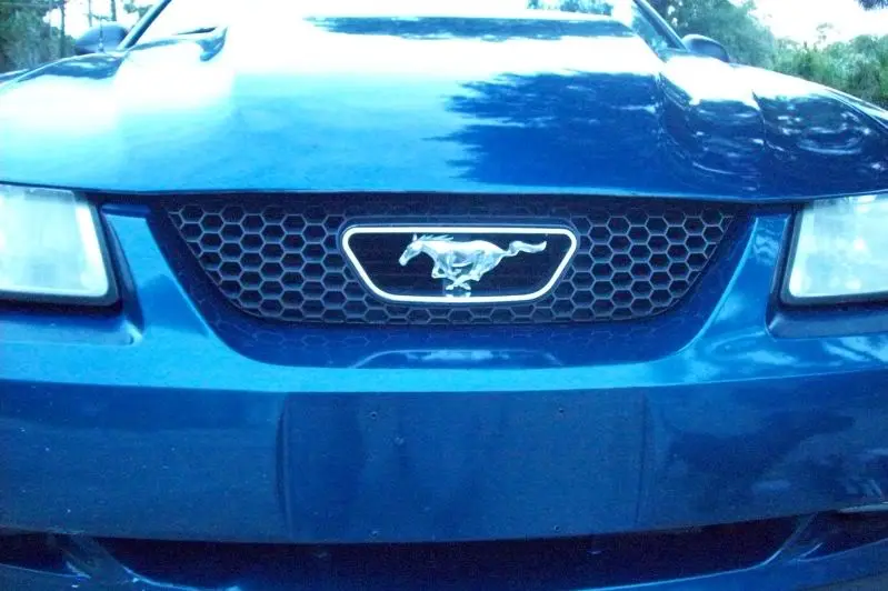

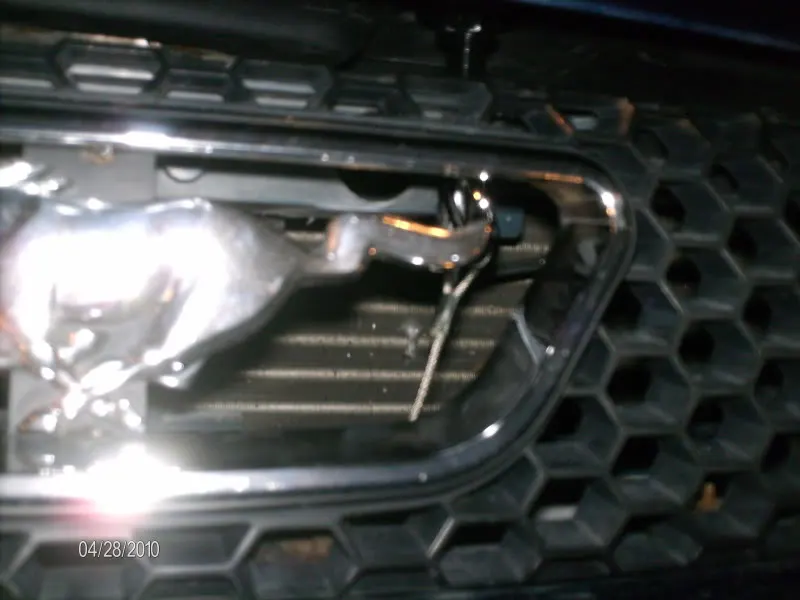

started a little project the other day..now that i have to take the interstate to work my hood has been shaking a lot more at highway speeds and being that it was scaring the hell outa me and i dont feel like buying a new winshied i bought some hood pins...and put them in... REVERSE!!!!!!
took a little bit to figure out how to do it with the stock grill but i got it done...had to cut the hood pin down to a shorter size as well too...it looked retarded at first with the bolt as long as it was but now that i resized the bolt it looks better.. i only have one in at the moment..wanted to get it right before i started the other side..im gonna sand the bolts down and paint them black to try and make them less noticeable too
couple pics before i cut the bolt
the hole i had to drill
shortened bolt
steaalthy, cant even see it
if i didnt tell you about it, you'd never know it was there...i attached the lanyard to the pin too to help pull the pin out better...might be a strange ass idea but at least it kept me from having to put the pins through the top of the hood....i really dislike that look a lot
