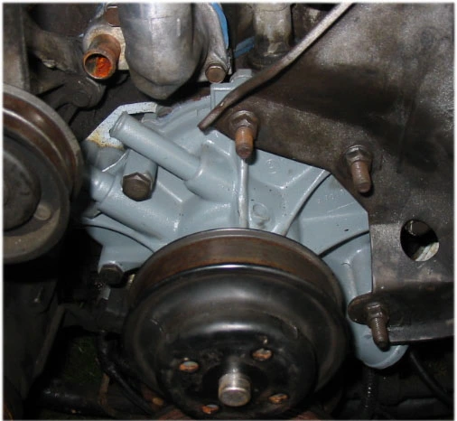

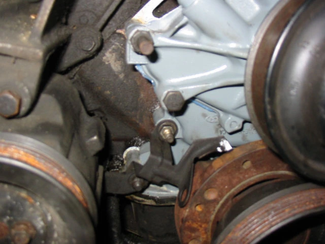

If you have the old water pump that you know came off the engine, then the impeller blades should point the same direction on the new pump. The water pump on a serpentine mustang is a reverse rotation water pump. If the impeller blades point the opposite way, than the new pump is a normal rotation pump and would be the wrong one. However, I thought they would both bolt up, which is why you have to know for sure what you have...? I would bet the new pump is the wrong part, or like was said, the threads got messed up by the previous owner. Also, there are different length bolts for different bolt holes. Look at the front face of the engine and look at the timing cover. You can estimate how long the bolt should be/which bolt to use by putting each one in each hole of the timing cover to see how much sticks out. Once you have it right, all the bolts should stick out the timing cover the same distance-roughly. Assuming you have all the old bolts. Don't force the bolts in. Some of them bottom out and will snap off, other will thread way into the water jacket. No need for that.

Here are a couple of pictures of the timing cover, and the new water pump. I had a look for a ford logo on the water pump, and could not find one, so mabe it's just a new ford timing cover, and some random water pump.
Do the bolts/studs seem to be in the right places ??
