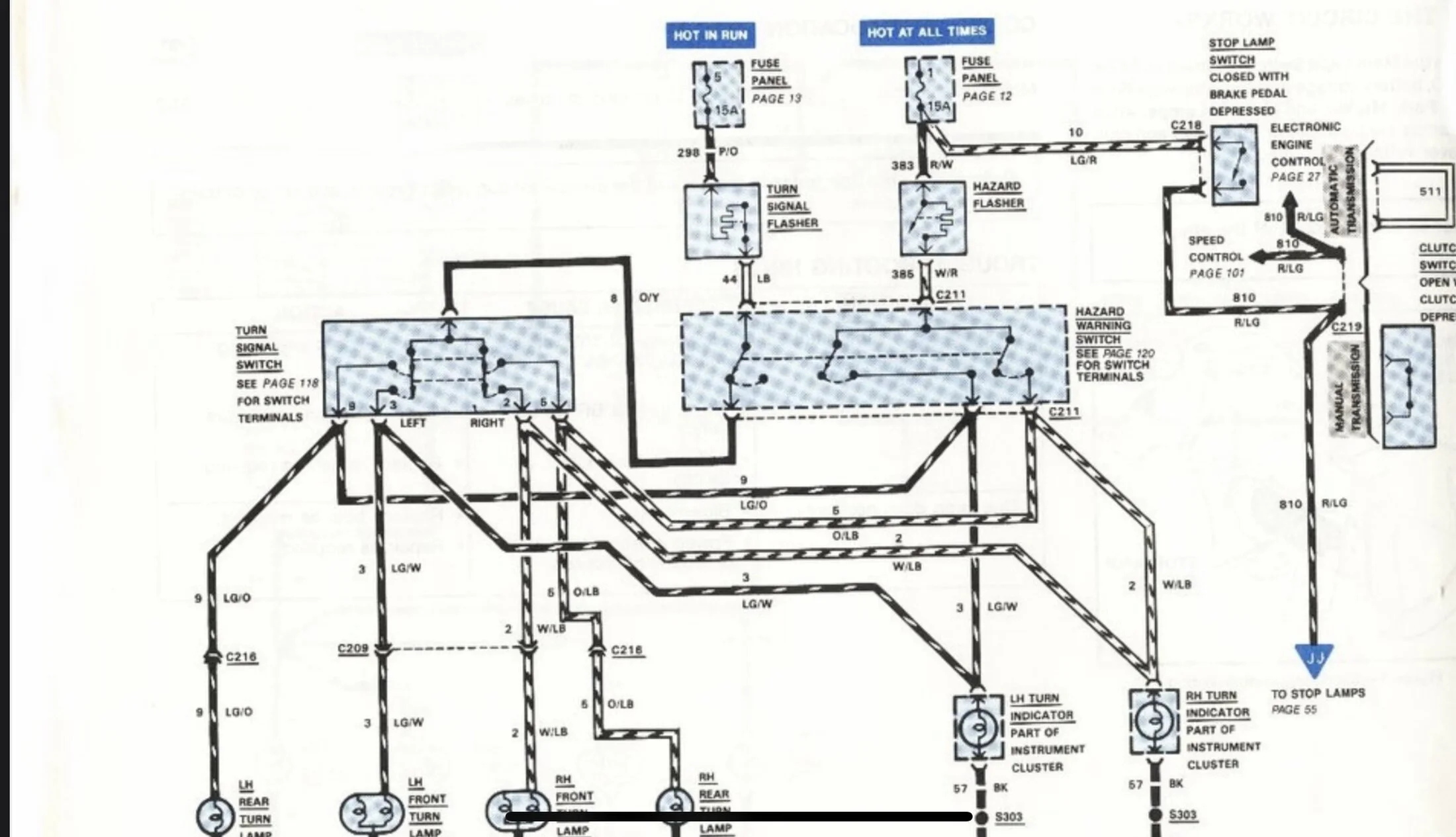

I don’t see where it goes through the MFS.
This is the 87-89 diagram, but it looks like they may share the same fuse (Fuse #1) but then it splits

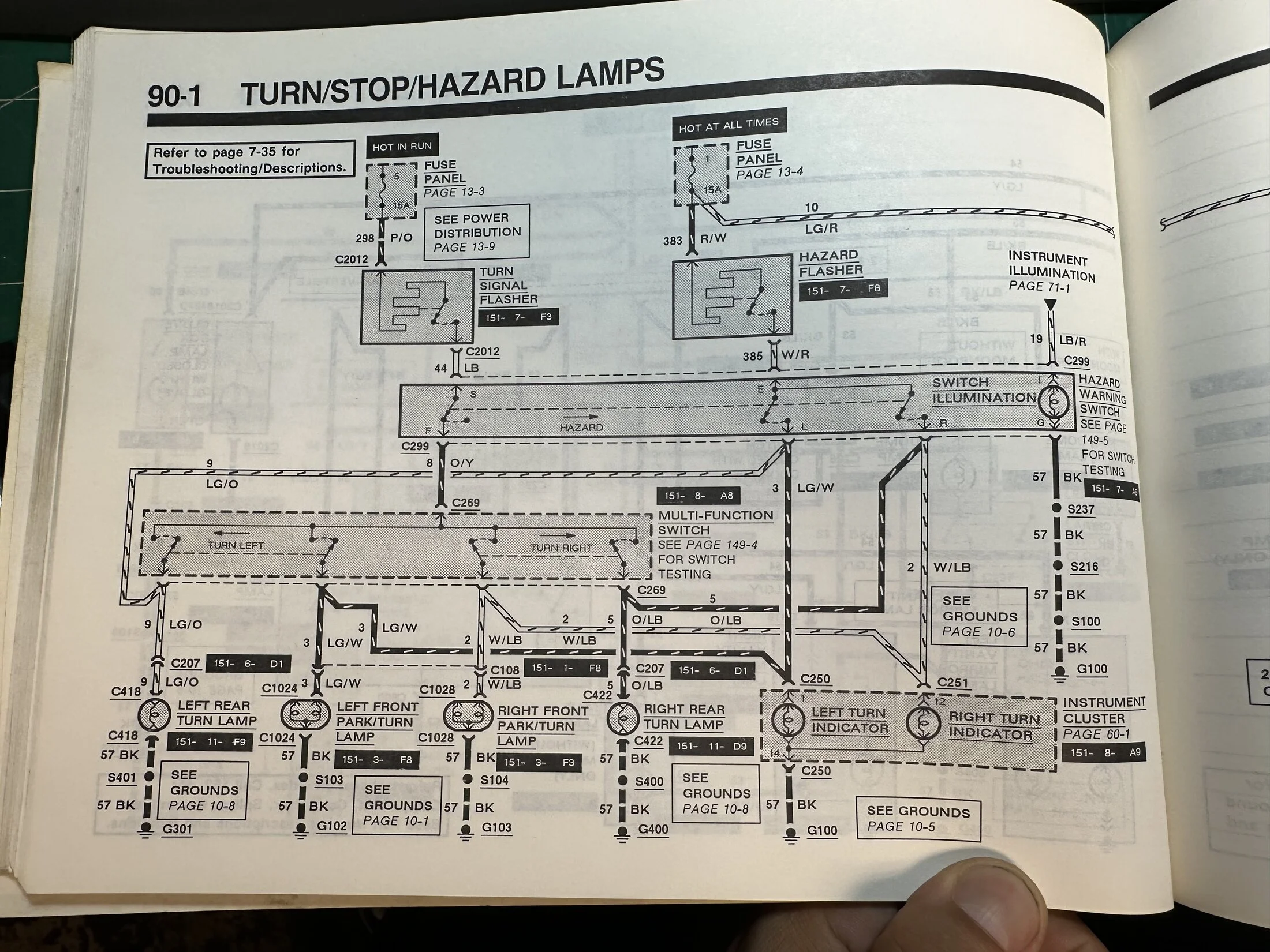

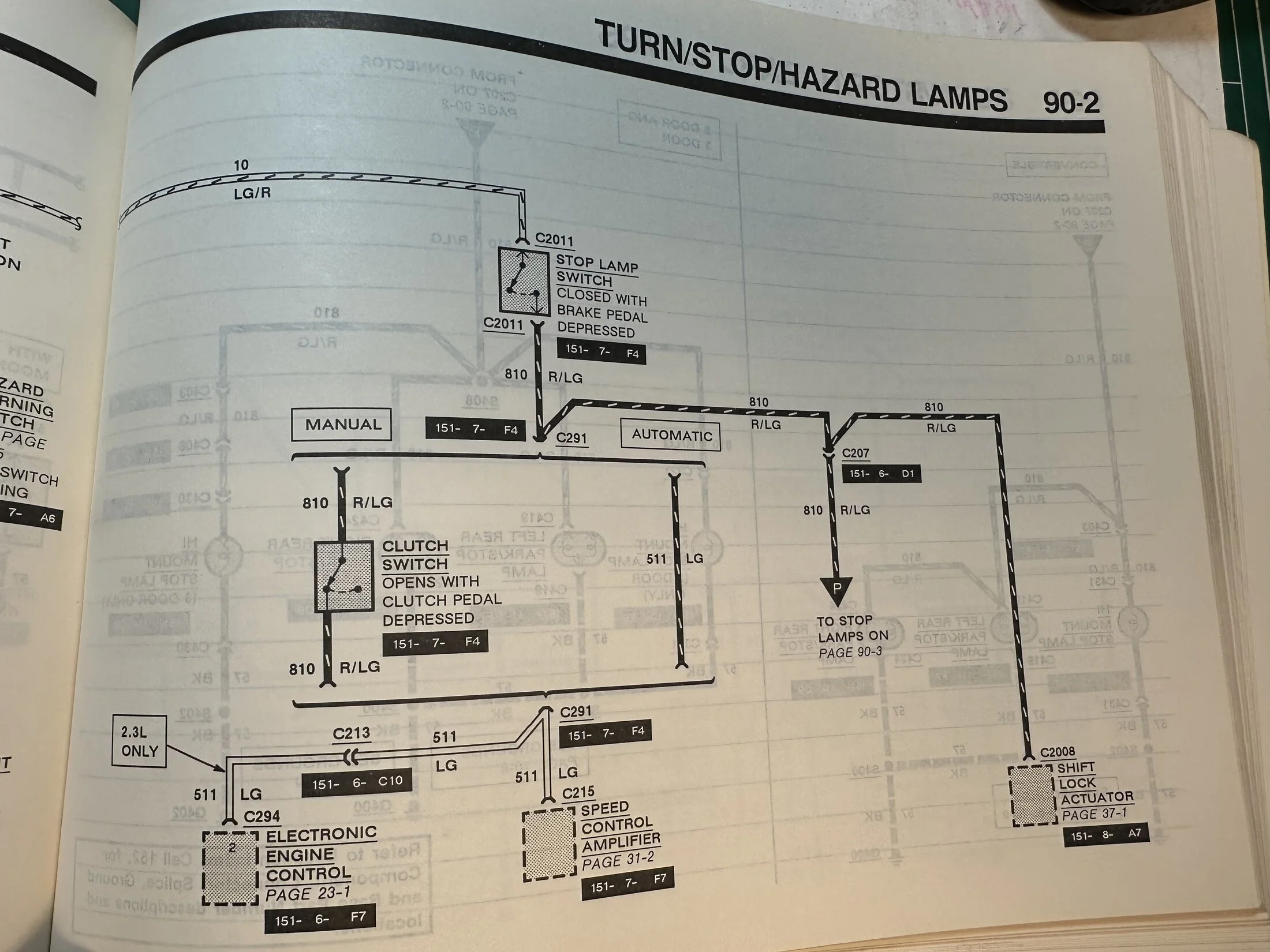

My car is a '93 model, maybe it is a little different? I believe in my car the brake light and turn signal light are the same bulb. My guess is that the multi-function switch handles situations where the turn signal is on and the brakes are applied at the same time.
I will pull the wiring diagrams for my 93 when I get home and post up the section on the rear tail lights. I want to say the outer part of the lens has a small running light and then a two filament bulb for brake and turn, and then the two upper clear lenses are the back up and hazard. The tag lights are either in the trunk lid or hatch.
I'm pretty sure the running light, brake light, and turn signal are all the same bulb. There are two filaments, a dim one for the running light, and a brighter one that functions as both the turn signal and the brake light.
