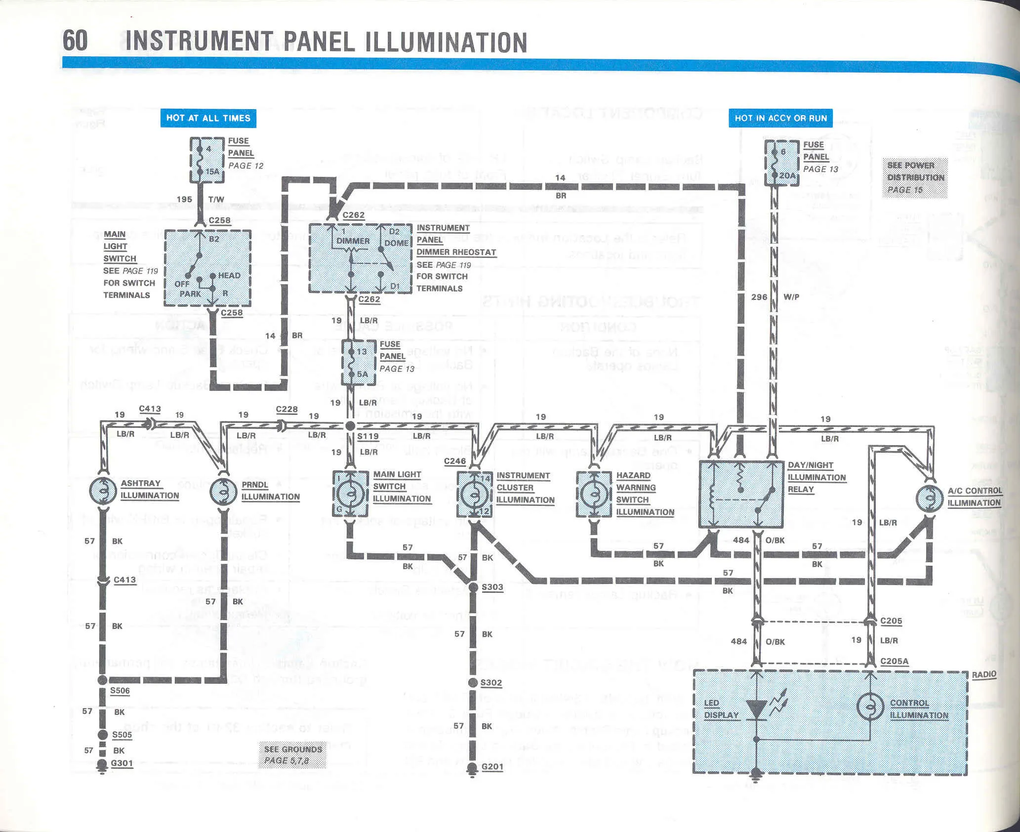

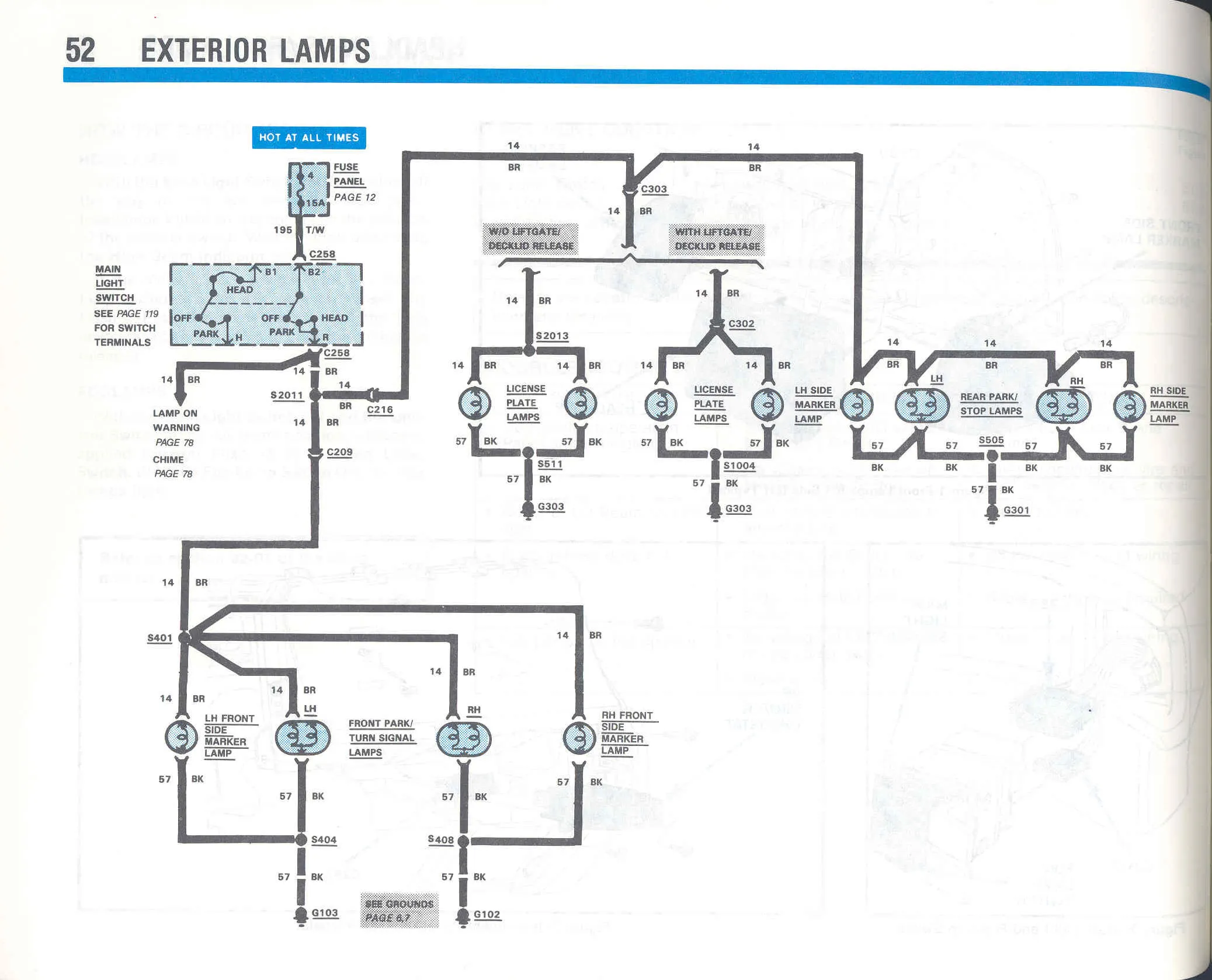

Here is the headlight switch wiring for an 89 GT.
attachment.php
Use the wire colors and circuit numbers to tell you what each wire does. Trace each circuit through it's path from source to end point.
Trace the power lead on the switch back to the fuse block. The use the diagram to make sure that there is power to both sides of the switch when the headlights are on. The headlights go through the turn/mulitfuntion switch to operate the high low beams. The plastic connector shell for it often suffers from the effects of overheating and cause the pins to get loose.
