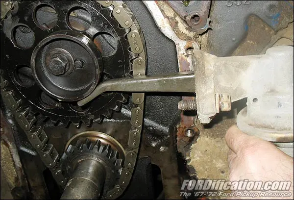

No, but it IS possible that there isn't an eccentric installed, depending on what engine you have. If it's the stock engine and hasn't been torn into, I'd suspect it's there, but if it's a replacement or has been rebuilt or whatever, there's a chance that the eccentric wasn't installed. This pic I stole from a Google image search illustrates what I'm talking about if you're unaware.
If it's there, then it's most likely a different problem upstream of the pump. The pump is gravity fed, so it could be most anything from a clogged line to a bad pickup in the tank.

It is difficult but possible to get the lever installed on the wrong side of the eccentric
Done it
Point the lever down
Way down then push the pump in and start the bolts
It is easier if the eccentric is facing away
You probably did not bend the pump lever but check it against the old pump to be sure
I have seen it push the fulcrum pin out of the pump housing and ruin the pump
