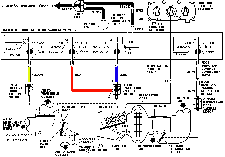

Check the vaccum powered actuators to make sure they are getting vaccum and moving when the control is set to turn them on.

Vacuum diagram 89-93 Mustangs
HVAC vacuum diagram

Follow the vacumm lines jricker is giving you.
Likely you are having a blend door issue.
The power to the blower motor is electrical, but the blend door is controlled by vacuum.
When you turn the knob from vent to defrost or floor, does the air blow out of the right location?
This diagram is great, however I am still at a loss. At the top you see the arrow pointing to the "engine compartment vacuum". I traced this into the engine compartment and found the tube disconnected. So, I found out why the HVAC selector stopped working. But, I can't find what this was connected to. Even the service manual doesn't show anything, or I just couldn't find it. Anyone?
This should come very close to helping you find where the line is broken. Maybe make your own drawing to compare...
Note that the Vac res is inside the passenger fender, and the EGR vac regulator, TAB and TAD solenoids are on the back side of the passenger shock tower.
Thanks, but still no help. I am working with a 1995. I found where the HVAC tube runs thru the firewall. I also found the same tube running across the firewall from the drivers side. Behind the drivers side shock tower is a vacuum distribution block where the plastic tube reconnects. I removed all the brittle hard plastic tube and replaced it with 5/32" rubber vacuum line. It easily slips over what was sticking out of the firewall back on the passenger side. I guess I should post pictures. The controls work now and it seems to have helped my idle issues also.
