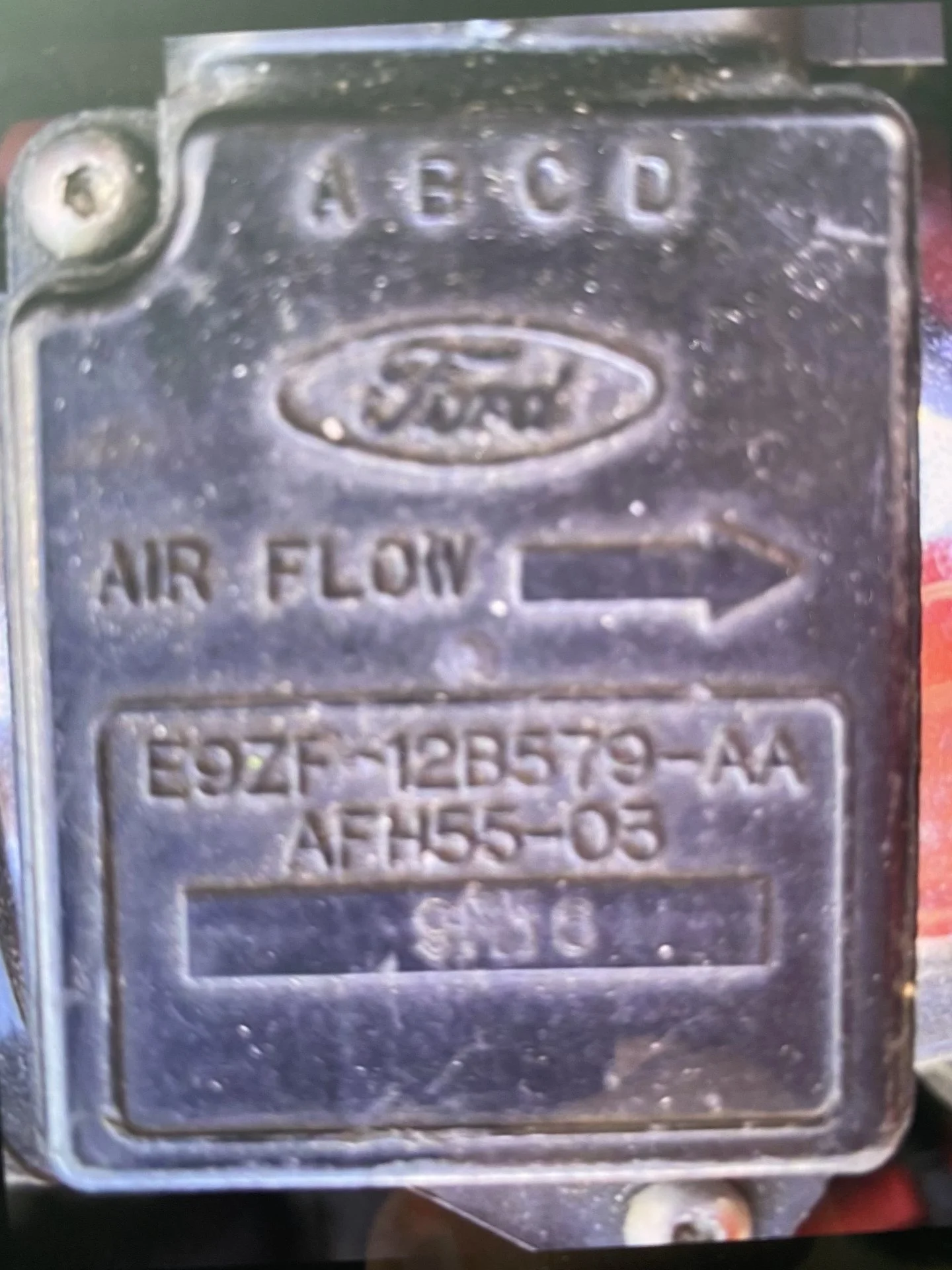

Can you post a picture of the MAF? Also, are the injectors the stock 19 lb/hr units? If you do not know what color is the top of the injector? Just trying to see if you have a “calibrated” MAF for larger injectors.
That appears to be the stock MAF sensor for a 55mm MAF - AFH55-03 is what gives that away. Orange tops are 19 lb/hr so you seem to have the correct injectors.
