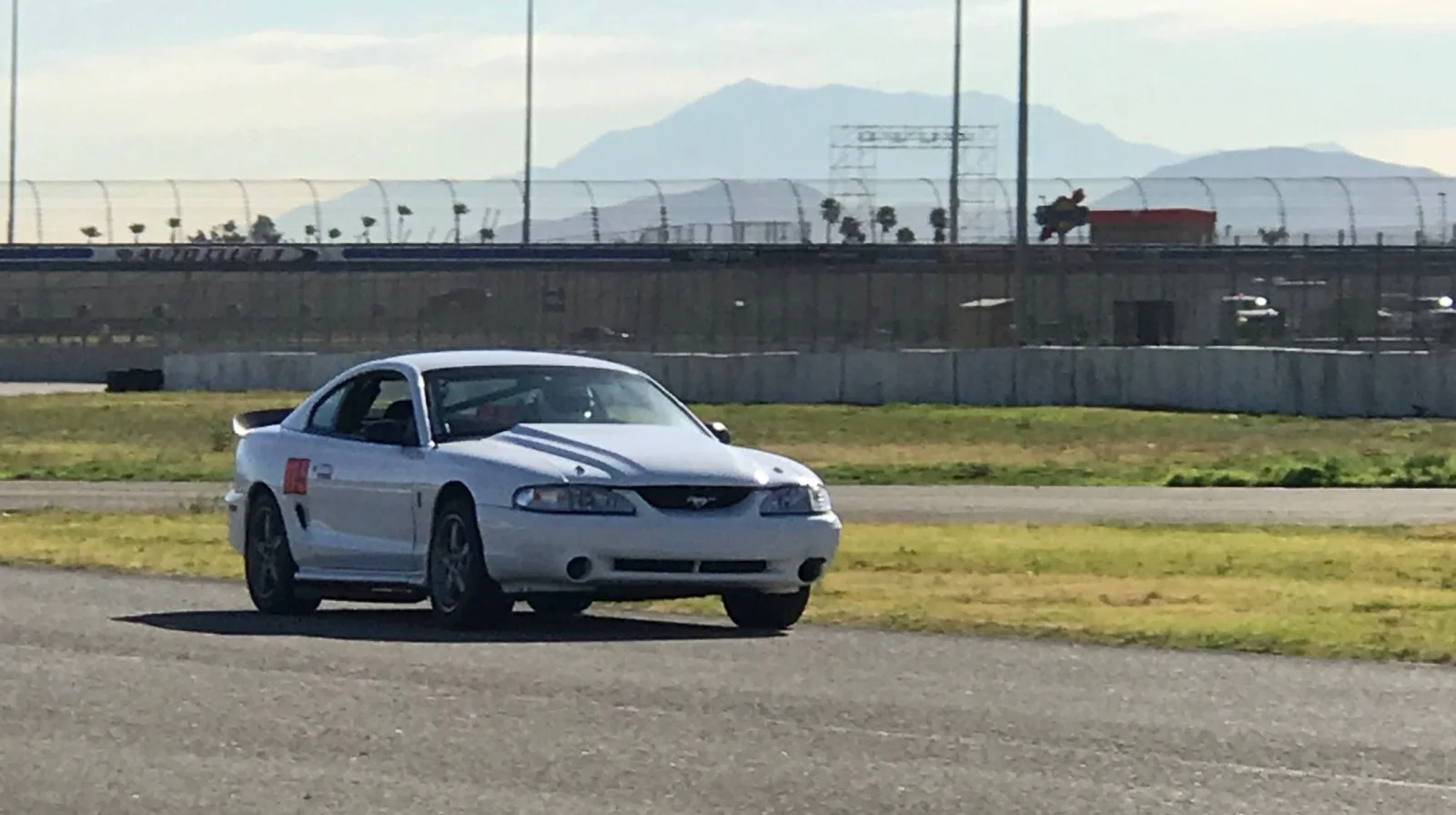

I was running my 97 Cobra at Auto Club Speedway (Fontana) on the Road course yesterday and lost power steering and most of my brakes at the same time. (Kinda crazy at 100mph+ going into a corner). What broke???
Thanks in advance.
