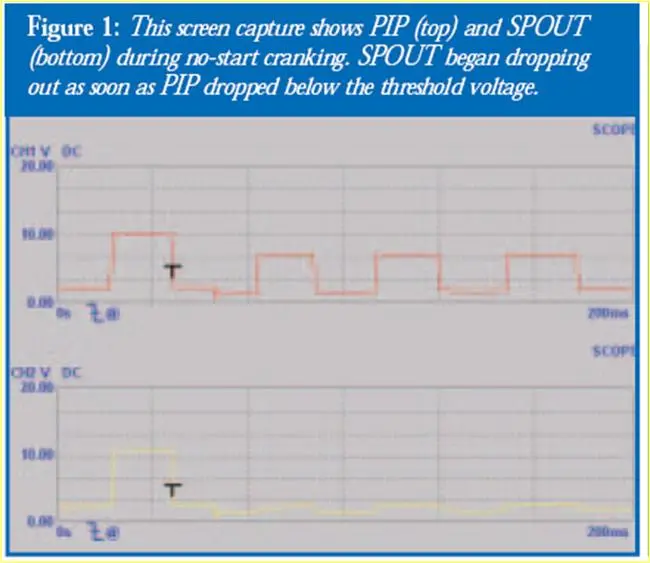

Unless you have an oscilloscope or Graphing Digital Multimeter, you will not be able to accurately measure the PIP output voltage. It is a slow repetition rate square wave, not a constant DC voltage.
The picture below was taken from the Wells article. It shows what the PIP output voltage looks like on a Graphing Digital Mutlimeter.

Two clues for a PIP with low output:
1.) Is that you get spark but no injector pulse. There is no injector pulse even though the required 12 volts is present on the injector red wire. That's the reason for using the noid light to test the injectors for pulse.
2.) Clue #1 must be true in order for Clue #2 to be true: the car will often start with the SPOUT out but not with the SPOUT in.
The simplest solution is to replace the PIP sensor or the distributor.
The PIP is a Hall Effect magnetic sensor that triggers the TFI and injectors. There is a shutter wheel alternately covers and uncovers a fixed magnet as it rotates. The change in the magnetic field triggers the sensor. A failing PIP sensor will often set code 14 in the computer. They are often heat sensitive, increasing the failure rate as the temperature increases.
