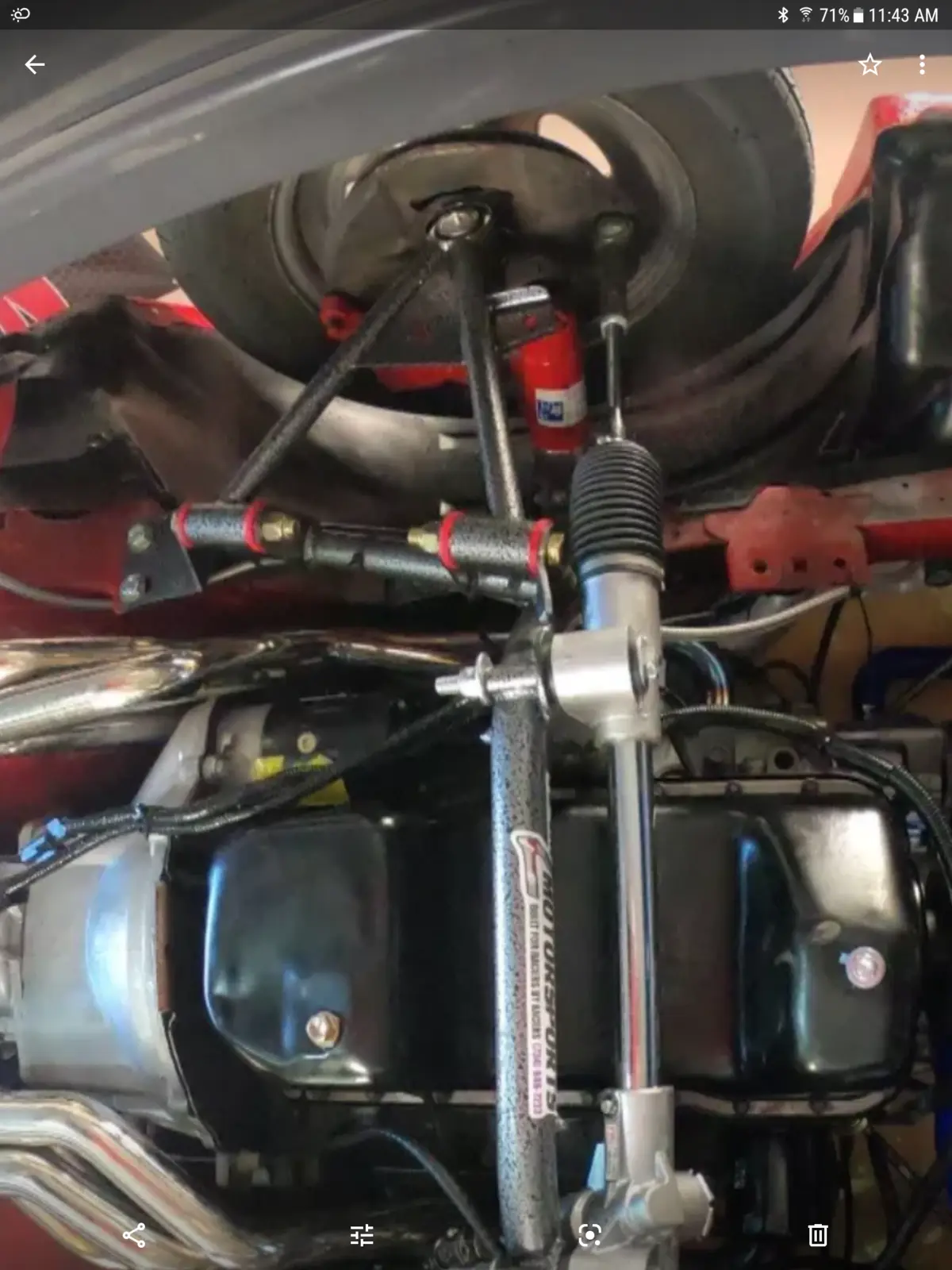

Can you tell from this picture? They are Team Z brand.

Yes, I do see sway bar mounts in that picture.
The Frame mounts for the seat bar are also visible. The flat red mounting pad on the left side of the photo is a mount.
You need the mounting brackets, bushings, sway bar and a pair of endlinks

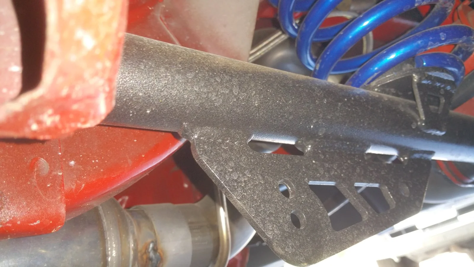

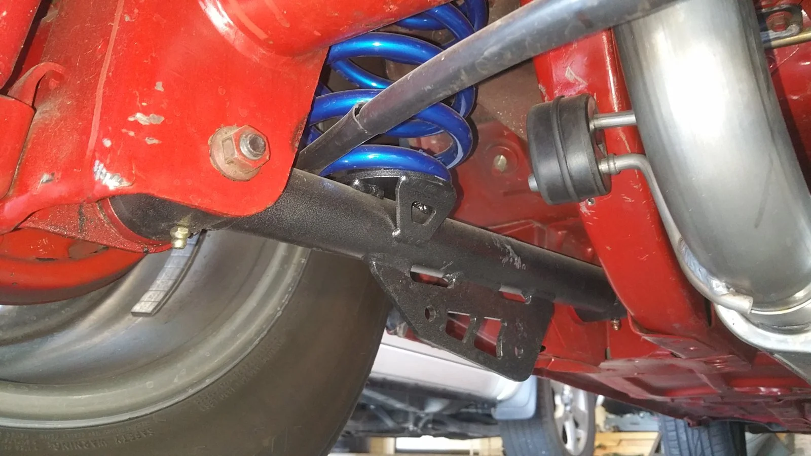

I did find a pair locally for $60. Can anyone tell if they will mount up ok with my BMR rear control arms? I think the front should mount ok since my A arms have a mounting pad and there is the OEM bracket on the car.

It should mount up.
Since it has the mounting points, i'd assume it works.
It's not like there are a lot of styles of rear sway bars that connect to the control arms.
Yeah, should mount to those arms. The little triangle braces below are the sway bar mounts.
