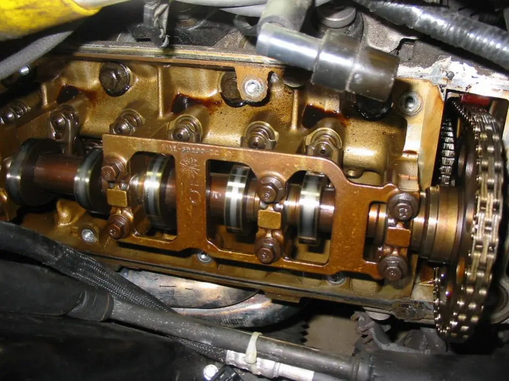

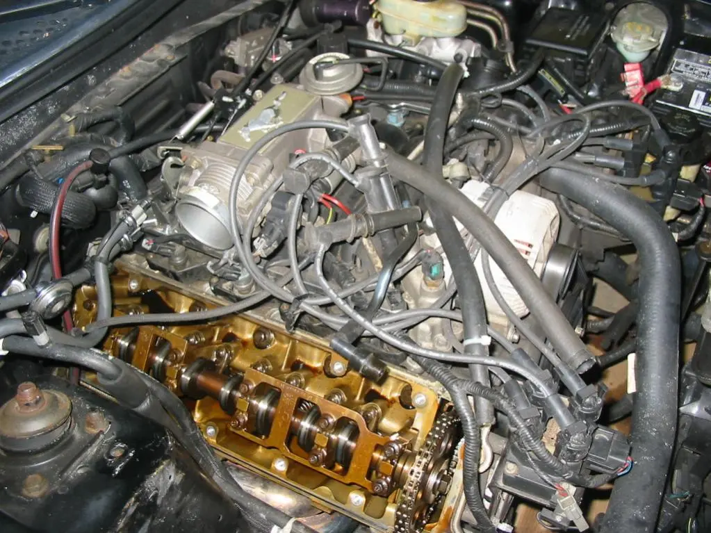

Hey everyone, Im new to this forum, and new to the mustang scene. Well I made a rookie mistake here... I looked at a guys "97 Cobra" and everything seemed legit. But I was in a hurry, and didnt really check the engine over well, so I picked it up. Brought it home, and it just didnt feel like the 305hp its supposed to be. So when I got some free time, I decided to check things out... Well I popped the valve covers off just to find a SOHC instead of the DOHC that was supposed to be there. The body is surely a cobra, but I obviously assume the motor was changed. I got a good deal on it either way, so no big loss, but you can understand how upsetting it is and how many times I feal like pounding my head against a wall! lol. But anyway, I noticed the heads had casting numbers that read F1AE-6B280-DC Can anyone explain to me which heads those are, and can you tell me where to locate any casting numbers to identify what motor it is exactly. Any feedback is GREATLY appreciated!

how did that look anything like a cobra motor to you lol
scup
Mar 8, 2010
11
Mar 8, 2010
  • Mar 8, 2010
I know, Im an idiot... Ive never owned a mustang before. Now that we've got that out of the way, anybody recognize them?

You really got screwed, that's a Non-PI motor. But at least it has headers LOL.
Don't know about the heads, but it does have a PI intake, I think. Did they make NPI intakes with COP attachment points and aluminum crossovers?
oxfordgt
Apr 30, 2006
288
18
Clarksville, TN
Mar 9, 2010
#15
  • Mar 9, 2010
  • #15
Yes they did make them with COP bolt holes and aluminum crossovers http://cgi.ebay.com/ebaymotors/96-9...ptZMotorsQ5fCarQ5fTruckQ5fPartsQ5fAccessories
I go by the runners and it's hard to tell but the first runner looks like it goes to the passenger side meaning it's non-pi. The fuel rails are from a Non-pi engine you can tell by the fuel feed position, the alt is from a non pi engine, the coil packs. Those are Romeo heads and romeo heads on came out on 96-98 gt and 01.5-04 gt. The 96-98 had push in pvc and the 01.5-04 had twist in pcv. The pic shoes push in. I would need better pics to be for sure.

Oh and judging the color of the internals its and old wore out npi,
