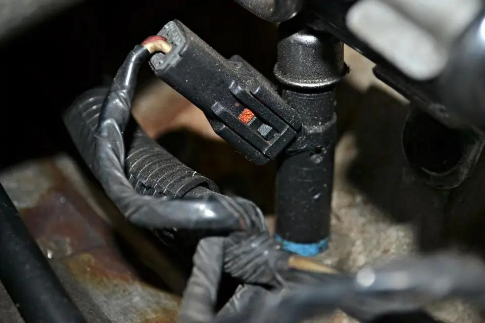

If the car is already done, why would you need to mess with the injectors? What color are yours?

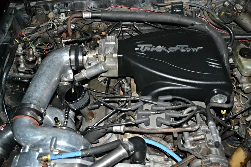

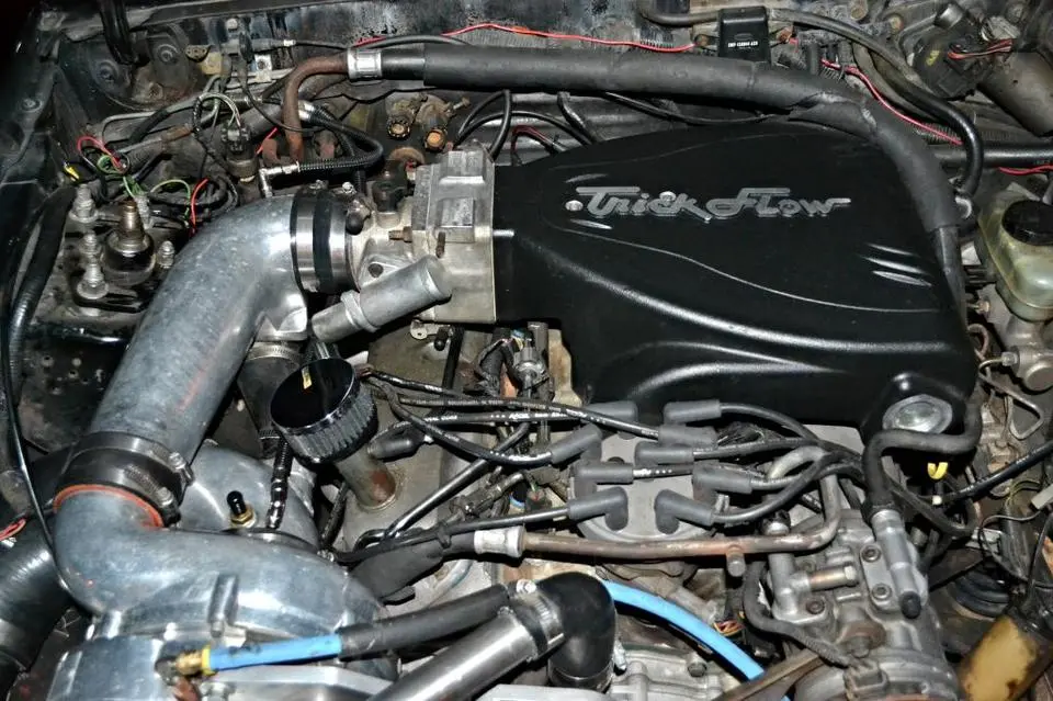

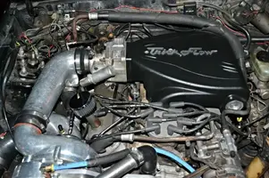

I am realizing now that I made a huge mistake not making the seller prove what has been done to the car, the records were much more important than I initially thought. Hindsight is always 20/20. Don't worry about hurting my feelings, i'm in the Army and I can take criticism. It's had at least 3 owners that I know of, I know the last two names but not beyond that(which is when it was built). I am working on getting the past owners names, I contacted the DMV out here and as was previously stated they were hesitant to give me names for the past owners. I did get them to send me a form to request the past owners information formally. I also reached out to the folks at carfax to see if they provide the past owners info with a purchased Carfax report. Unfortunately the shop says they can only find the records for the car based on the customers name, but I am going to keep bugging them to try and get more help from them. I did pay $6,250 for the car, I guess when I finally find all all that was done to the car i'll know if I made out alright. From this point forward I'll be recording everything done to the car. I took some pics of the engine bay, I'll have to get more during the day when its better light out.

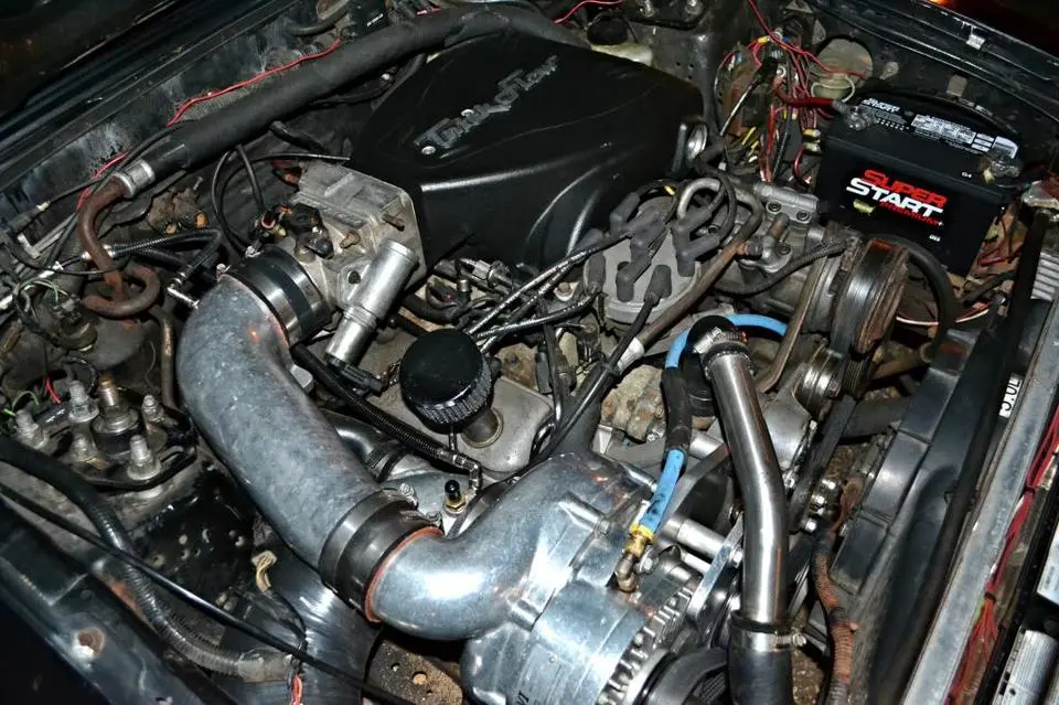

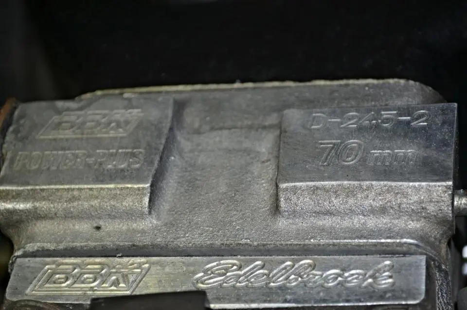

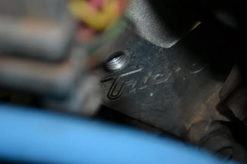

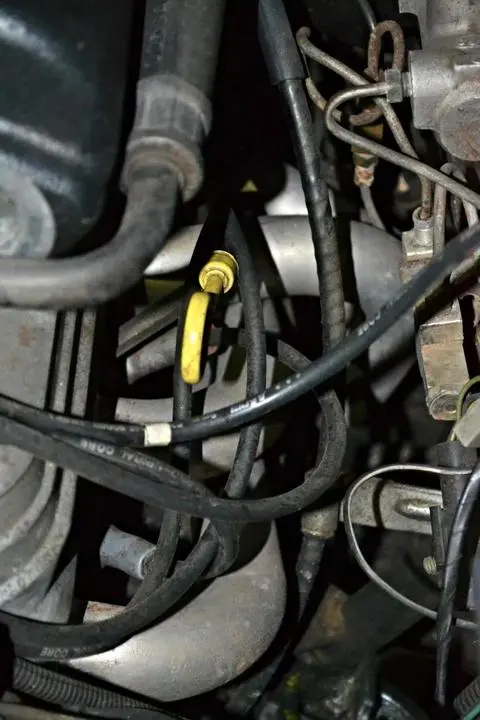

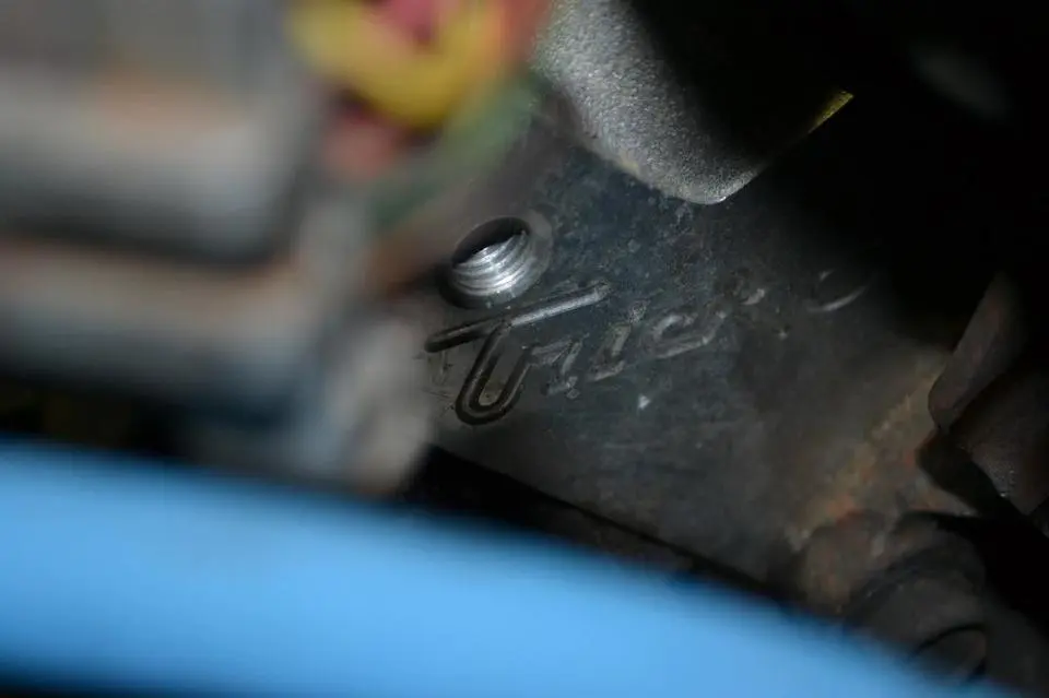

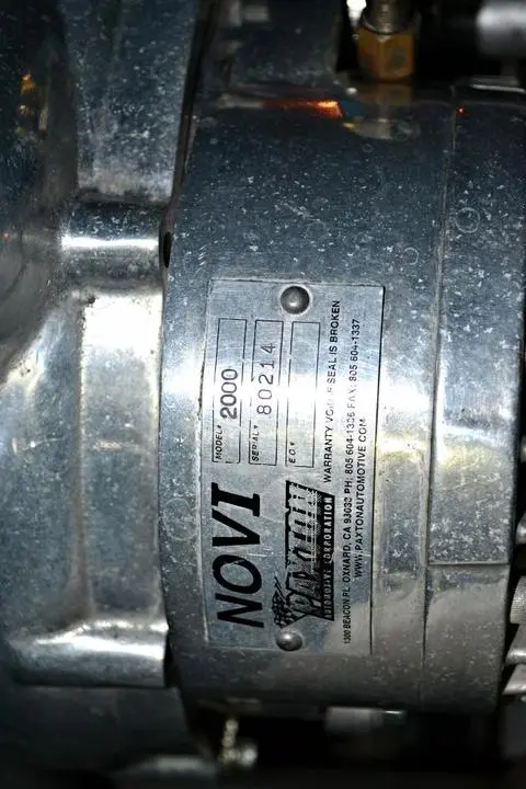

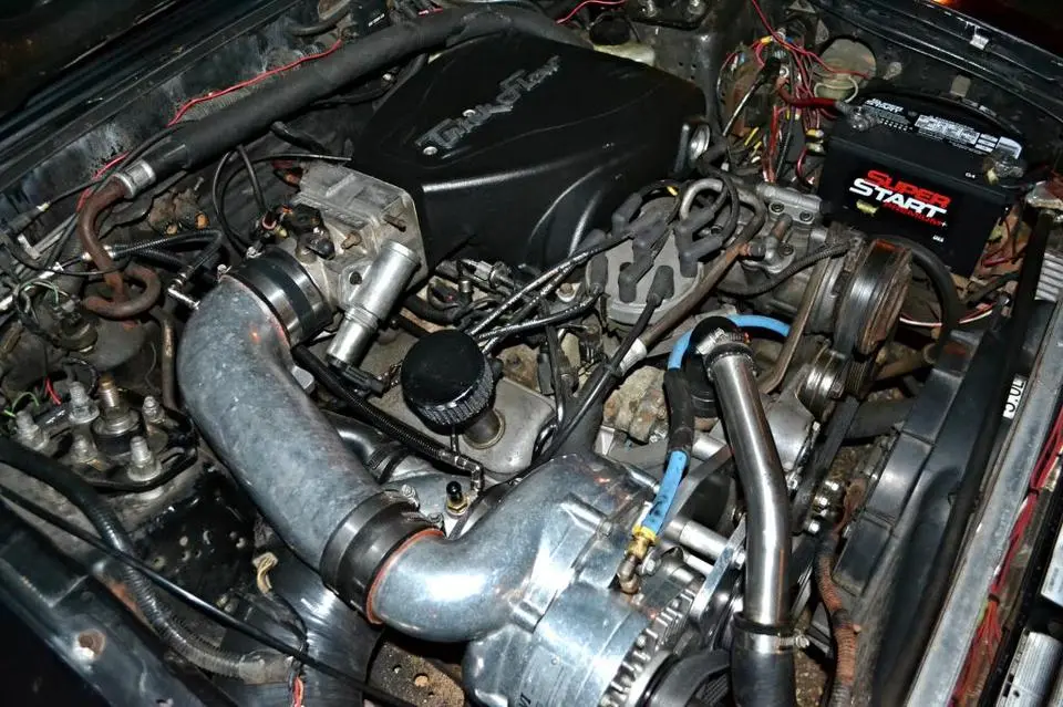

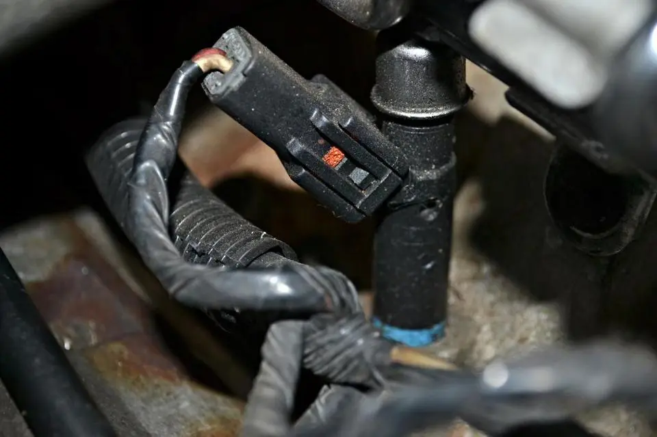

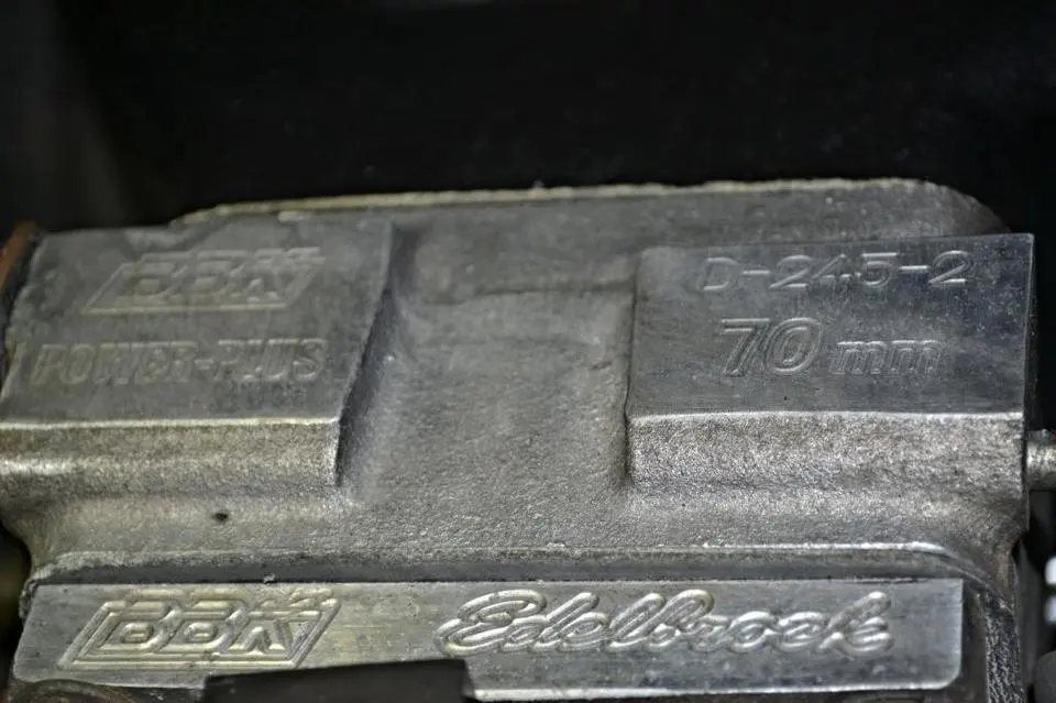

Take some picture of the front of the heads. I can't tell if they are aluminum or not. There are some decent parts on there. You can call Paxton with the serial number and ask if it has ever been serviced. Also, cap the two bungs off the EGR spacer as you are sucking in unmetered air. Nothing on that motor jumps out at me and says it is making anywhere near 500hp. That intake and the stock fuel rail won't support it for starters.
Where is the methanol injection system?

I bought rubber vacuum caps for the ports on the EGR. I did find out some info on the car by having a buddy look over the engine bay and rear end. The rear end is an 8.8, I will open it up and see what gears it has tomorrow.

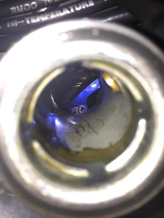

Close-up Pic of one of the Heads

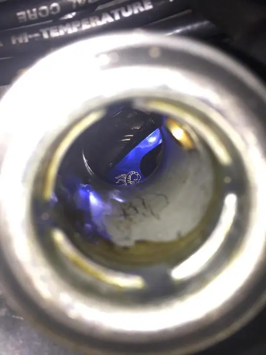

A peek inside the valvecover, its kind of hard to see.

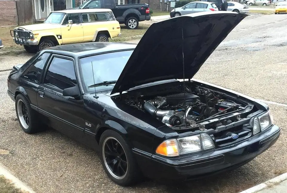

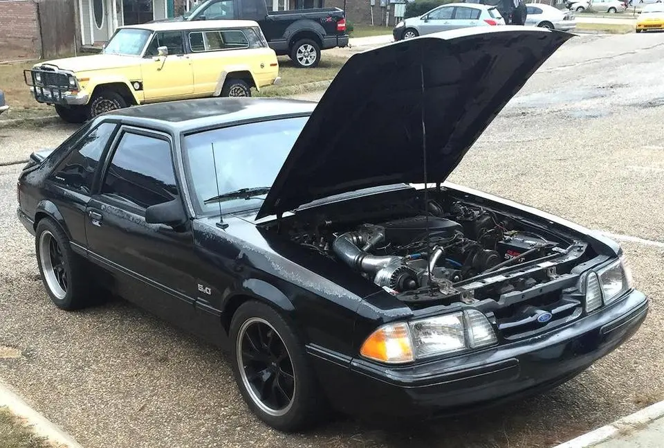

My Car, 1989 Mustang Lx 5.0

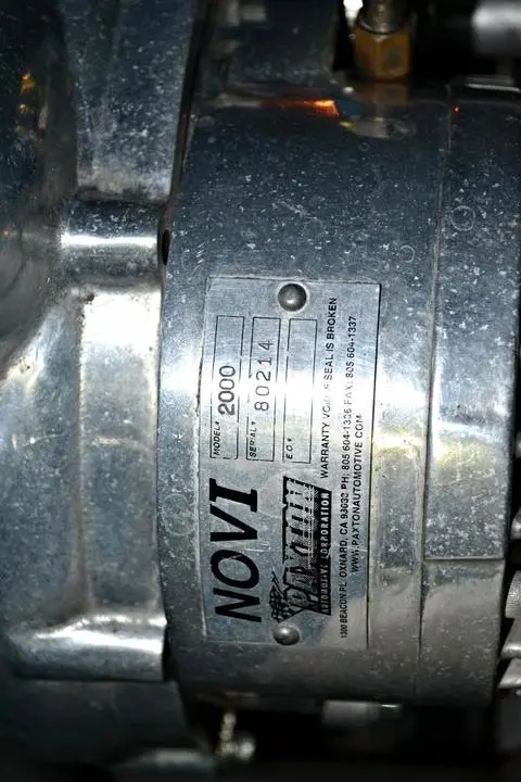

Good H/C/I set up with a Novi 2k could be over 500 rwhp easy.
No reason to open the rear end really, get a buddy to pace you at 65 and record the RPMs and you should be able to figure out what gears are in it. ( assuming a T5 trans)
Looks like a pretty damn decent car
