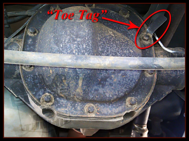

Nice car! The EASIEST way to find out your gear ratio is to jack up both rear wheels off the ground. Put a piece of tape on your tire and a small one on your drive shaft. With your trans in N, rotate your tire one turn while your count driveshaft rotations. One spin of your tire should equal 3.75 turns of the DS for 3.73 gears, if DS spins 3 1/2 times then you have 3.55 gears and so on.
Also after checking that you should look for a tag on your diff cover. There will be a bunch of numbers and at the end there will be something like 3L73 or 3L55, 2L73. The numbers indicate your gear ratio and the L is for limited slip (trac-loc). People don't always update this tag when upgrading gears.

GroverDill

Driving it sounds easier to me
Maybe....but you need a friend and that friend hopefully has a stock vehicle with an accurate speedo. Then drive all the way to the freeway. My way takes maybe 5 minutes on a level surface. So how does your way work? You get to 65mph, record your rpm, then what?
