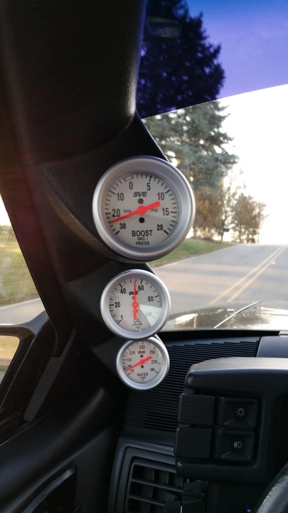

Hi, Yup, gauges not up to par is a vast understatement. Here’s a Pic offline a SN member posted about as “right” as “right” can be. Pillar gauge mount, gauges exactly where they need to be...

Pillar pod, as stated above tends to be the cleanest way to do it. Kind of a pain in the ass to run with wiring (at least for an afr harness, oil pressure is easy) but worth it.
I’ve had the factory gauge drop and read all kinds of ways. Definitely not a gauge I’d trust to give the overall health of my engine.
