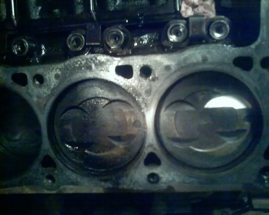

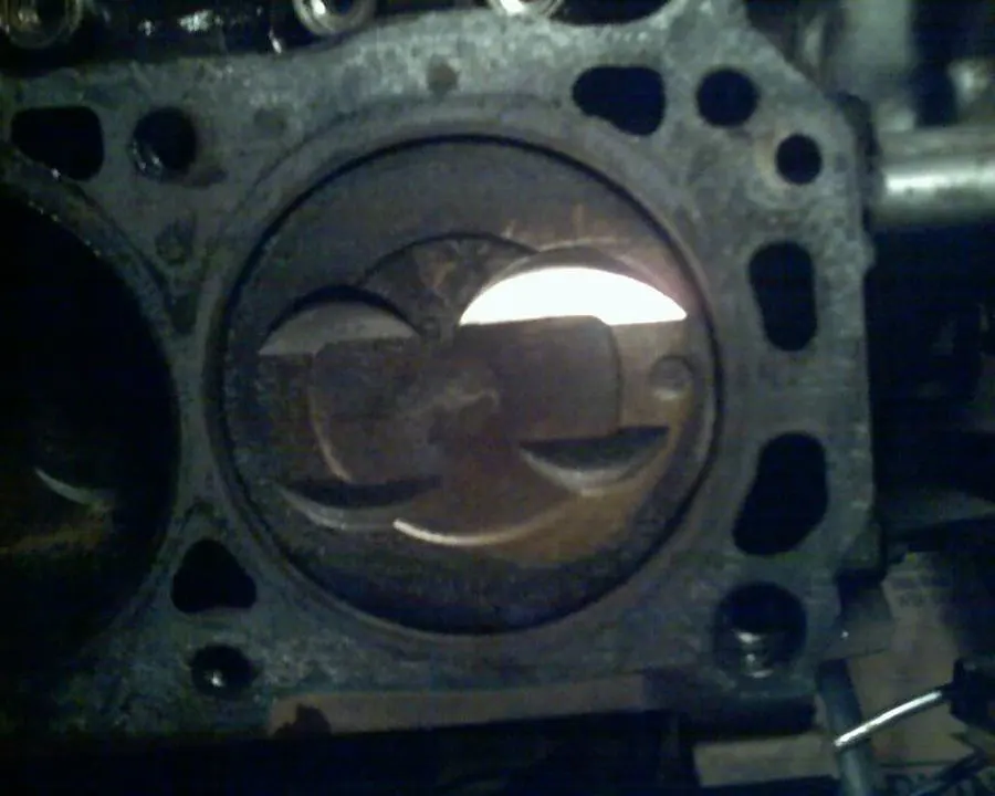

I purchased the Isky cams piston notching tool last week. Started the first piston, placed the gasket and head on the block with the tool in intake valve number one. Tapped the tool till it hit the piston and set the collar to the depth I needed the valve to be cut. After removing the head when the cutting was done, I immediately noticed that the notch was below the stock relief. Is this normal? Has anyone used this tool before with the same results? I have stock 91 pistons and the notching tool matches my new valve size of 2.02 exactly. What gives, I try to do a clay check but now the clay is sticking and I can't get a good reading. I even tried oil on the head and piston. Still sticks to the head. Has anyone put edelbrock RPM heads with 2.02 valves on a stock bottom motor without any clearance problems before?

I tried with the piston all the way up but, the tool sticks to far out the the chamber for the head to fully seat on the block. I had to start with the piston about half an inch or so in the block on the compression stroke. Maybe that's were I went wrong. I'll have to try to gaskets with the piston TDC. Any other suggestions if this doesn't work?
When we did mine with the piston a bit down in the cylinder, it actually notched the wrong place.
I think if you turn the crank to the point where the piston just starts to pick the head up off the block, that's the perfect spot.
I did just that, put the head on the block and turned the crank untill the head slightly lifted then backed it down till the head was back on the block. Bolted the head down and I used a speed variable drill for cutting. I set the collar for 0.145" as the depth of the cut. It turned out perfect. Thanks for the help!
