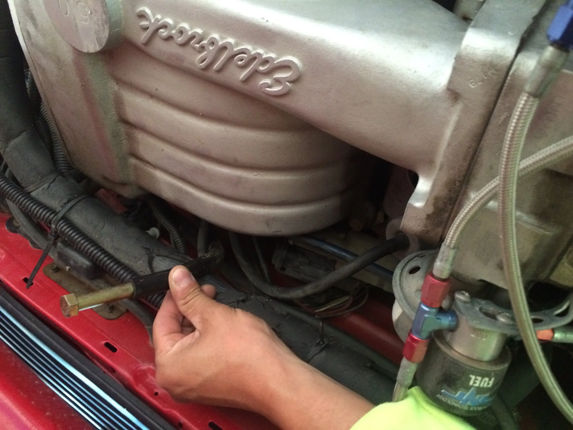

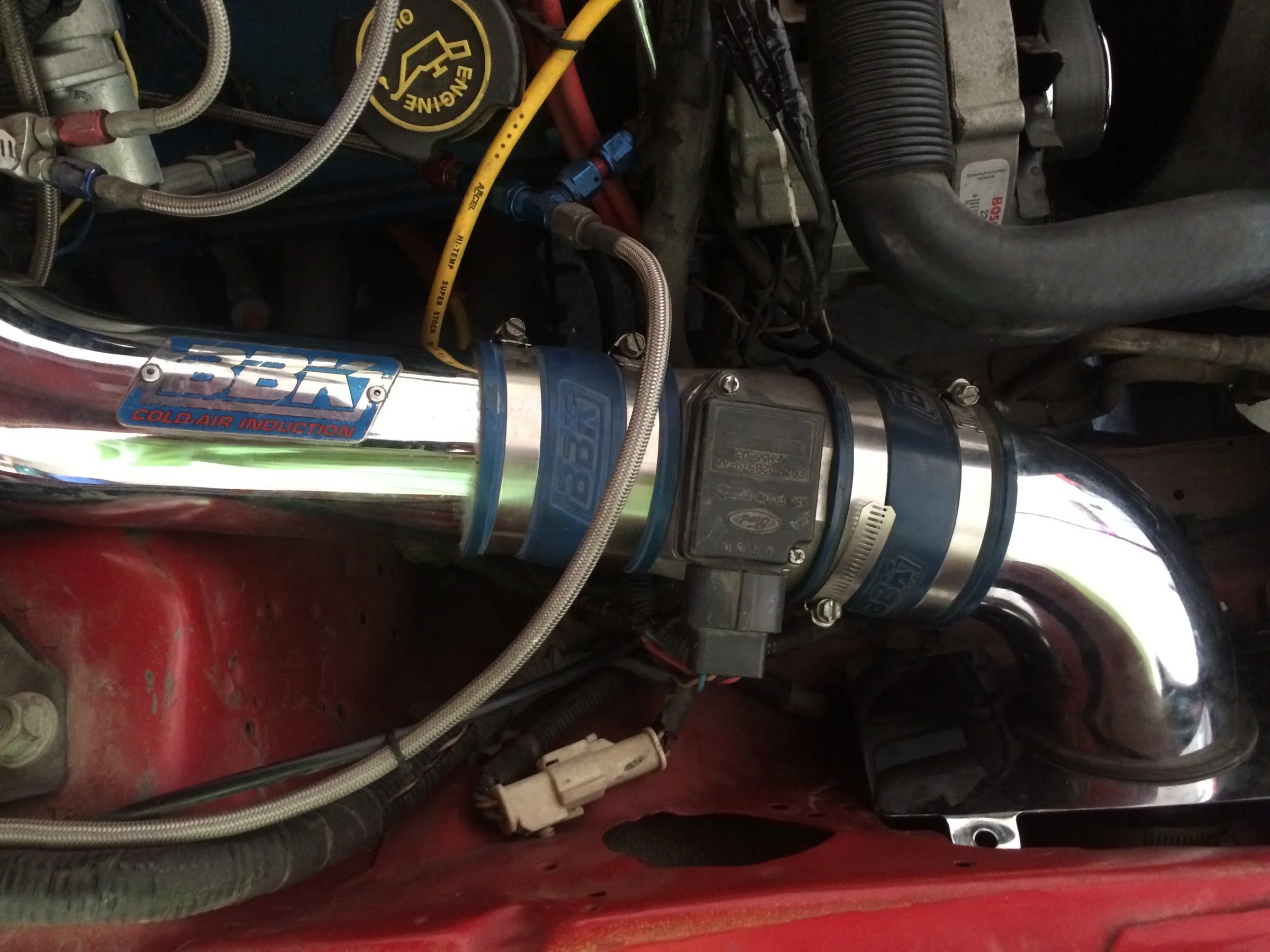

Today I'm going to replace fuel filter. The car has been sitting for a few years. I have new plug wires on the way. Should be here in a day or 2. I've always thought I have had a vacuumn problem. Where to start..lol there a lot of them. So there is a vacuumn line that comes out from the front of the intake, a rather large hose. On the other end of it thete is just a bolt plugging the hose. Should that be hooked up somewhere? I can get pictures after work if need be.

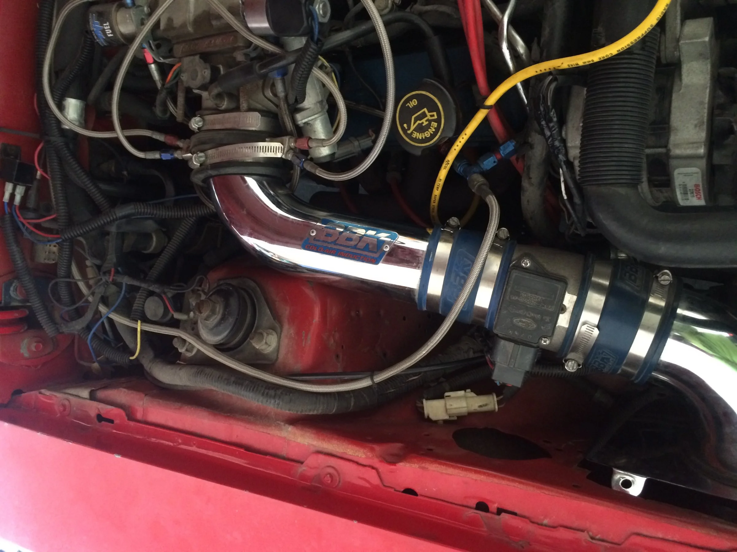

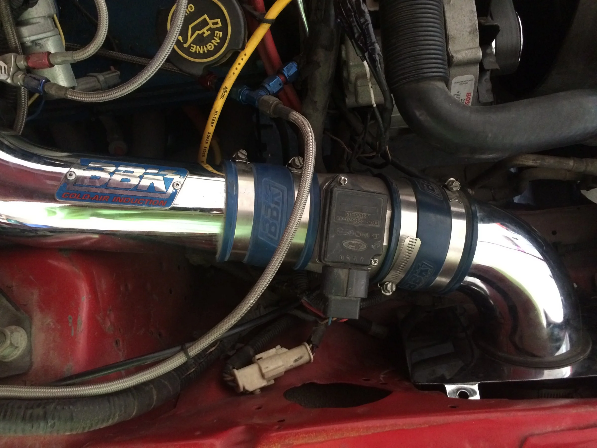

Have you tryed putting the stock maf houseing back on...i think thats the problem...stock sensor on different houseing dont work together...i bought a bbk 76 and she has no probkem getting to 5500
That hose should go to the carbon canister under your air box, or where your air box was, the is a check valve then a hose to the canister, with a wire harness that plugs to your injector harness on the passenger side
Is that there?

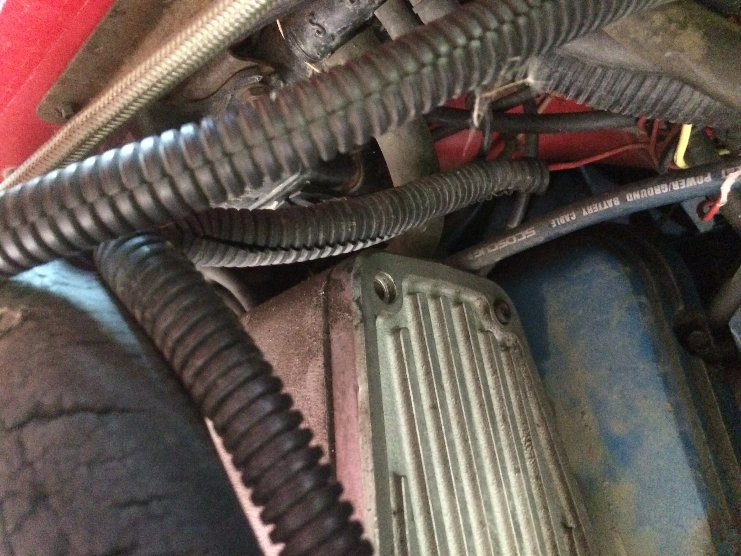

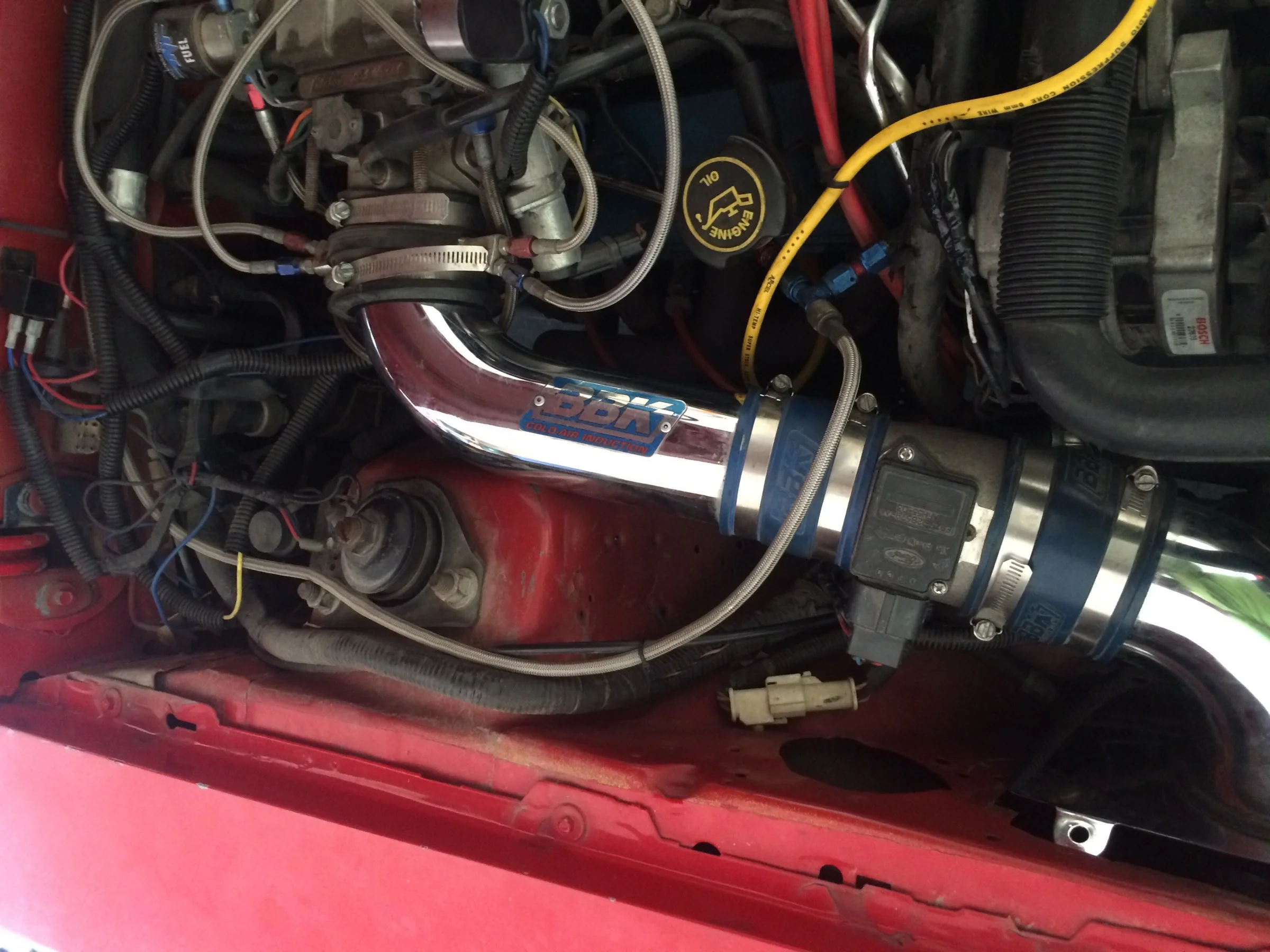

I don't think so. Here are some pictures.

Can't tell, the carbon canister is right front down on the fram rail, let me find some pics, you need a vacuum diagram too.
That hose you have in your hand is coming from the back, canister vacuum comes from the front.

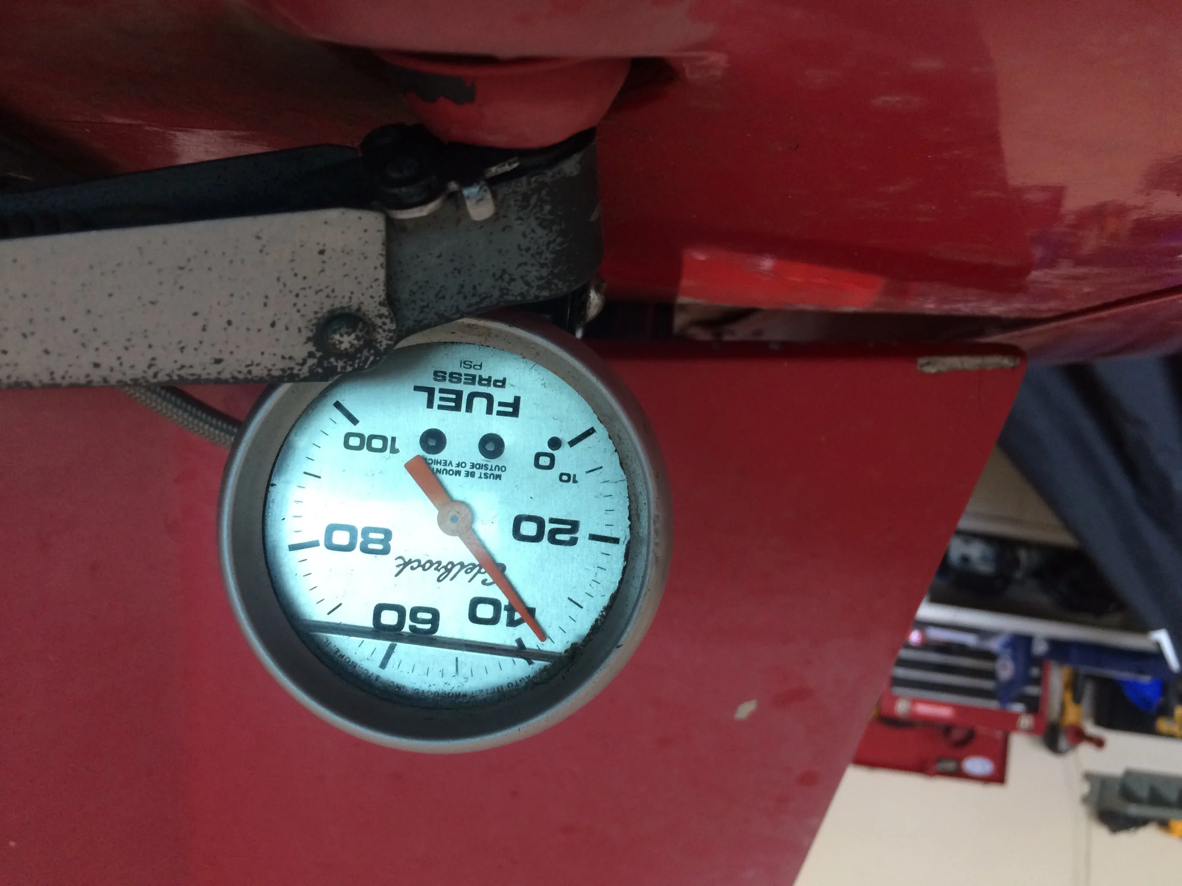

So looking at that diagram. Pretty sure it's the hose that went to the cruise control. So I should be good there. Also, my fuel pressure gauge is stuck on 38lbs. Car running or not. On my way to get a new gauge. Also noticed I'm missing a bolt on my intake. Could this cause anything?

Back to that vacuum line, if it comes from the front of the intake it's for the canister, see if you have the rest, I posted links.
Your cruse control come off the vacuum tree on the firewall.

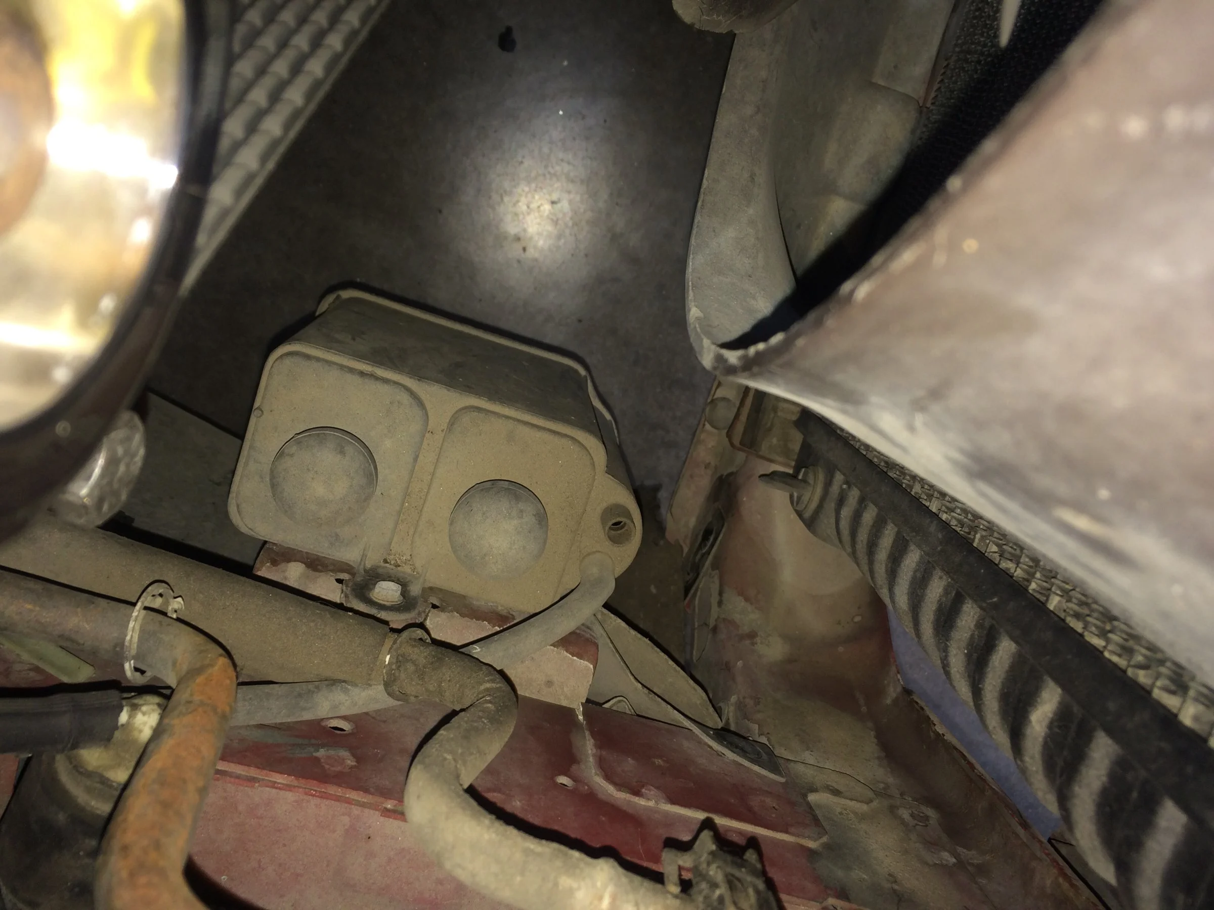

Ya sorry about that. Here is a pic of my canister. The one hose runs into my fender and I don't know where is goes from there. The other port on the canister is open as you can see. Should that be blocked off?
