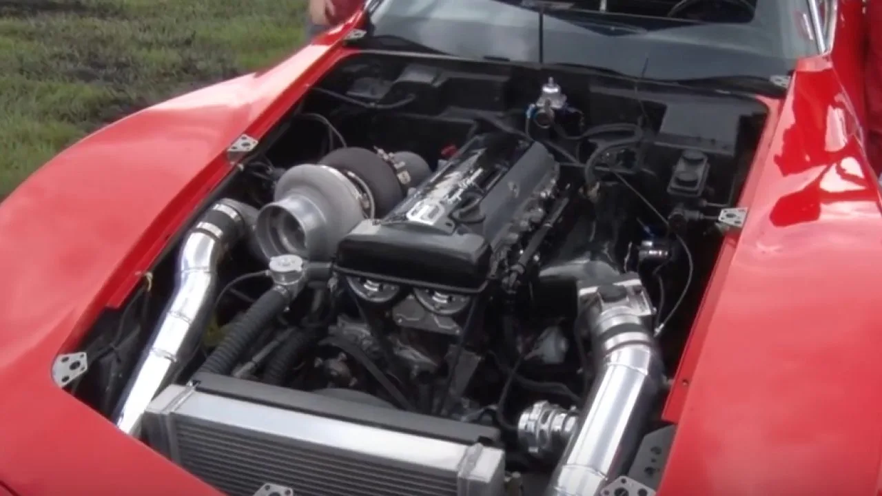

Fox Now this is... an interesting build. (2jz notch)

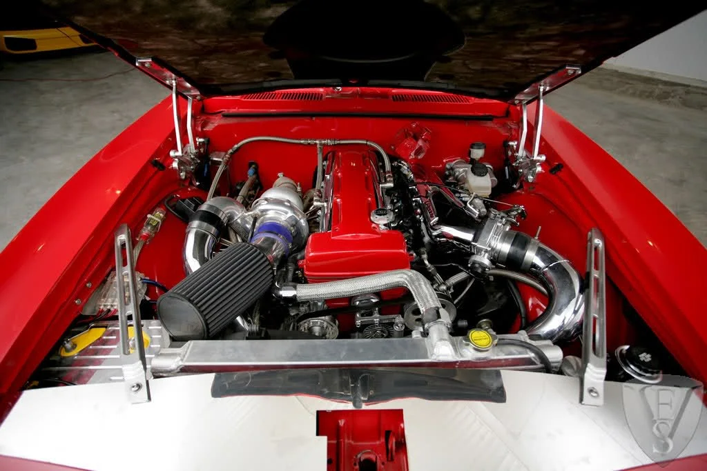

Fair enough...its not swapped into domestics as often as it is other imports, but it IS still swapped into domestics, point in case:
This one is in a 66 mustang.
Vette
This is in a 67 Camaro...I could go on, but you get the point.

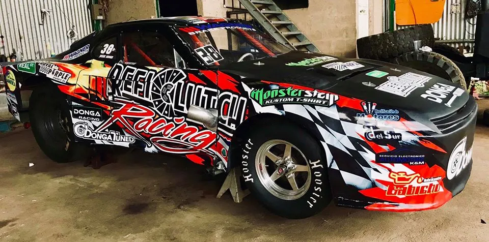

likely not in a poor Country with 5 million People living here ... but you will be surprised how many old Pushrod engines / Cars are driving around here ... and also the 2JZ swapped Cars you will see at the Race Track !! and they are all running 9 seconds and faster ...the fastest 1/4mile car here is also a 1000hp 2jz powered Celica ..running 8.06 at a Track not even full preped... :coff: :coff: :coff: but I now more North everything is bigger,
better and faster ..enjoy
