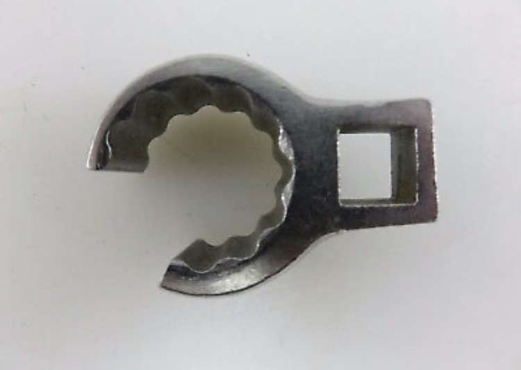

Any hints for removing the O2 sensor on the right (passenger) side? The O2's bolt shoulder is almost touching the transmission case. I don't have an o2 tool, but I do have a nice crowsfoot flare socket that works fine most of the time. Surely you don't have to remove the right side exhaust manifold?

Yes sir. Automatic transmission. The bung on the passenger side is right up close to the transmission bell housing where it flares out. No way you’re getting an open end wrench in there. I really can’t get my crowfoot socket even on the thing.
